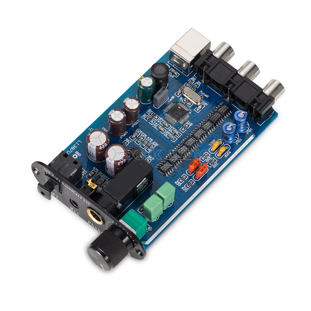

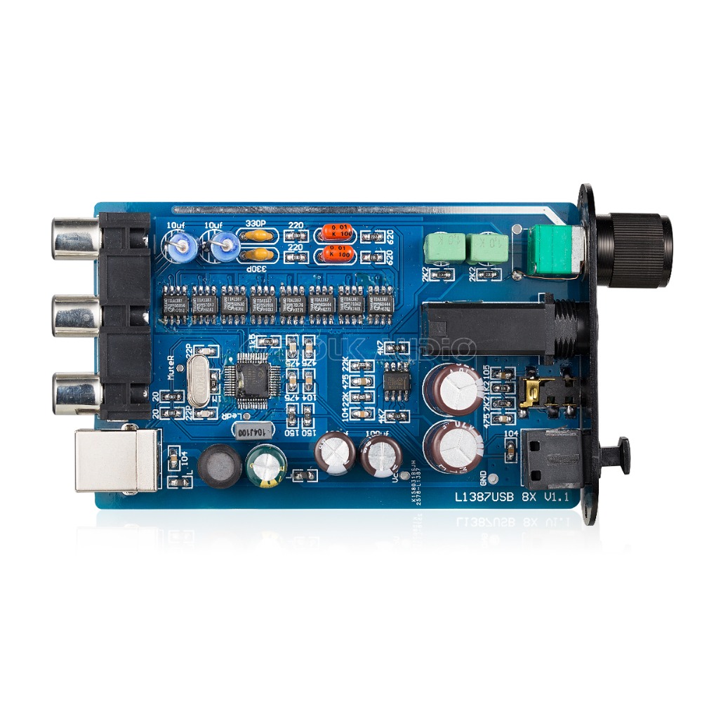

2nd link:The 2nd link is a Lee's Audio designed TDA1387 DAC with great modding potential.
The 3rd link is by the same guy but uses a TDA1305, I haven't gotten good sound out of one of those yet. Some bypass the internal opamps and say it sounds great when so modded, not something I've tried. Steer well clear unless you love 'electronic-y' sound.
Very interesting design vs others with 8 nos of tda1305. I'm not an electronics engineer but that thing is intriguing.

2nd link:
TDA1387 - its the 3rd link with the TDA1305. Definitely an intriguing chip I agree.

Does the dac in the second link have the psu controller ?If USB power is used directly then I would agree its a major limitation on the subjective performance of a DAC/amp. But some DACs will have internal boost converters to step up the 5V bus power to something higher - no reason those shouldn't perform well. Look on the PCB to see if there's a PSU controller chip next to an inductor.
No, that one's using USB power directly. So you'd be better off adding an external 5V PSU rather than using the USB bus power.
So, can I supply 5v to it externally ?
Would you please help me do that ?
Also, does that board has voltage regulators too ?
I think what you can do is use a USB hub which accepts an external 5V PSU. That's what people do when connecting up USB stuff to mobile phones and iPads where the USB drivers won't allow much current draw.
I'm not seeing any voltage regs on that DAC - the CM108 USB interface works directly off 5V as do the TDA1387s.
