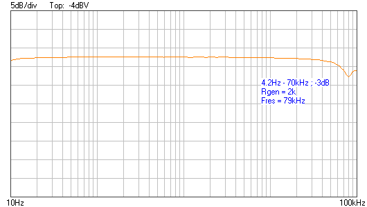

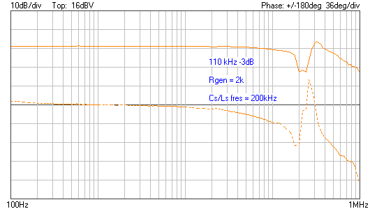

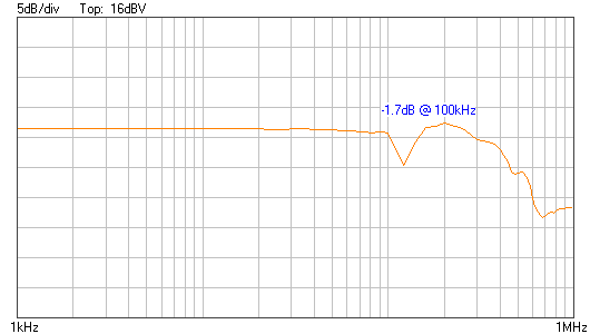

Hi Folks,
Two months since, I'm a happy owner of the Velleman PCSU200! Extremely happy with this small toy! The graphic interface is quite intuitive and quick to learn.
There are "output normalization" by input and averaging options, which are quite helpful. There's also quite enough of steps for measurement resolution, more than 30 per decade.
Bode plotting range can be done from a maximum range of 10Hz to 100kHz, or 1kHz to 1MHz for thourough HF testing.
Here are some bode plots of random transformers!
