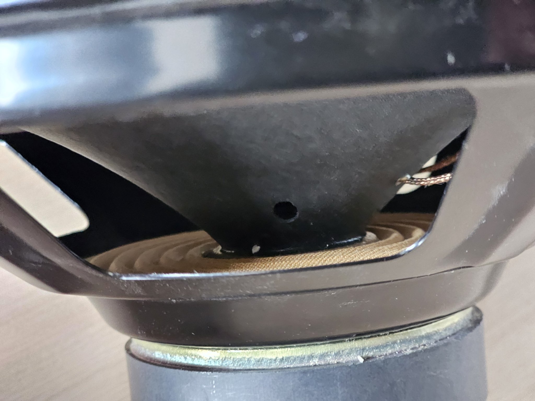

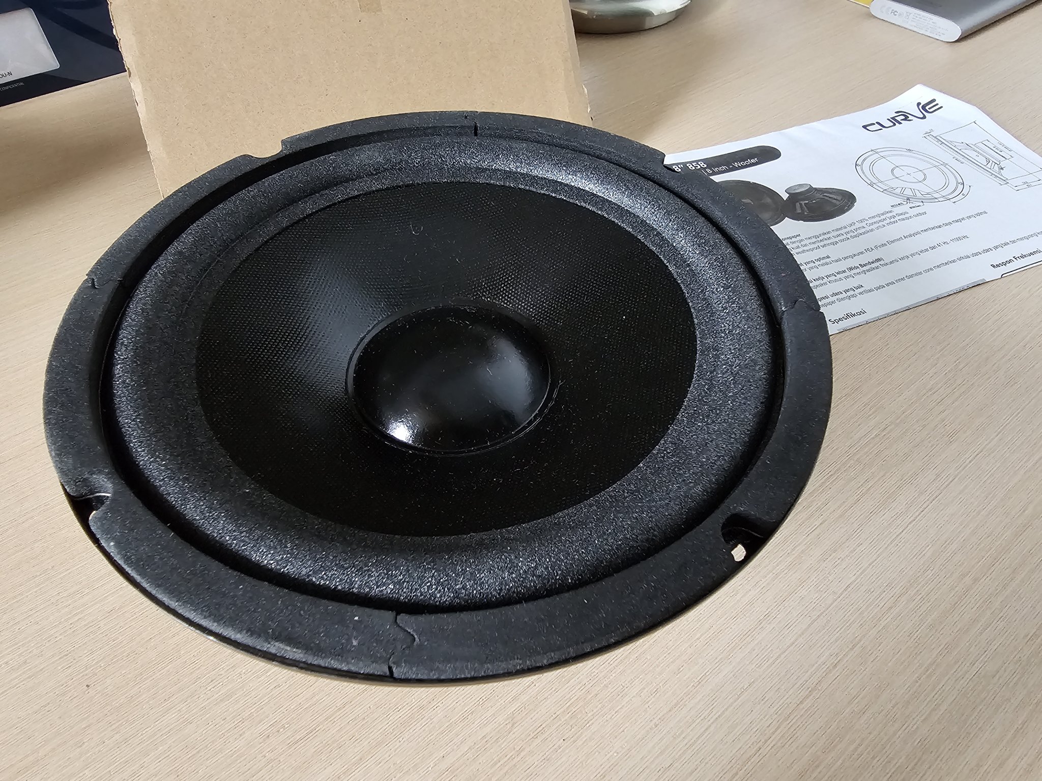

This would be a good choice Perceval. Bought 16 pcs to test. Prelim test on 1 woofer, sound very clear which is good news for me.
Brand is ACR big name in Indo for Pro Audio. Dirt cheap & incase your wondering they are the manufacturer behind SB Acoustics.
Hopefully you guys can find a source of supply at your end to test.

Looked at that one but the plastic turned me off...

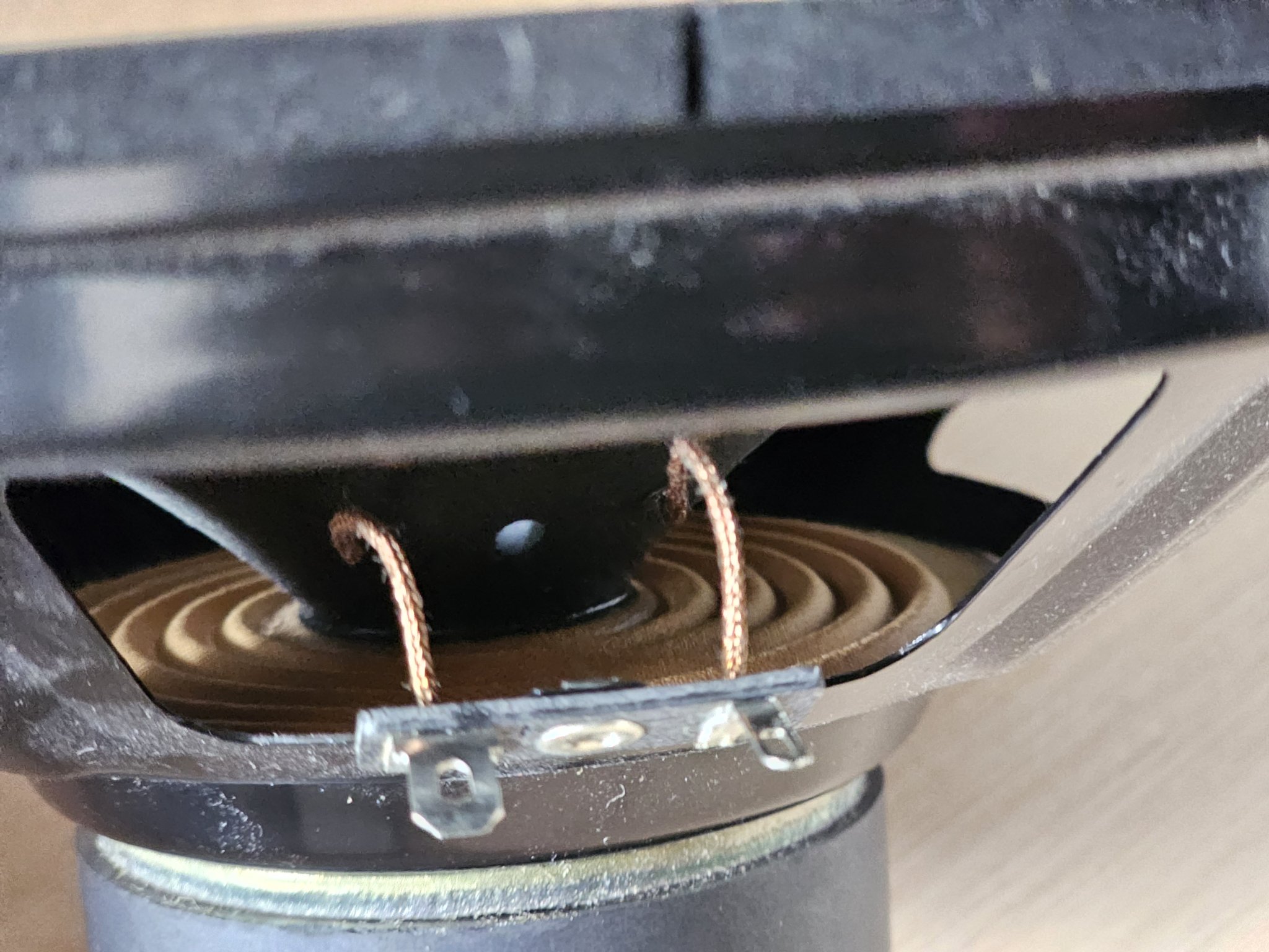

You asking about the ACR woofers ? They look like foam but feels rubbery unlike foam surrounds. From info woofer cone is waterpoof so I assumeNice drivers. Are those foam or cloth surrounds?
that the surrounds could be a hybrid foam rubber type, that is if there's such a material. lol Anyway thery're so so cheap buying more to keep as spare
won't even hurt the pocket, $9 a pc including shipping to me
As X said, it's not cheap plastic stuff. It feels nice and sturdy. Indeed, less resonance than the cheap stamped steel woofers. One could always add butyl rubber to the stamped steel ones to kill those resonances.Looked at that one but the plastic turned me off...

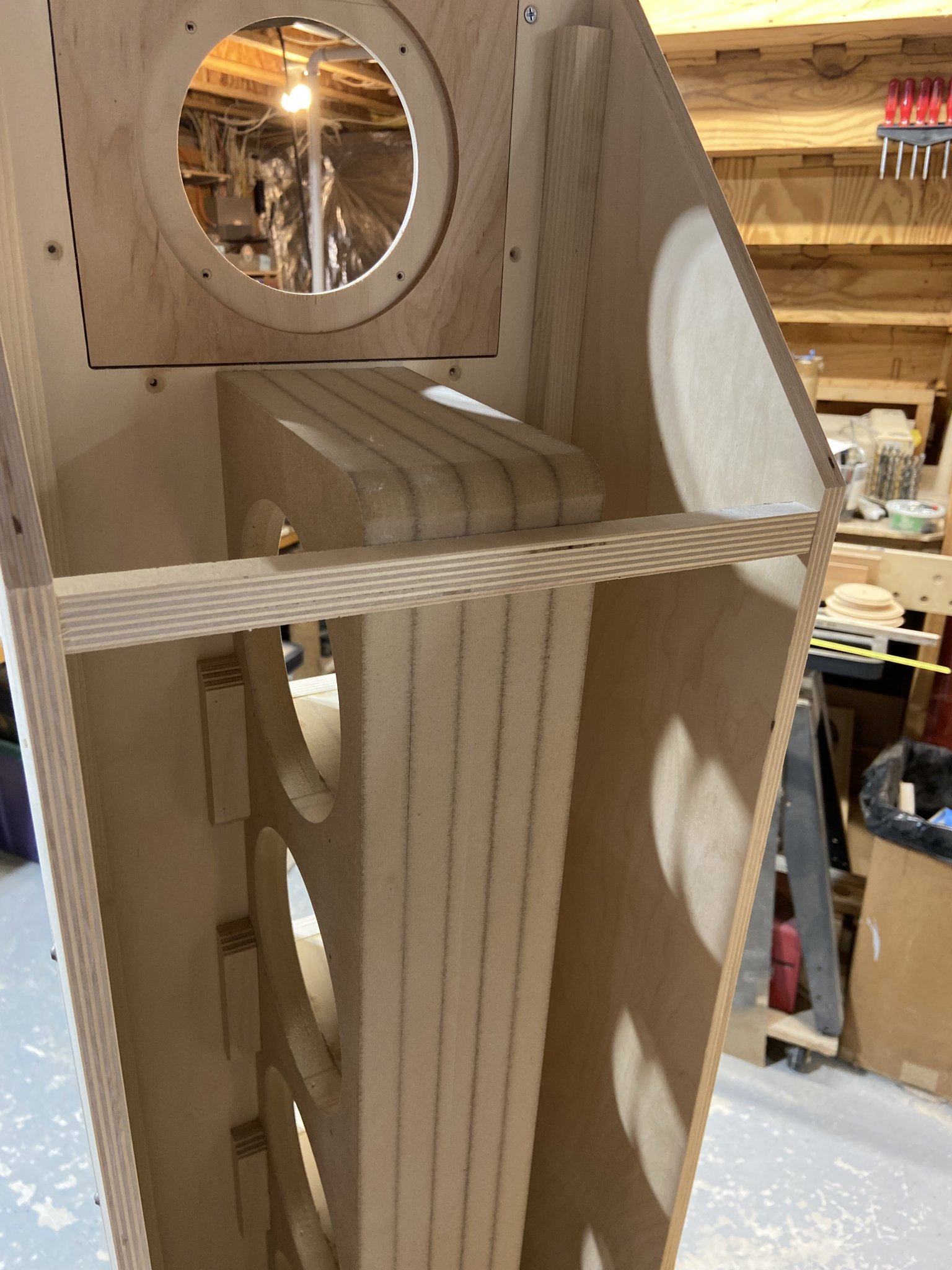

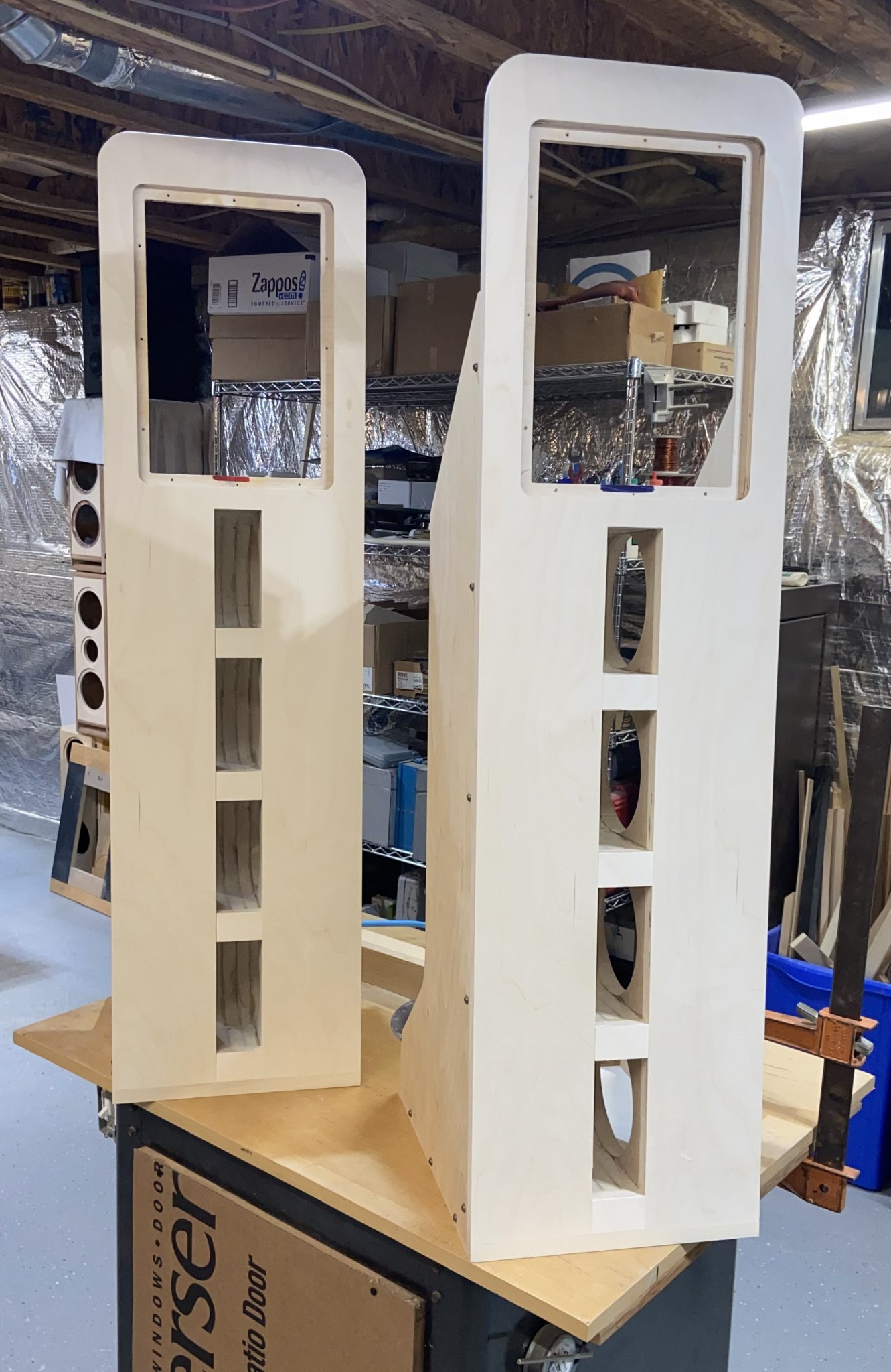

What driver characteristics are you using to select drivers for slot loading?This has always been one of my favorite prototypes built in cardboard or foamcore. It was so good I made a note to myself to revisit it one day in wood. It was one of those designs that has such a clear midrange thanks to being an open baffle and deep bass that had some punch when you are nearby but doesn’t compress the room. I have recently been working with a local cabinet maker to help me realize the the next generation in wood. I’m increasing the woofers to 8x 6.5in per speaker, and making it a 3 way with a high sensitivity midbass (5FE100 or 6FE100) and a planar dipole tweeter (GRS) with a waveguide. The woofers are basic polycone or papercone low cost units for now. Fancy ones are not needed as I recall how good they sounded with $5 blowout woofers.
The construction will use mostly 3/4in BB ply for the baffle and 1/2in BB ply for the U-wings and stacked 3/4in MDF for the woofer manifold chamber. The 2-way part will be on a separate board that is interchangeable so that I can test out various different drivers on top easily. I plan to develop a passive crossover.
Construction is almost completed and I should have the speaker in hand in a few days. Right now it is still at the workshop. It’s looking very nice thanks to the superb skills of my cabinet maker, Doug. A big hats off to you Doug!

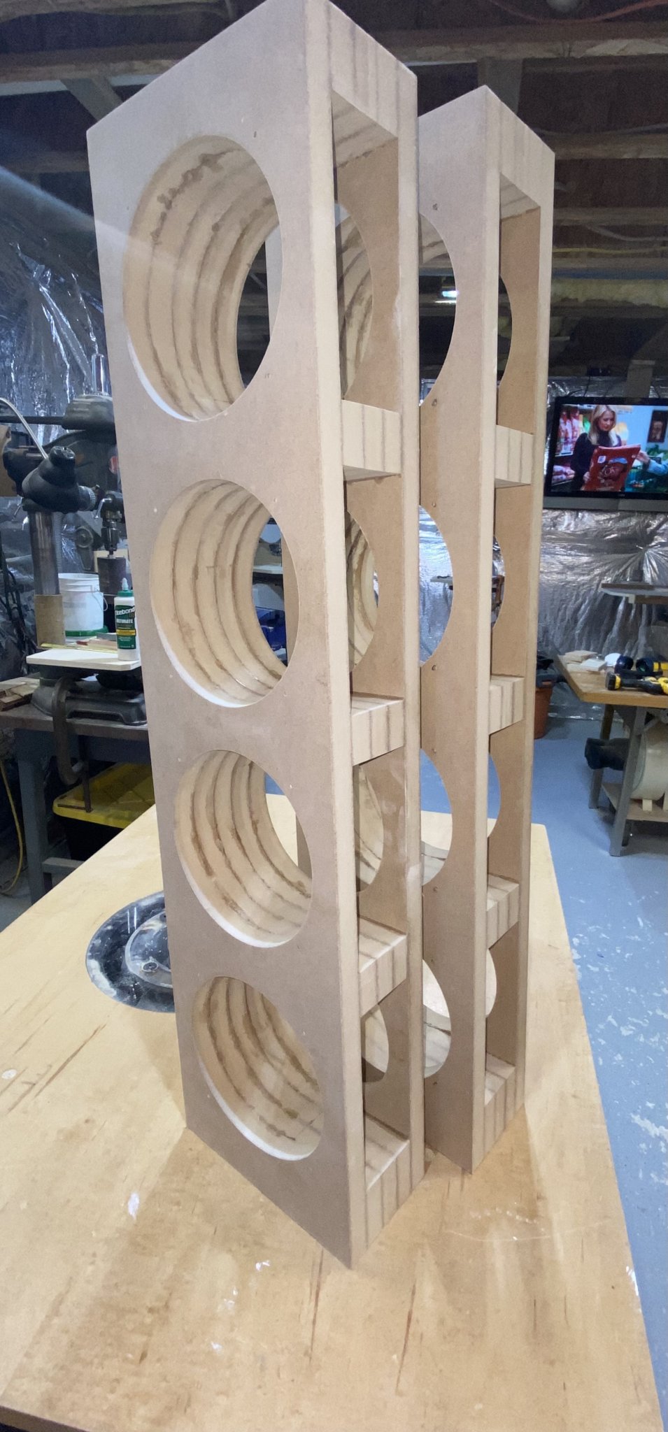

Woofer manifold made from stacked MDF:

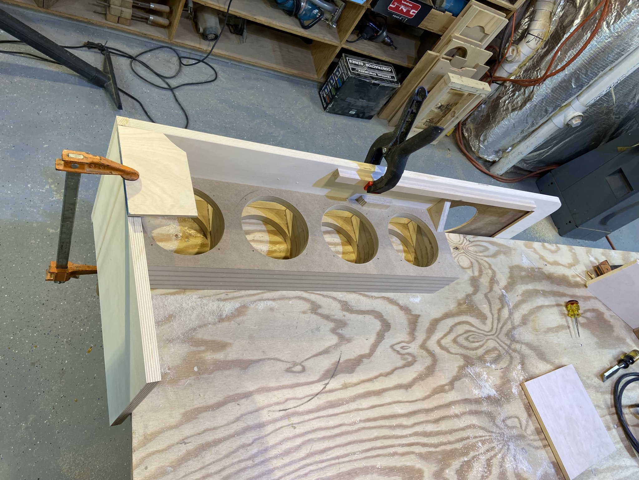

Manifolds glued to baffle:

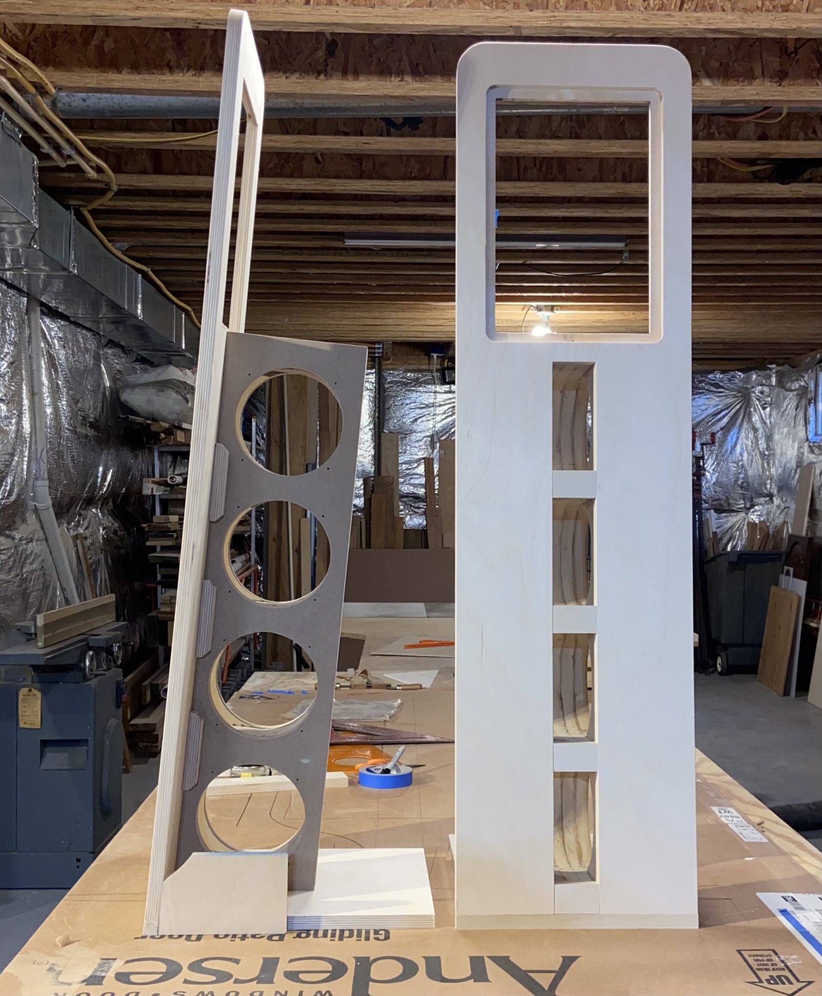

Preparing to install the wings:View attachment 1035595

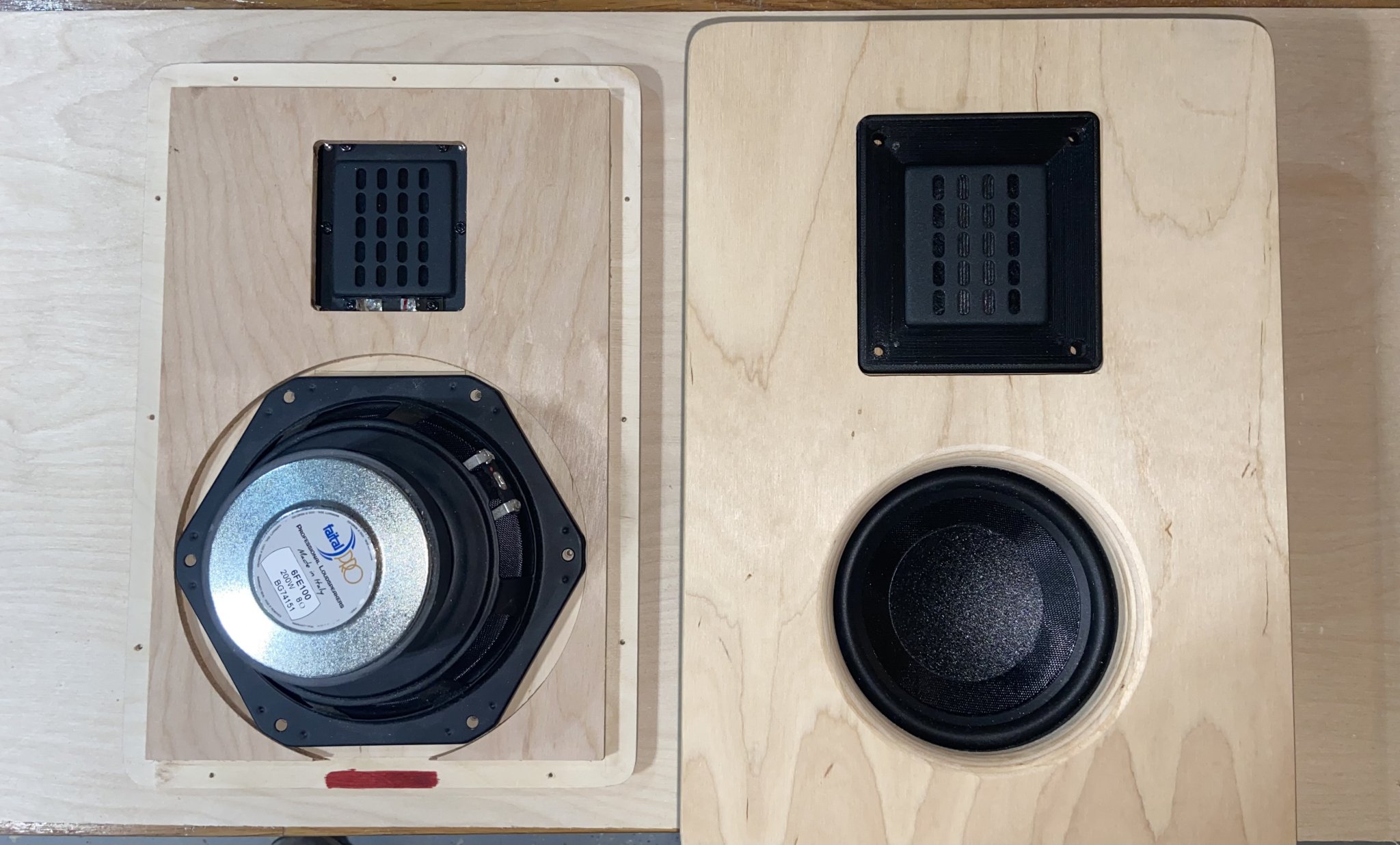

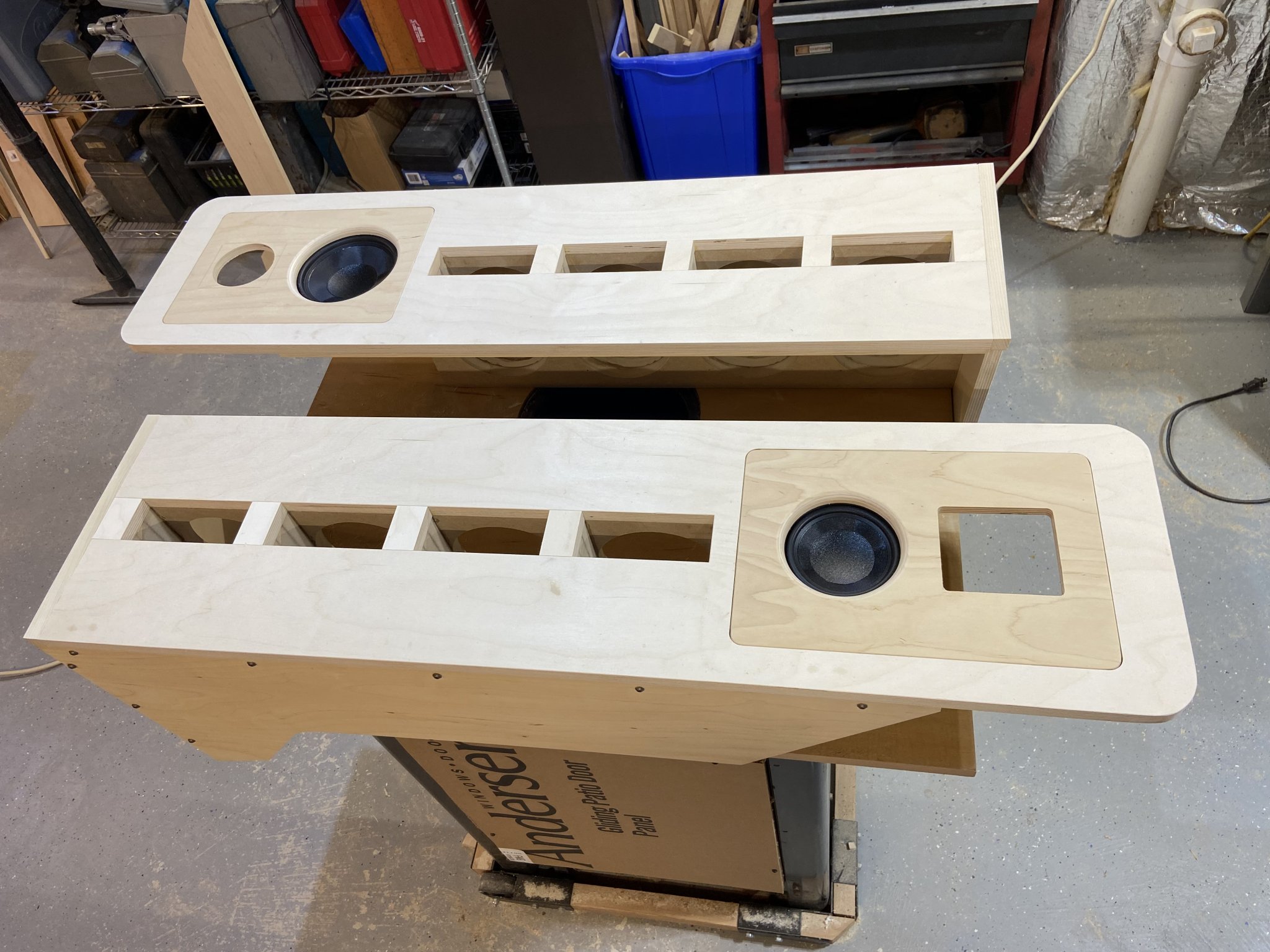

Baffles with cutouts for replaceable 2-way top driver plates:

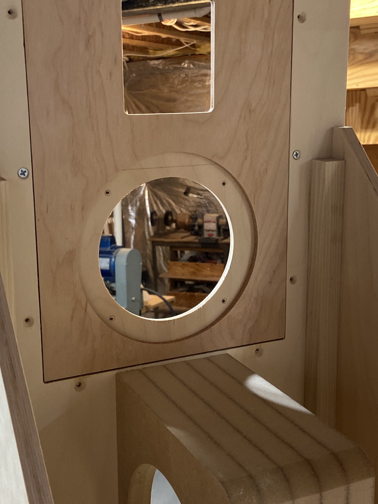

Detail of how baffle plates are held in place from the back:
Woofers are rear mounted and tweeter waveguide is front mounted. Woofer bezels are rather industrial “pro audio” so look better rear mounted. Also, the non-circular bezels would have made front flush mount rebates a real pain. A round over on the front lip is used to provide a smoother look and reduce diffraction to the extent possible:
Will probably use some bracing on the wings:
