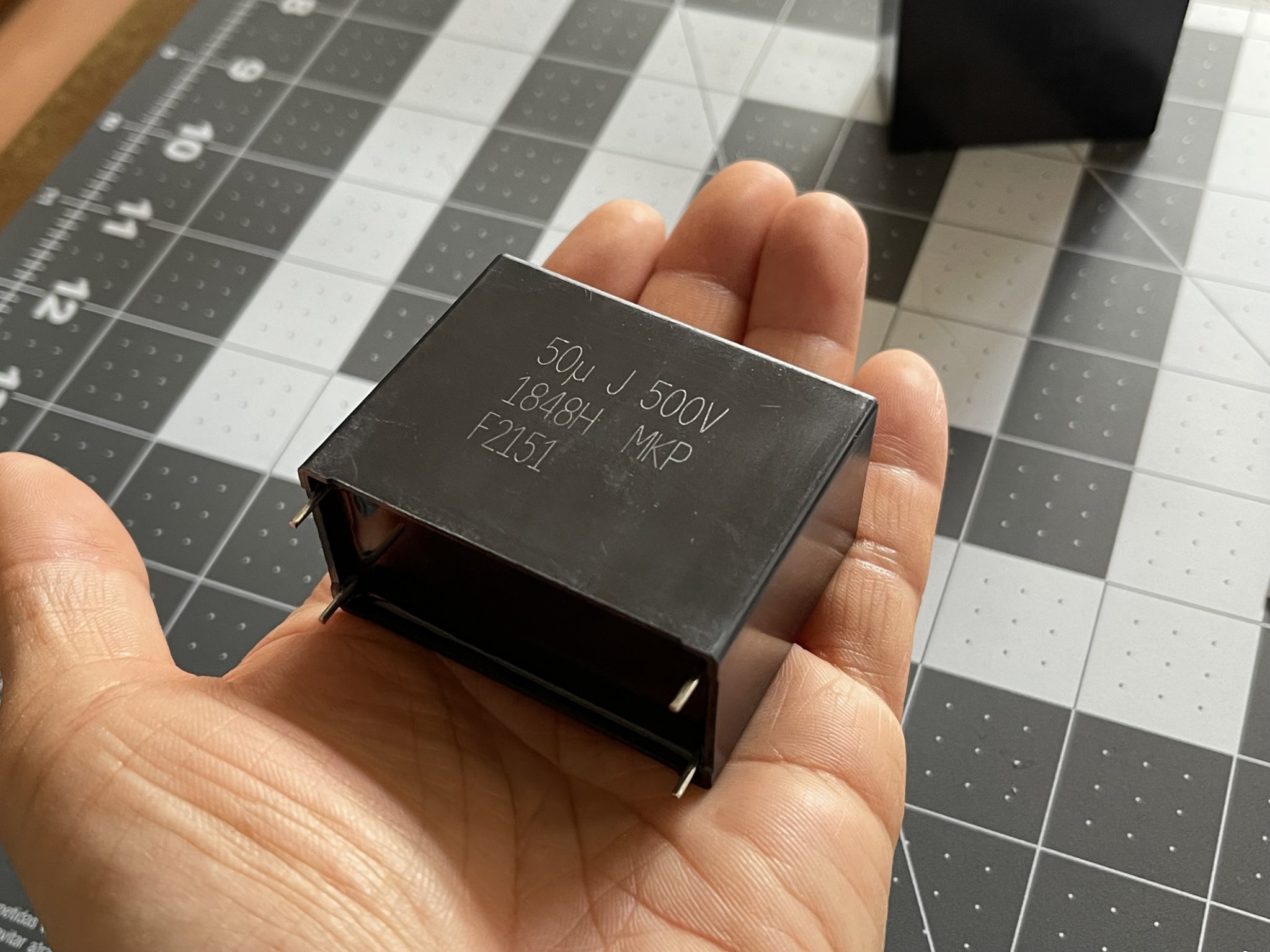

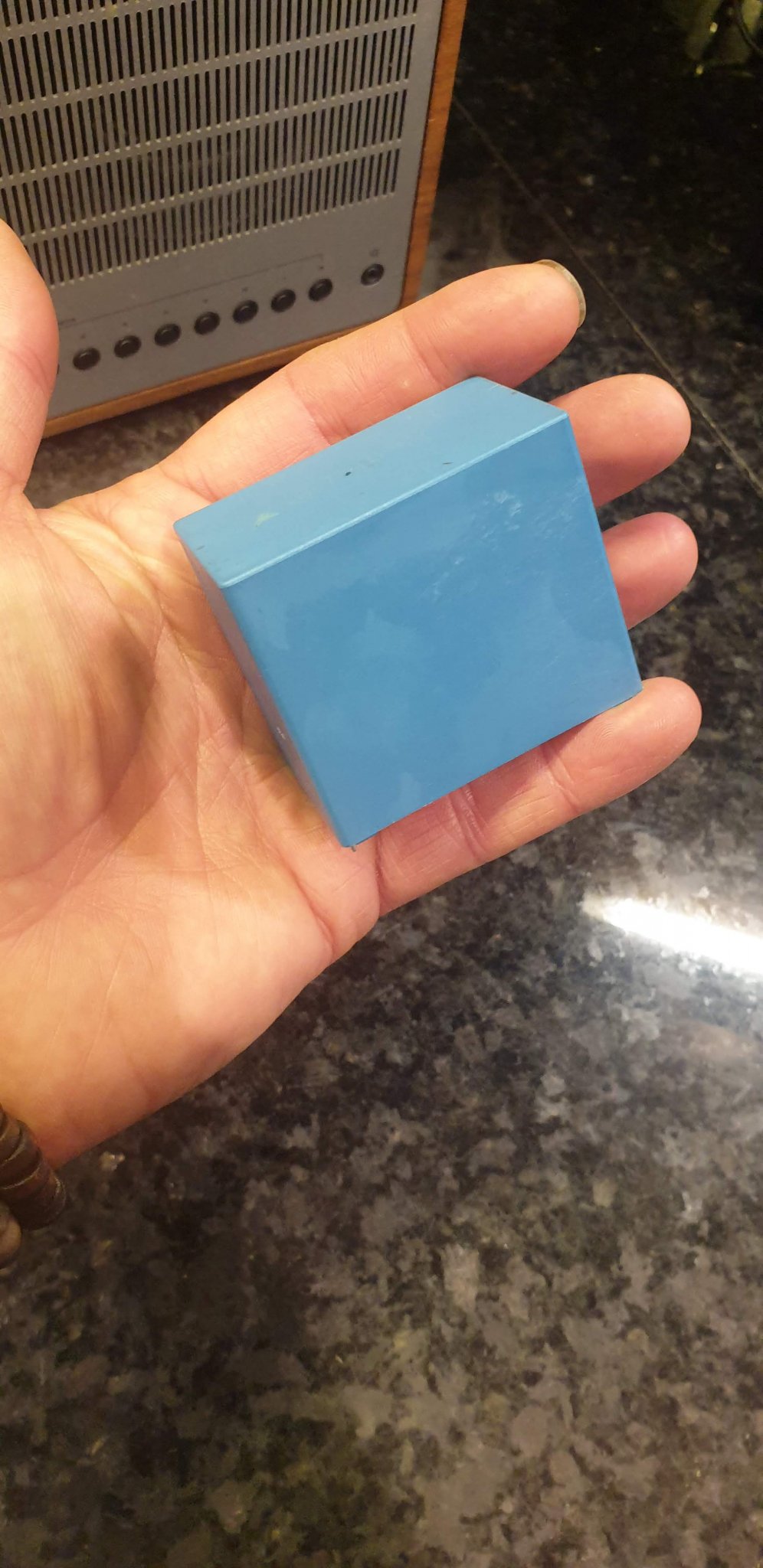

That’s a Vishay MKP box cap. Typically used as switching PSU output filter cap for low ESR. This one is 50uF and 500v rated. It’s the mother of all box caps.

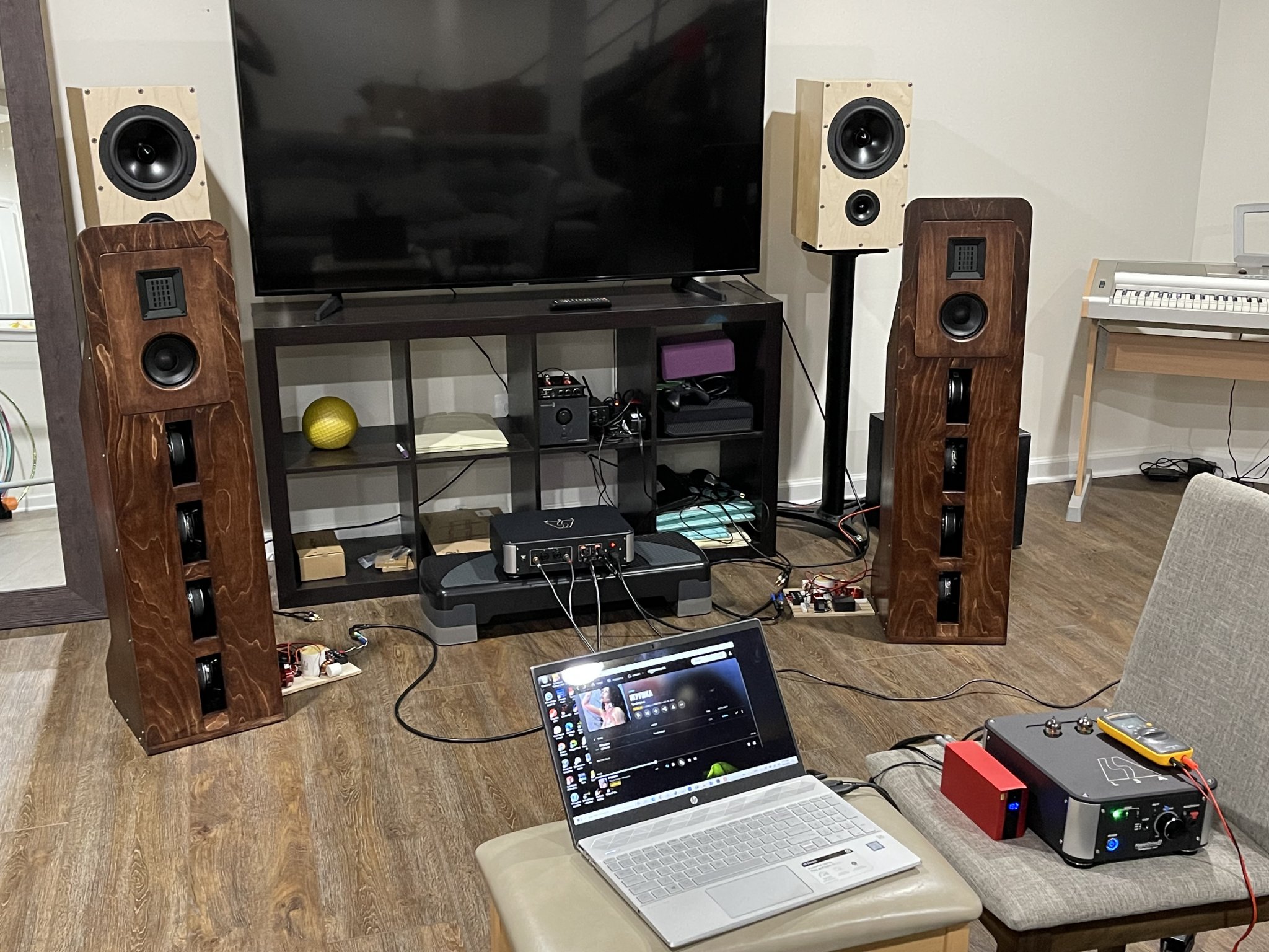

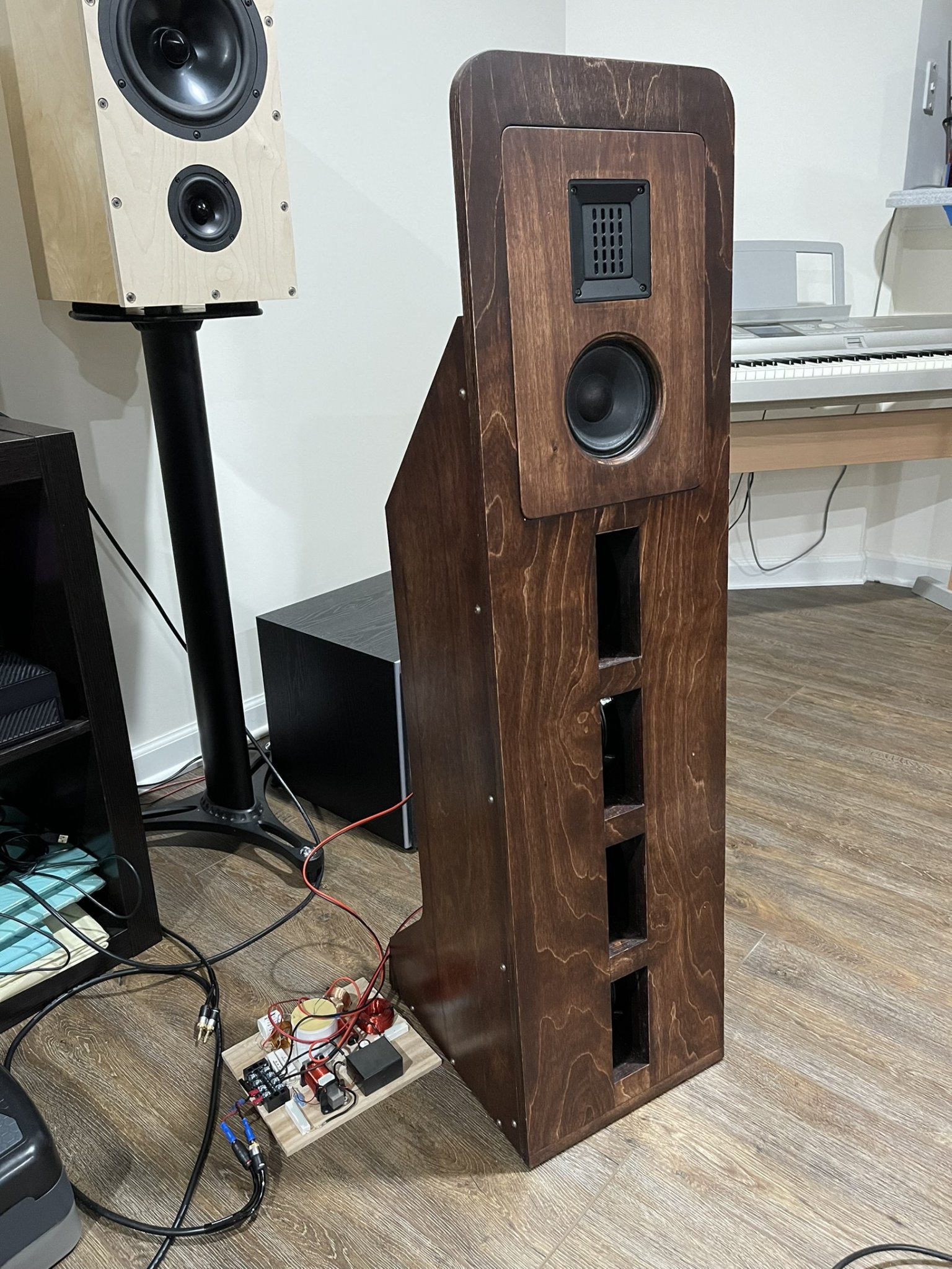

I set up the speakers in a larger different room to test the sound. It still sounds great. Amazing bass. No subwoofer needed.
This is setup outside in the exercise room/dance studio area.
I’m using a SMSL Sanskrit 10 DAC, LSA HyperDrive-2 preamp, LSA Warp-1 power amp, 12 gauge speaker cables, and the new crossovers. Source is Amazon HD music streaming. Mostly UHD tracks. The sound is amazing.

On Mouser, there are two versions, one at $9, the other at $24... which one is it? Thanks!That’s a Vishay MKP box cap. Typically used as switching PSU output filter cap for low ESR. This one is 50uF and 500v rated. It’s the mother of all box caps.

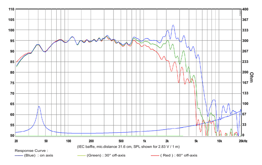

Is that driver designed for covering the upper midrange?.... SBA BIANCO-12OB150-01 for the midrange ....
The IEC baffle cant be blamed:
12in is too big for a SLOB imo. Chamber depth would only allow upper bandwidth of 150Hz.A bit bigger but what do you think of the SBA
BIANCO-12OB150-01
for the midrange? It goes pretty low so would help if you wanted to use bigger diameter woofers.
As a mid it doesn’t go high enough.
You are going to have to restock your on hand spare parts bin and get a color-matched coil. =)$9 one. 🙂

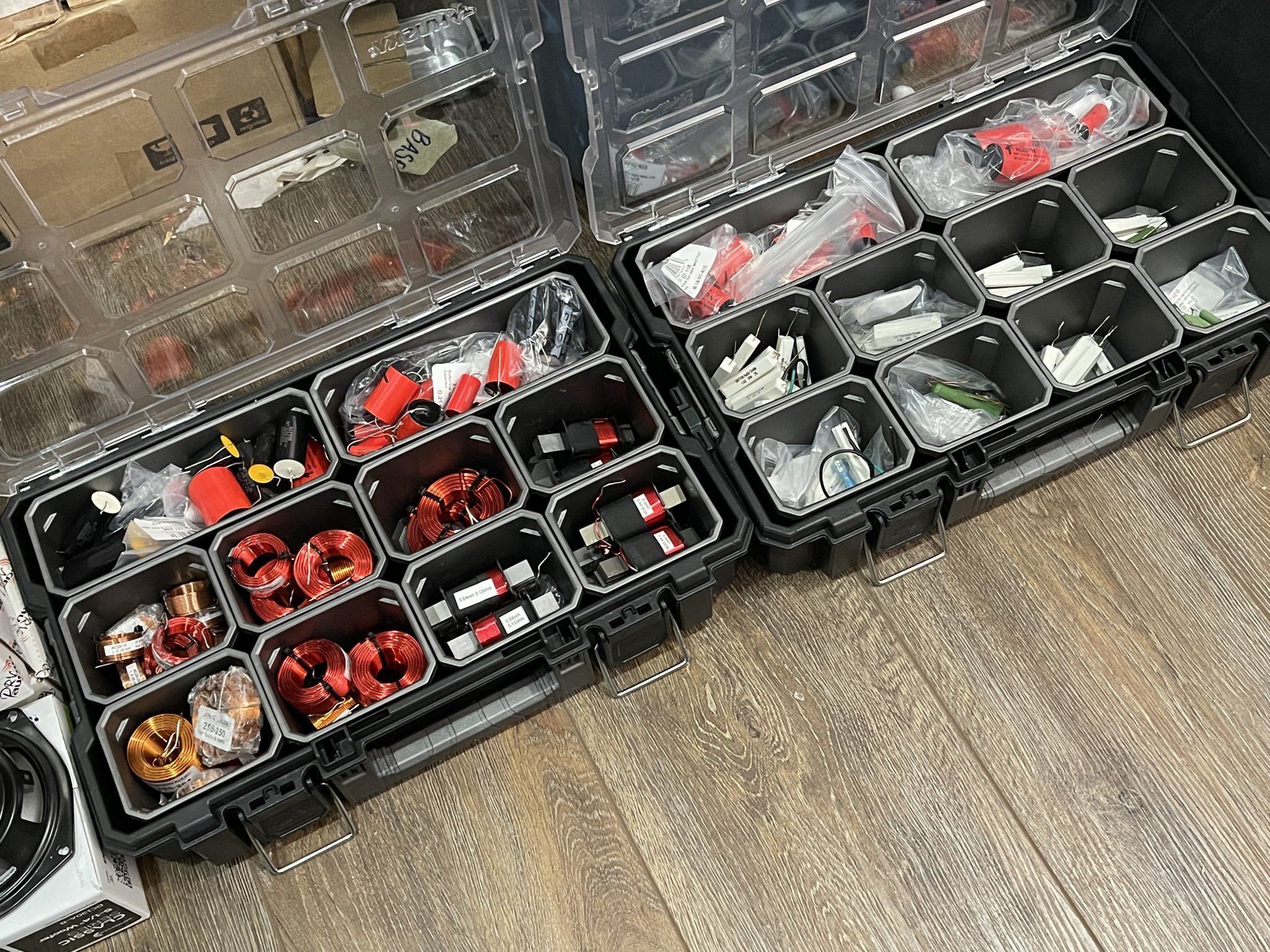

My in house stock is my “XO Development Kit” contains almost every typical value of resistor, cap, and inductor needed to make 95% of any crossover I can dream up. I spent about $220 and got most of it to start out and added on over the last couple of years.

It’s nice because I can build in about 15 minutes, any crossover I need so that I can listen to it right away to verify the circuit and fine tune the voicing. I’ll then order replacements and add a few values that might have been missing. I was short a 0.5mH 18ga air core this time. But had 20ga on hand.
Here is the Kit - two Plano boxes worth.

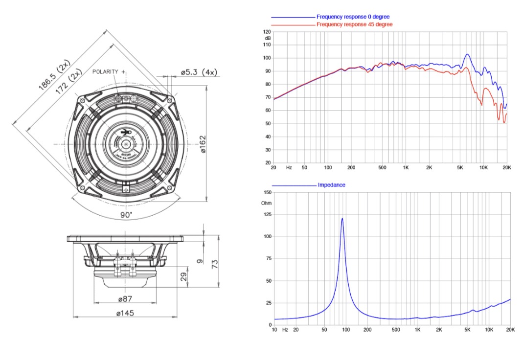

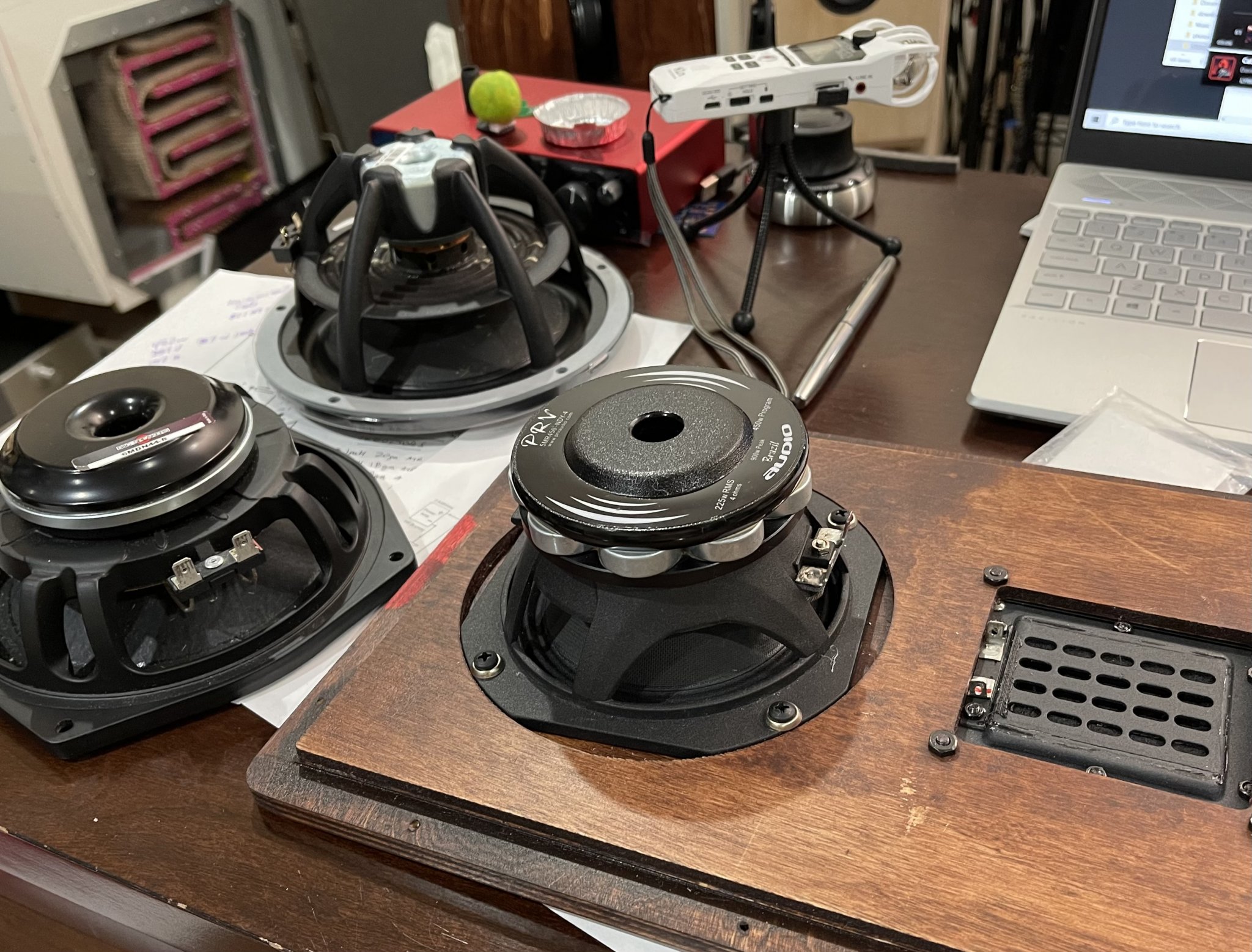

X, notwithstanding the excellent performance you seem to be getting, have you had any musings about upping the quality of the woofer and mid drivers, and if so which drivers have you identified?
I would recommend the PRV 5MR450NDY as the mid driver. What you need is a good low distortion high SPL wide band midrange. The 6FE100 is a good choice for a budget build but the stamped frame and lower tech motor has some distortion artifacts at 1kHz. It’s in the -45dB range but that’s too much for me.
I have tried the B&C 6MDN44 as the mid and it had a bit more distortion than I would have liked which was surprising. It has a basket and motor shape very similar the the next driver - and I have not tried it yet, might be the Faital Pro 6PR160, a cast frame neodymium motor midrange. The spec sheet shows a very smooth flat bandwidth. The distortion is unknown until tested though. It might need a notch at 6kHz though. Whereas the PRV doesn’t have a breakup until 8kHz.

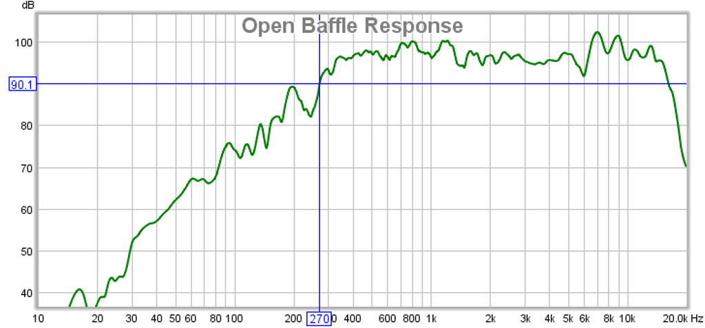

Here was my open baffle measurement of the 5MR450NDY from years ago:
Here is factory response of 6PR160:

Thanks, Adason. Yes, when I hardwire solder the XO, the fat lady has sung. 🙂Nice work X! Looks like the design is pretty much finished.

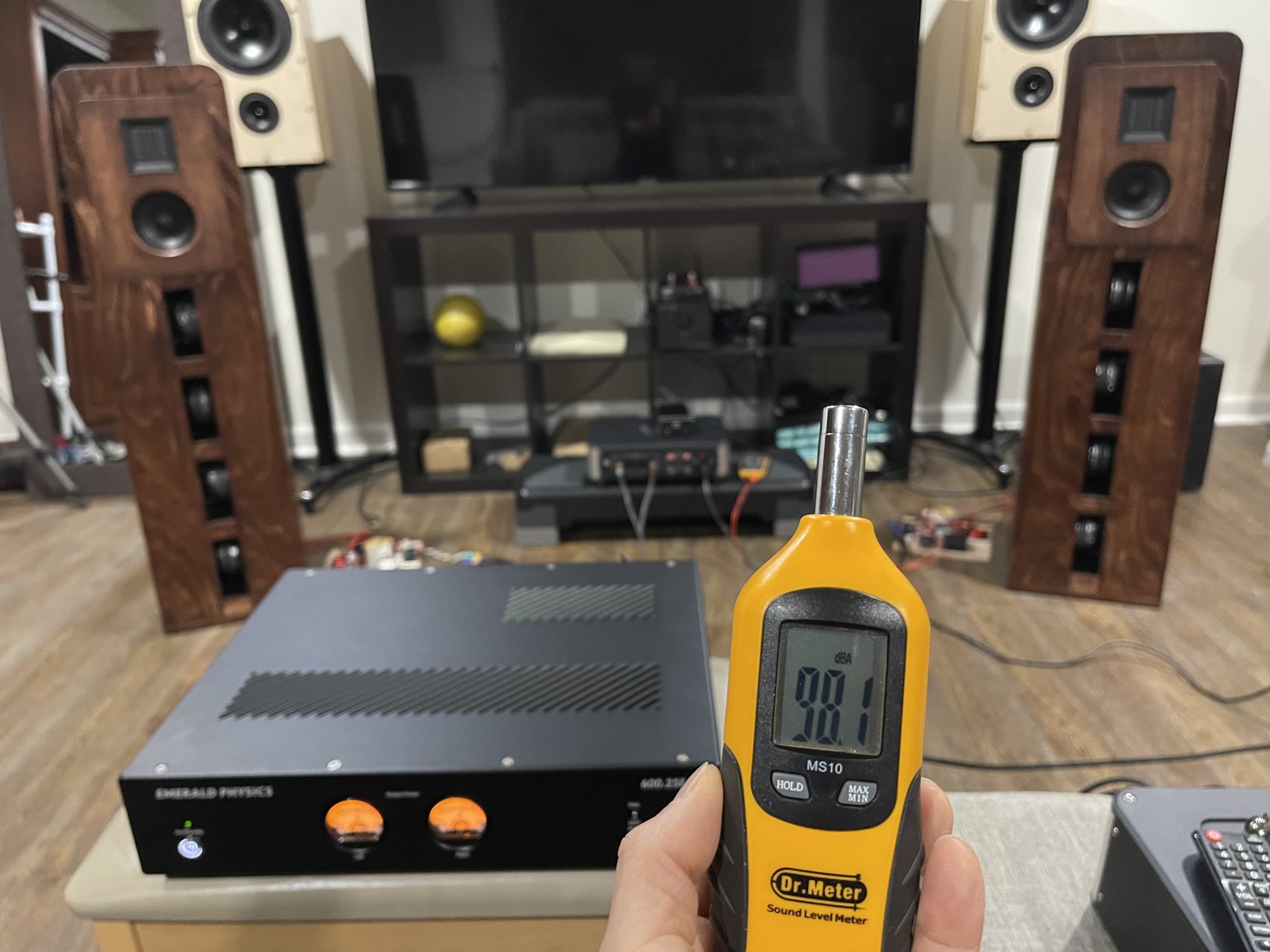

With the EP600 amp with hybrid tube buffer and IcePower 1200AS2 module core, I am only playing 6vrms but the dynamics are insane. Getting 98dB at listening position and fully clean sound.
