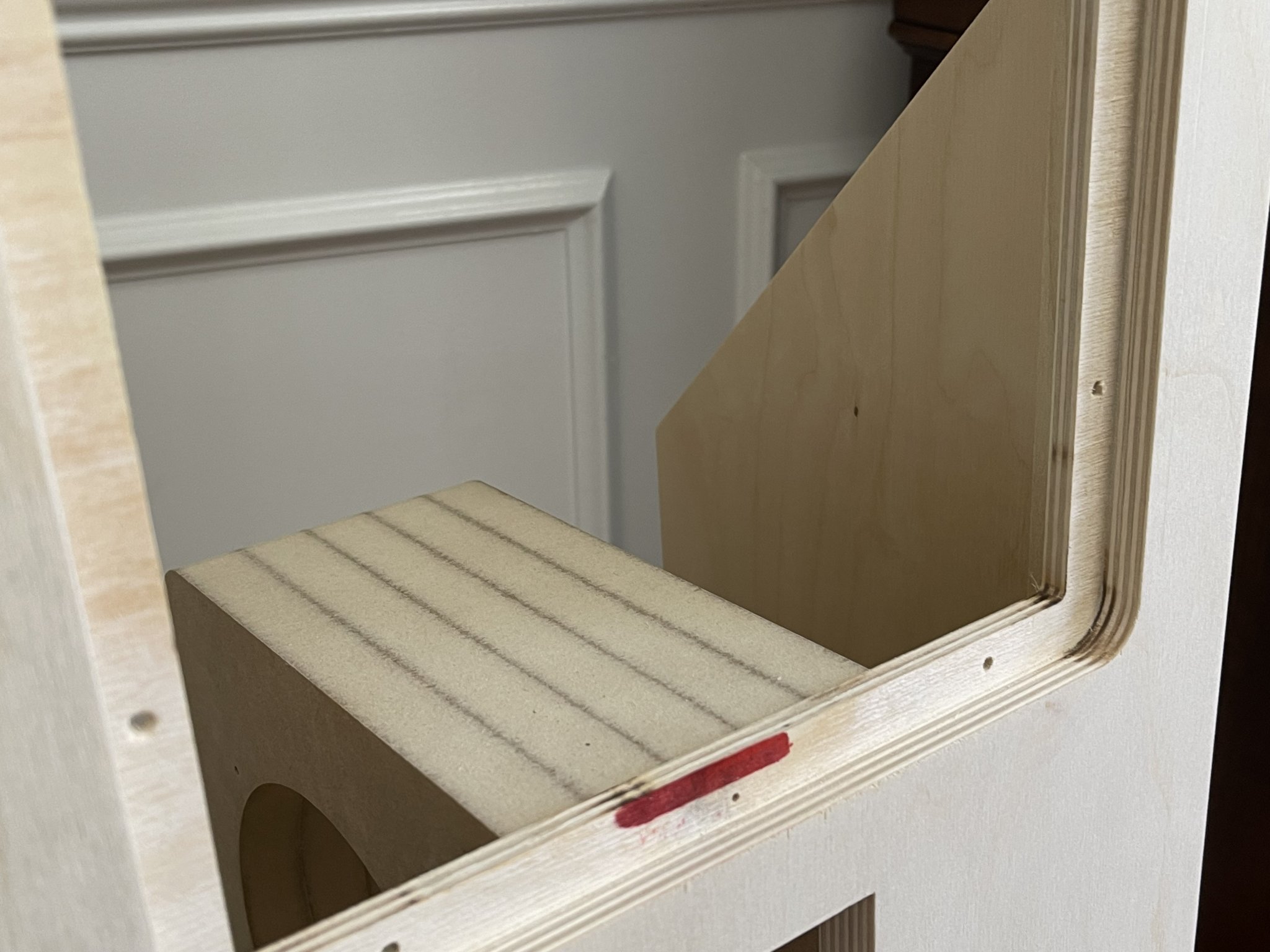

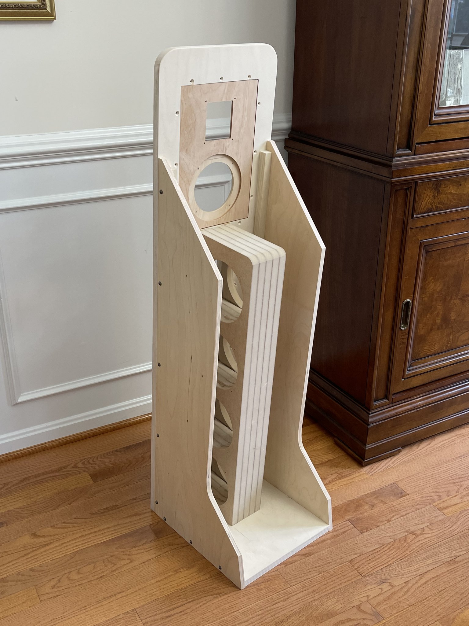

The construction will use mostly 3/4in BB ply for the baffle and 1/2in BB ply for the U-wings and stacked 3/4in MDF for the woofer manifold chamber. The 2-way part will be on a separate board that is interchangeable so that I can test out various different drivers on top easily. I plan to develop a passive crossover.

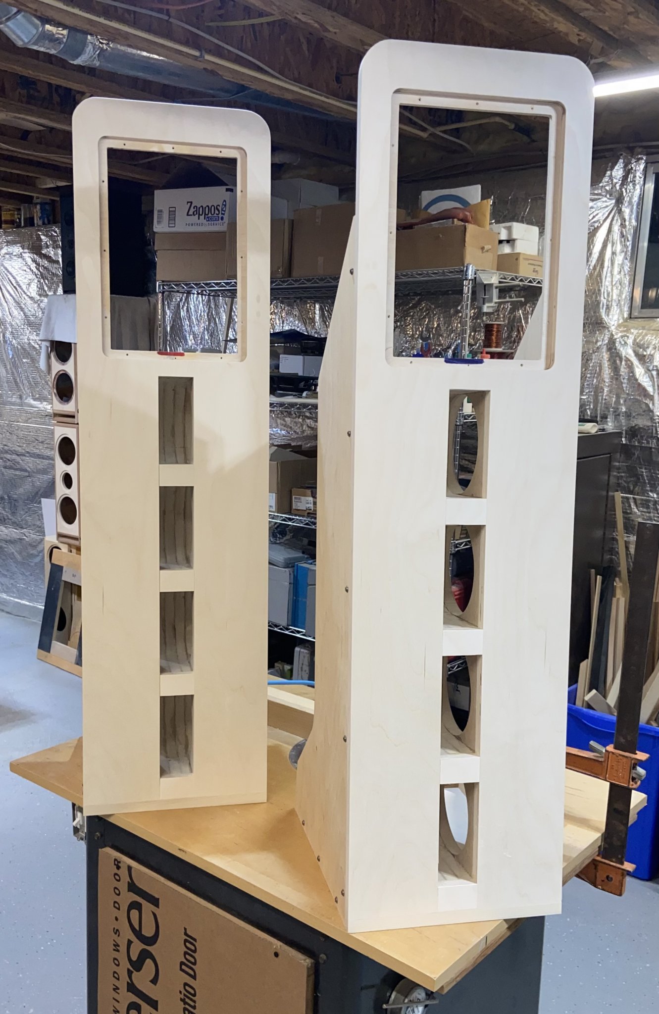

Construction is almost completed and I should have the speaker in hand in a few days. Right now it is still at the workshop. It’s looking very nice thanks to the superb skills of my cabinet maker, Doug. A big hats off to you Doug!

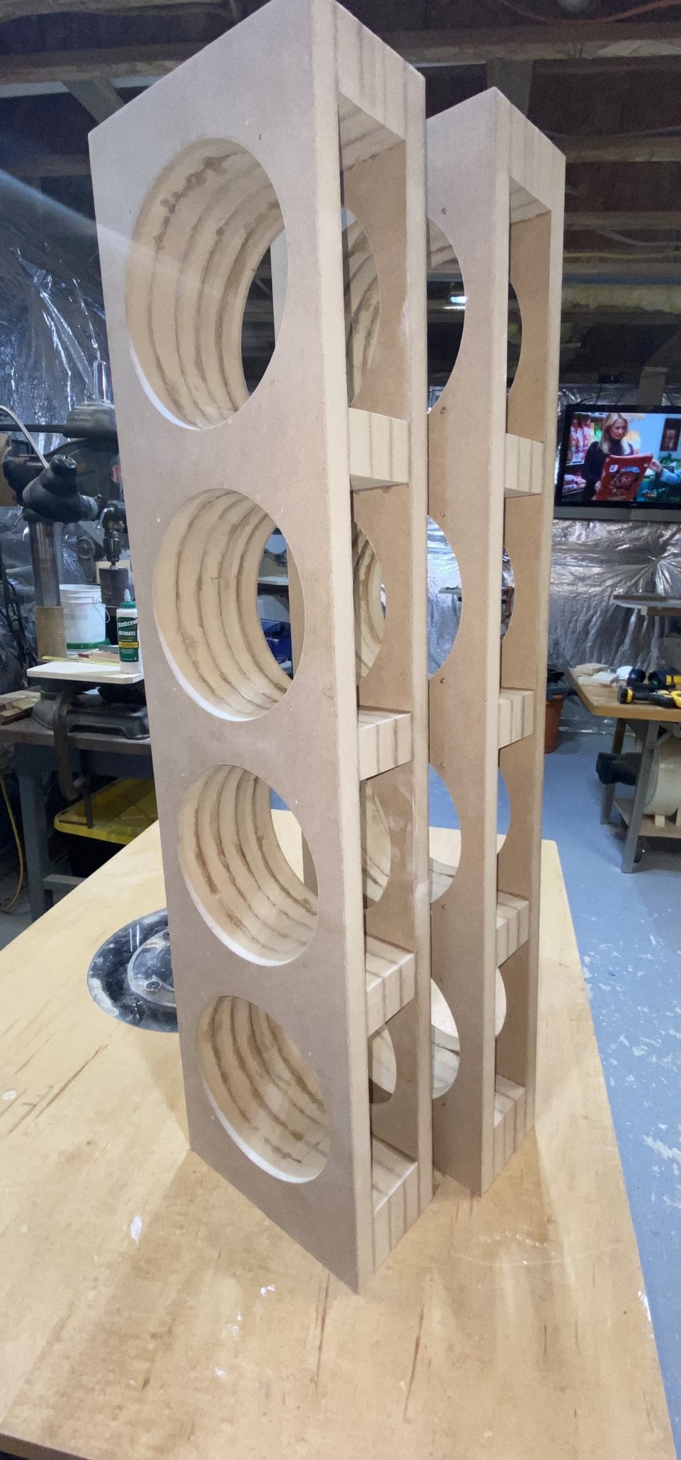

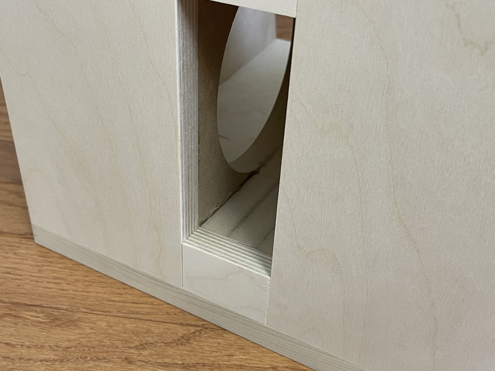

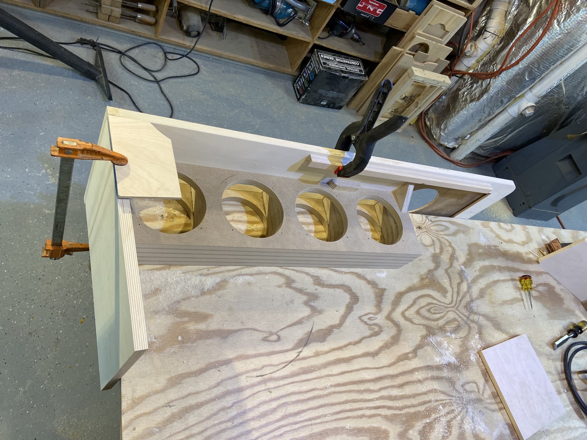

Woofer manifold made from stacked MDF:

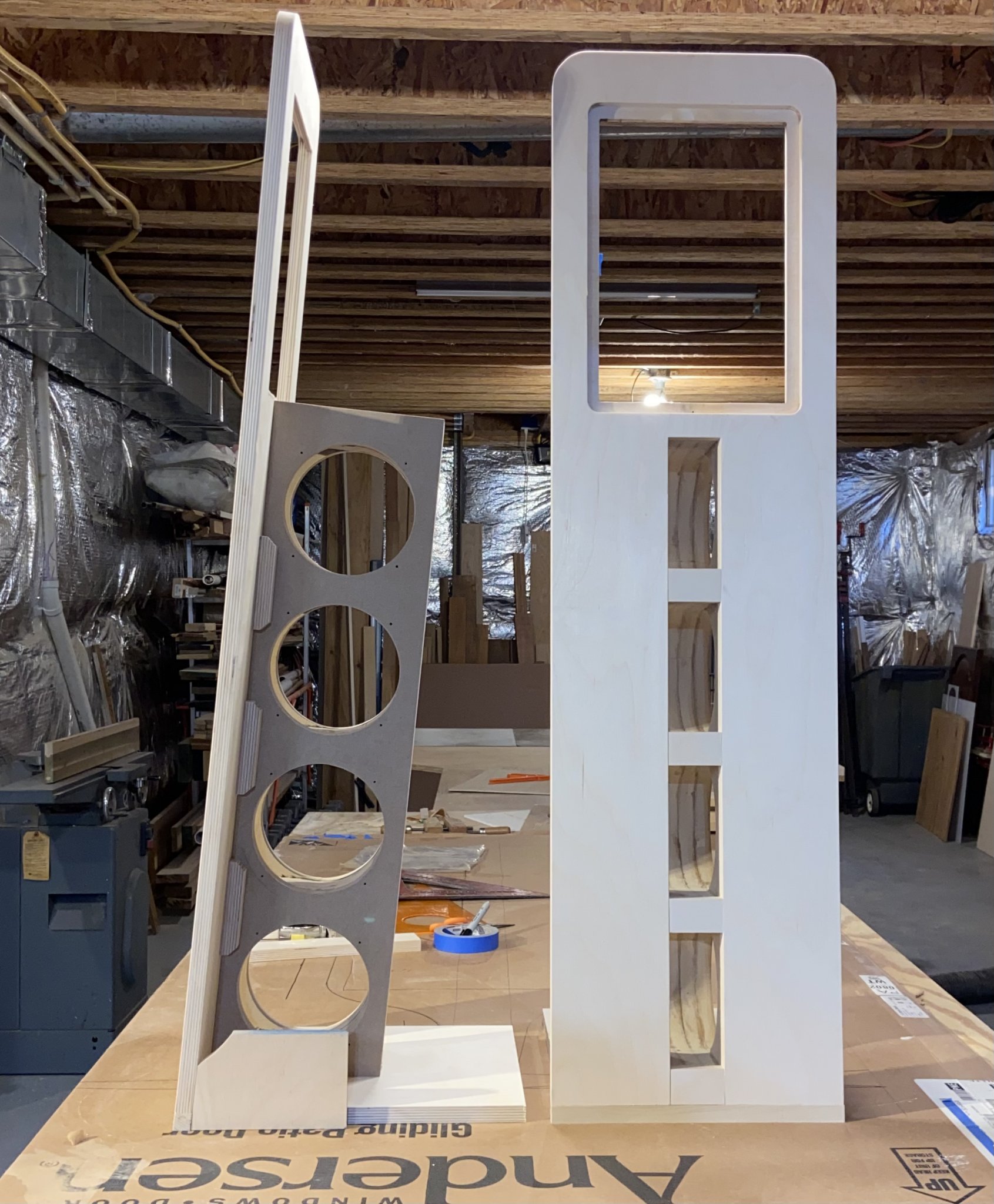

Manifolds glued to baffle:
Preparing to install the wings:

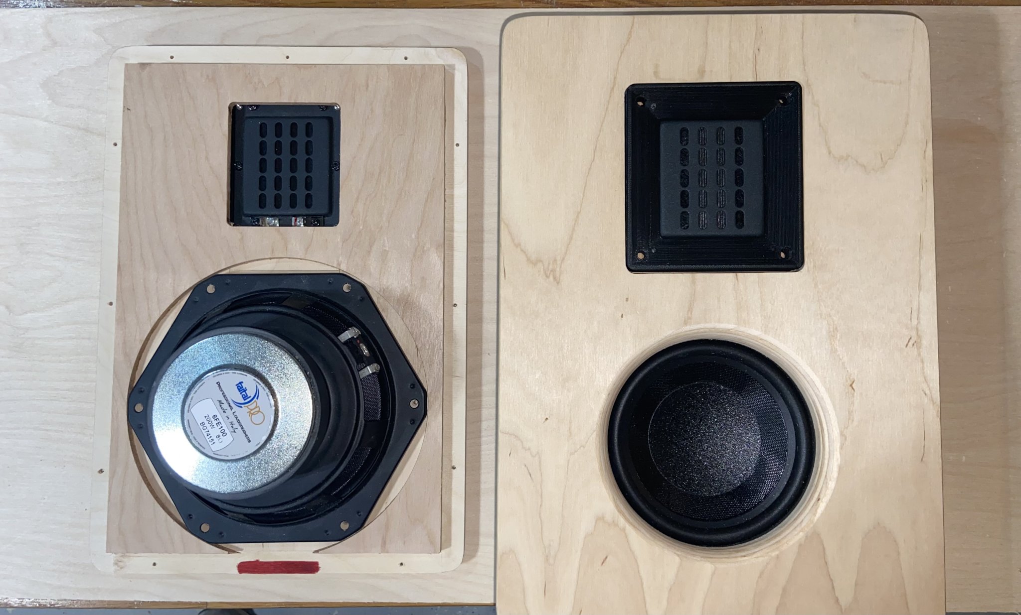

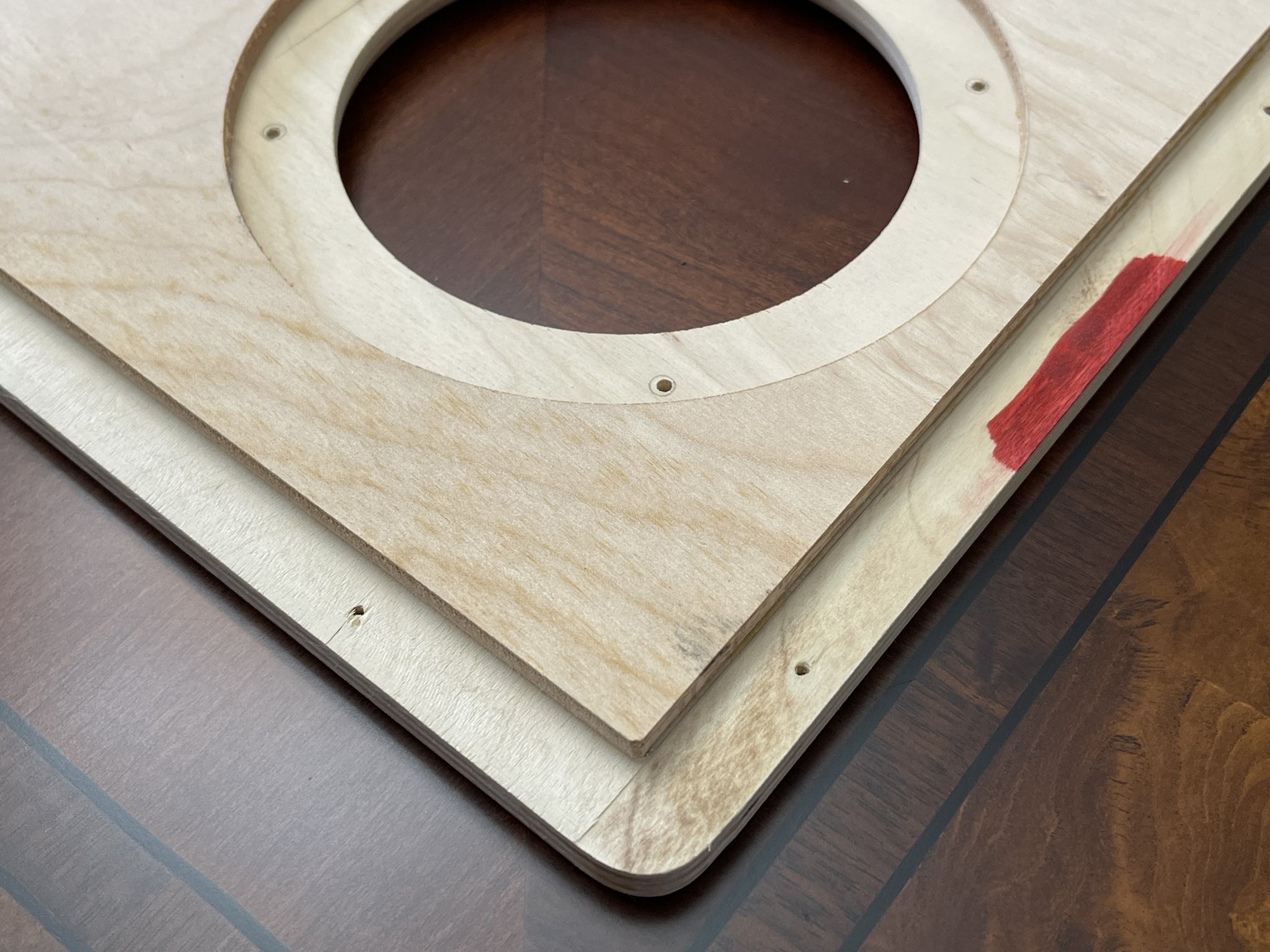

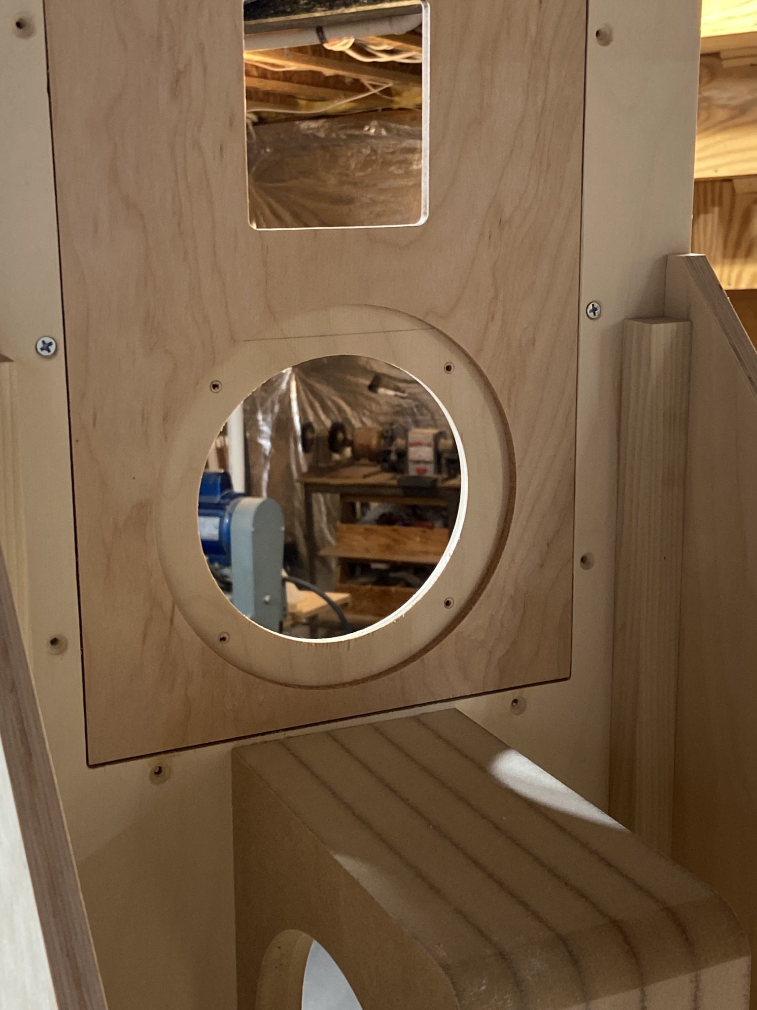

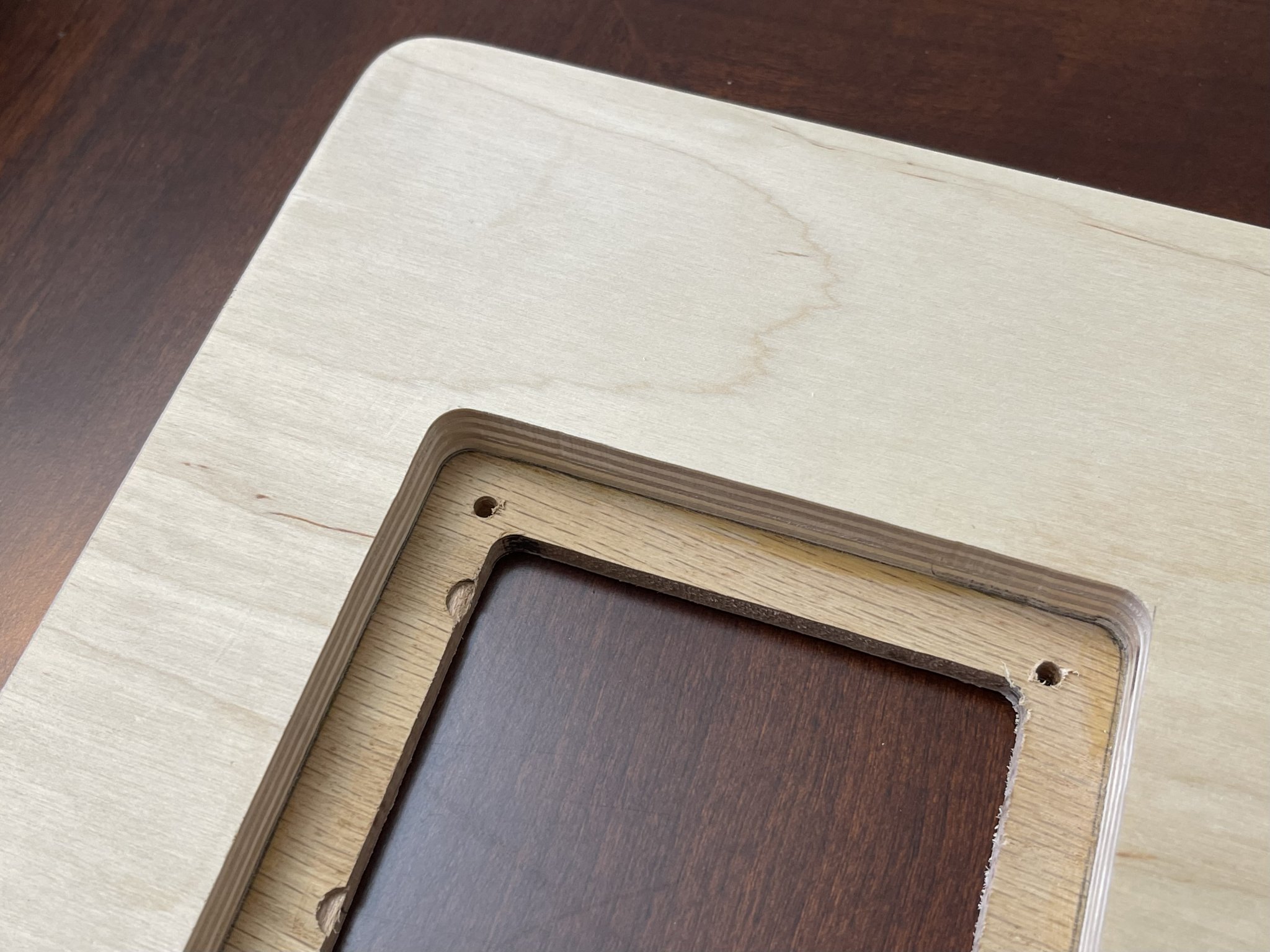

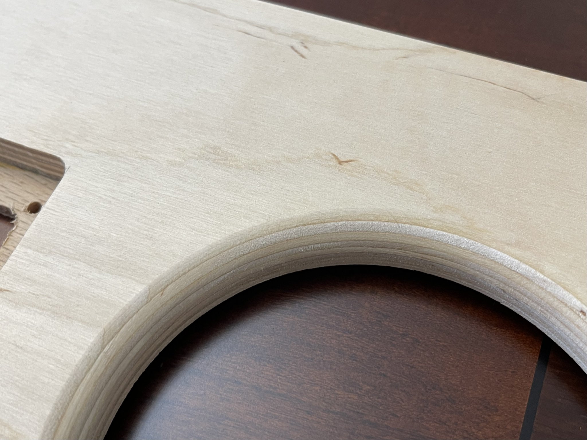

Baffles with cutouts for replaceable 2-way top driver plates:
Detail of how baffle plates are held in place from the back:
Woofers are rear mounted and tweeter waveguide is front mounted. Woofer bezels are rather industrial “pro audio” so look better rear mounted. Also, the non-circular bezels would have made front flush mount rebates a real pain. A round over on the front lip is used to provide a smoother look and reduce diffraction to the extent possible:

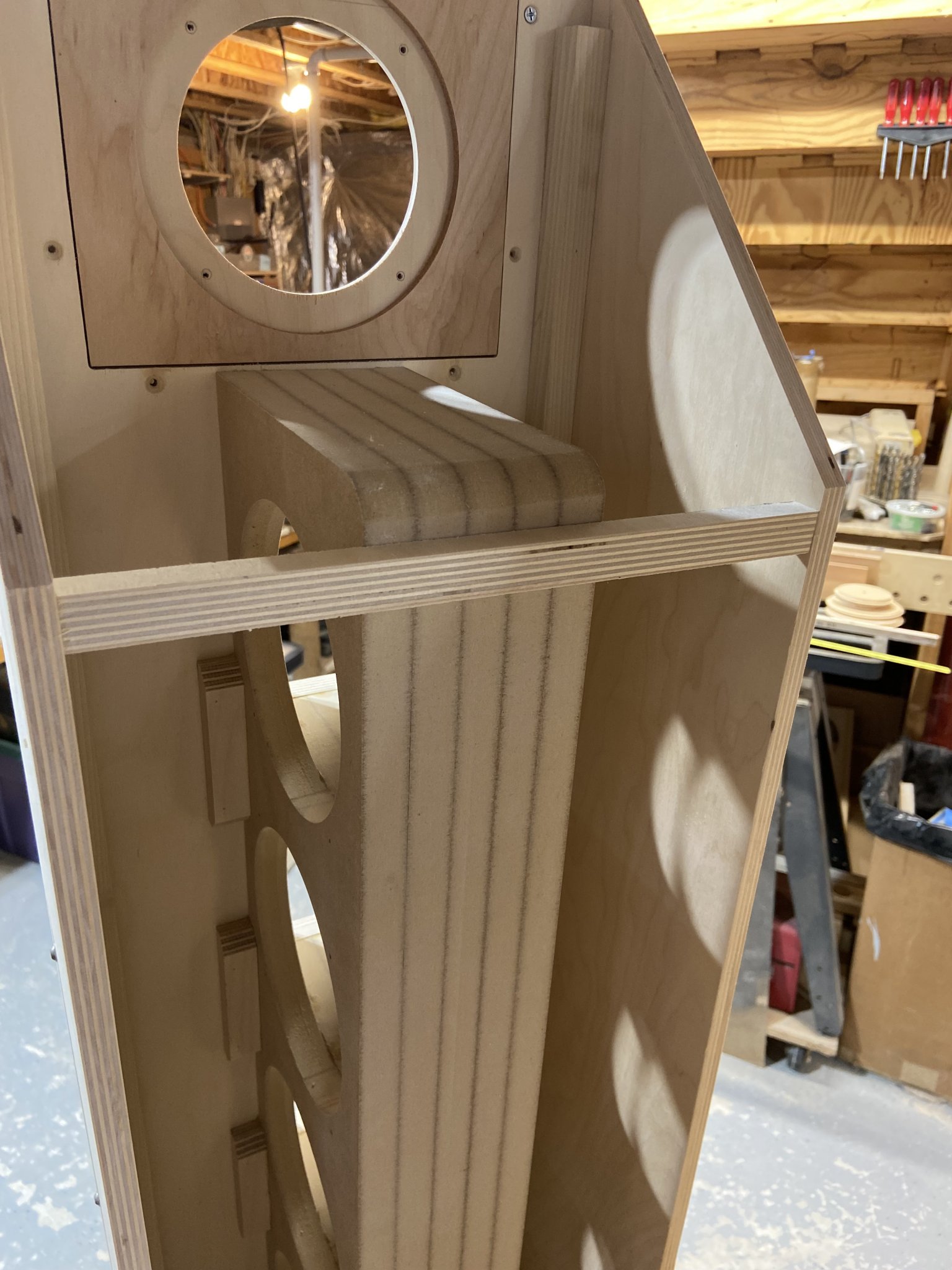

Will probably use some bracing on the wings:
This is going to be a fun speaker to develop the crossover for.

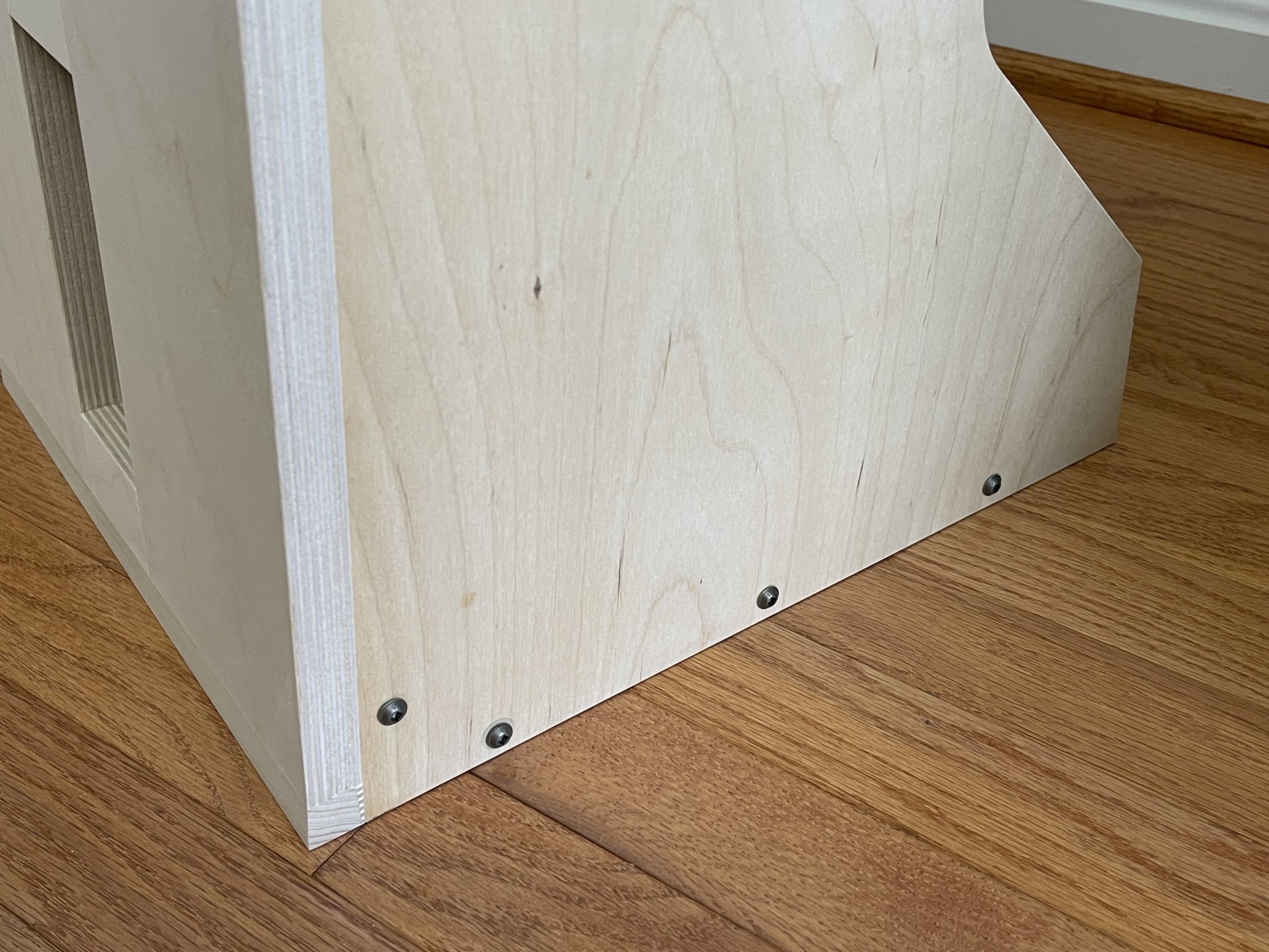

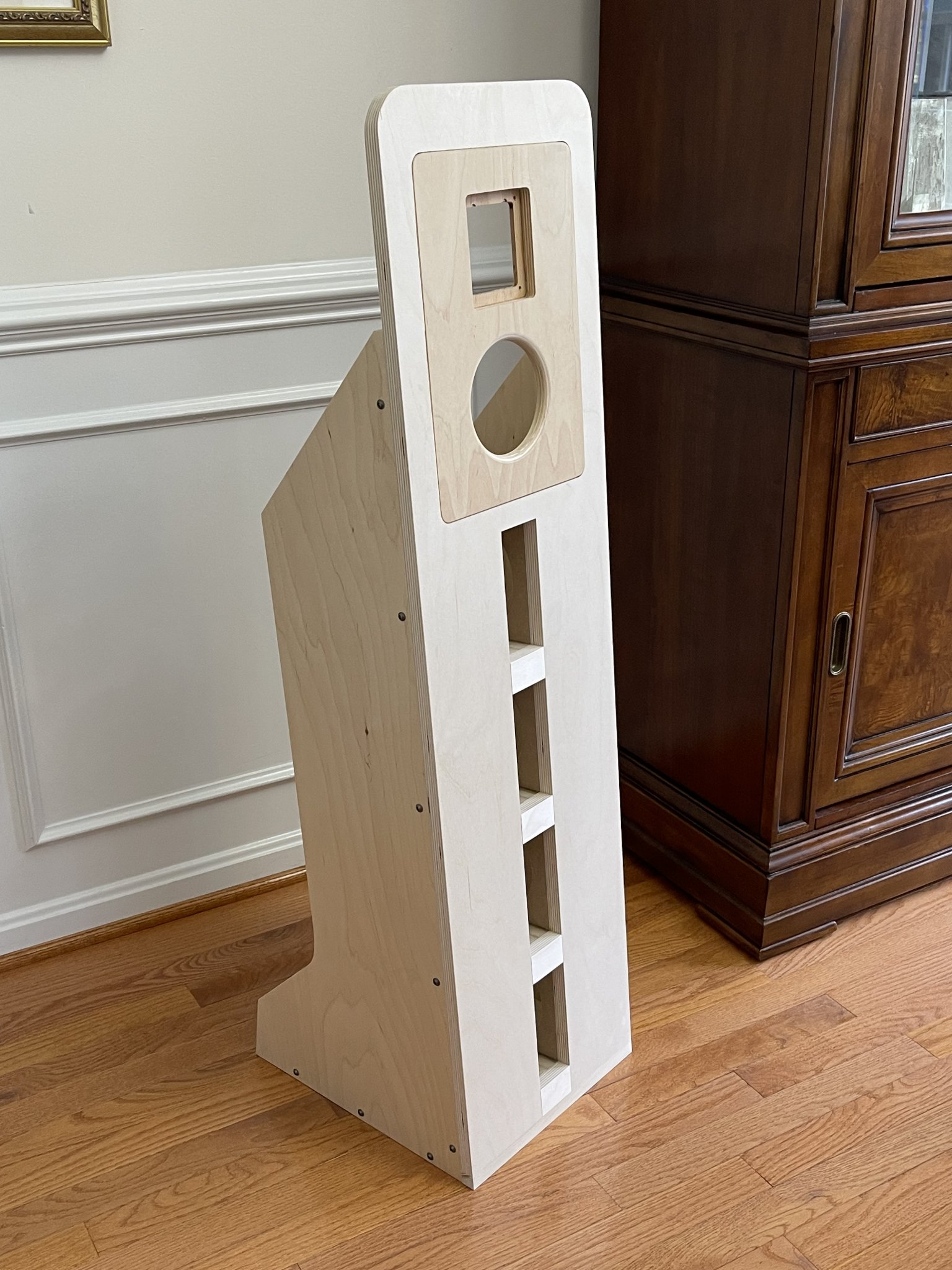

Speakers delivered. They look gorgeous in person and are much more compact (and SWMBO friendly) than I thought. 🙂
They measure 12.0in wide x 44.5in tall x 14.0in deep.
I am wondering what color stain to use, deep espresso brown or a more reddish cherry?
