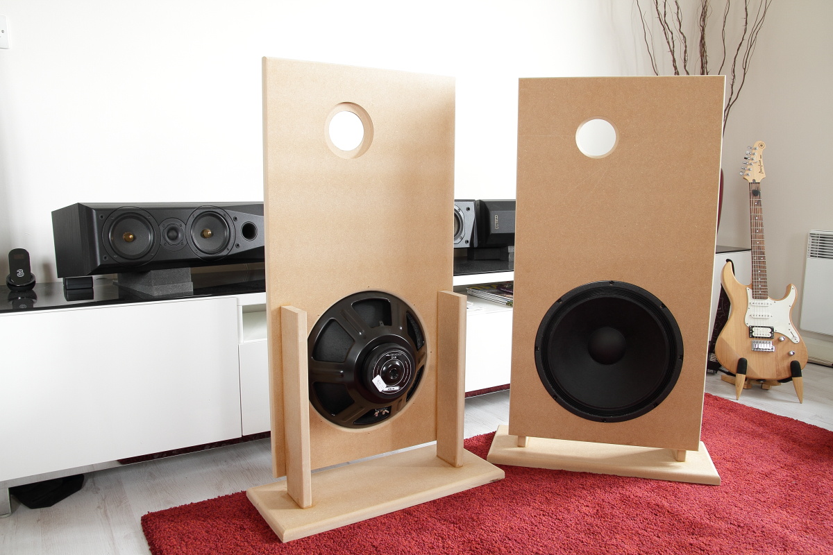

Hi everyone, I spent yesterday cutting and gluing MDF... luckily the gluing wasn't because I'd cut to much off 😀
The build I've gone for is the basic MJK OB design, will be using an active 2-way system for XO and power... From MJK's pdf, the Eminence Alpha 15A XO is 2nd Order at 200Hz, the FR unit's XO is 2nd Order at 500Hz.
Just need to go buy a handful of woodscrews this morning to mount the Faital Pro 4FE35's onto the baffle, then the fun can begin... listening to music & maybe some measurements also 🙂

Great looking build there! Can't wait to hear of the listening impressions, and of course, measurements from REW! I see you have a gap between baffle and floor - is that in the MJK design? You may want to close that up because you will lose your floor reflection symmetry and lose some bass gain. I like how you rear rebated the mounts for the Faital Pros - they are kind of ugly when front mounted. You will be one of the first in this forum to report on the 4FE35's - it might be the new FR driver to use compared to the Vifa TC9.

I can always add a section to fill the gap if needs be... or I can cut the plinth off and flush mount it to the base of the baffle 🙂
The 4FE35 are uglier than the TC9FD... the FE's woven cone doesn't look very rigid but to the touch is, the proof as always is how they sound. Just about to wire them up and might get a first listen before going to my parents for the rest of the day... Probably let them run in for a week before I make any measurements & listening impressions.
Think I may have some spare MDF in my parents garage, might give the baffle with the U shape a go. Like Z, suggested, start with a smaller cut-out and gradually increase the sizing. Be interesting to see how it effects things. Can do this with the Vifa TC9 to keep it relevant to Rudolf & Z's bits.
I see you have a gap between baffle and floor ... You may want to close that up because you will lose your floor reflection symmetry and lose some bass gain.

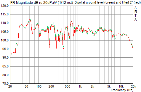

Is this of real relevance? I just measured (from the listening position) the difference between my dipole standing on the floor and lifted 2" exactly:
The difference is 1 dB max. Perhaps I should not have raised the whole speaker but only closed/opened the gap below.
Rudolf,
Thanks for making that test with speaker raised. If your speaker has a lower frame that was raised also it will probably be better than a gap. It's probably no more than a 1 dB difference as you say so I guess not a big deal and Buildmesomething has nothing to worry about.
