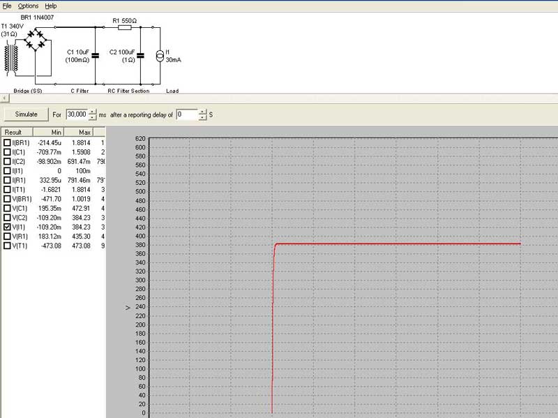

OK-- I did a lot of soul searching on this one (not my soul, but someone's anyway) and I am trying to enact a plan for a tube phono preamp now.
I think I want to go with the RCA circuit that Dave (Planet 10) posted. It seems easy enough and, since this wil be my first foray into non-kit tube amp bulding, easy is what I need right now. Experience is the important issue here for me.
A few weeks ago, I found an old Pilot tube amp (see my post here) at a TV repair joint and, rather than restoring it (it needs some real attention, plus I have yet to find a schematic), I'm thinking of using the transformers and possibly any salvageable resistors, caps, tubes, knobs, screws, rubber feet, wire, paper, oil, film, aluminum, casing, switches, smells, light (particles), light (waves) etc. to build the phono pre (in homage to P-10's Frugal-phile(tm) concept).
It looks like the power Tx puts out about 340V in the secondary so, like a big boy, I tried to design a power supply using the Duncan Amps PSU designer. Attached is a screen grab of what I came up with.
So I'm asking politely, please rip apart my PSU design for the RCA phono preamp, dress me down and advise why a stupid Secretary General of the United Nations should have even considered DIY Audio in the first place. While you're doing this, if you could advise why this would or would not work, that would be very helpful.
One issue-- I made the load a 30ma current. I did this because Kuei Yang Wang had this as the load in his PSU designer attachment, but I'm too stupid to understand why this is. I think it means that I will need to have some sort of transistor-regulated constant current source in the PSU, but I'm not sure how to build one or if that is even the case. Any help on this one would be much appreciated.
Thanks again for all the ideas and all the help.
Kofi

LOVE the ID tag! Whan a novel idea! Good luck on your tube project ~ don't kill yourself ~ 340VAC will leave a mark, and possibly a widow.
Are you insured? Please send picture of wife and any watercraft you own. On second thought, just send the boat pictures.
No watercraft, but Mrs. Annan has added a little junk to the trunk in the last few years and has actually become quite buoyant! I'd attach a photo of the aforementioned "flotation device", but decency prevents such an action.
Now back to the audio-- any remarks on the PSU? C'mon... I'm wide open for criticism here. Can't believe no one wants to humiliate a guy for tryin'!
Kofi
