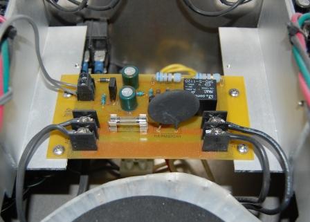

Rudi, the issue is safety not function. In your picture above, the trace that the "mm" of your dimension falls on is a low voltage trace. There really isn't a reason for it to be so big since it doesn't carry a lot of current. Reduce its width to allow more space between it and the mains connection. I'd grind a bite out of it on your current board.
I agree. The distance is very small. This board is simply dangerous. On my soft start board I keep at least 10mm distance between the mains, and the low voltage tracks.

Hello Andrew, John,
I am happy to tell you, that my smal "Soft-Power-On" - board "works as designed".
Best regards - Rudi_Ratlos

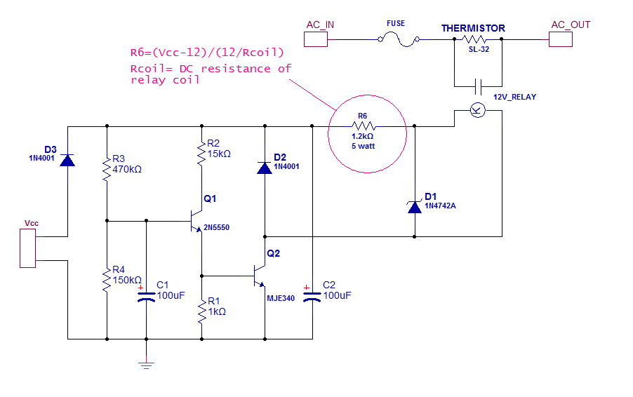

I think D2 may be redundant, D1 will clamp spikes in both directions.
I think moving the anode of D2 to the base of Q1 would be worthwhile. After you move the anode of D3 to the AC side of the main rectifier it will cause the charge on C1 to bleed off as soon as power is removed, even for a moment, and give a fresh timing interval. Make the diodes 1N4004 (or higher voltage).
Consider using a higher coil voltage on the relay.
Good tips djk - I didn't think of connecting direct to the AC of the transformer. Makes perfect sense. 🙂
I used what I had on hand for this and at the time I had no 24VDC relay. As my rail is 56V, a 24V relay would have been a better choice.

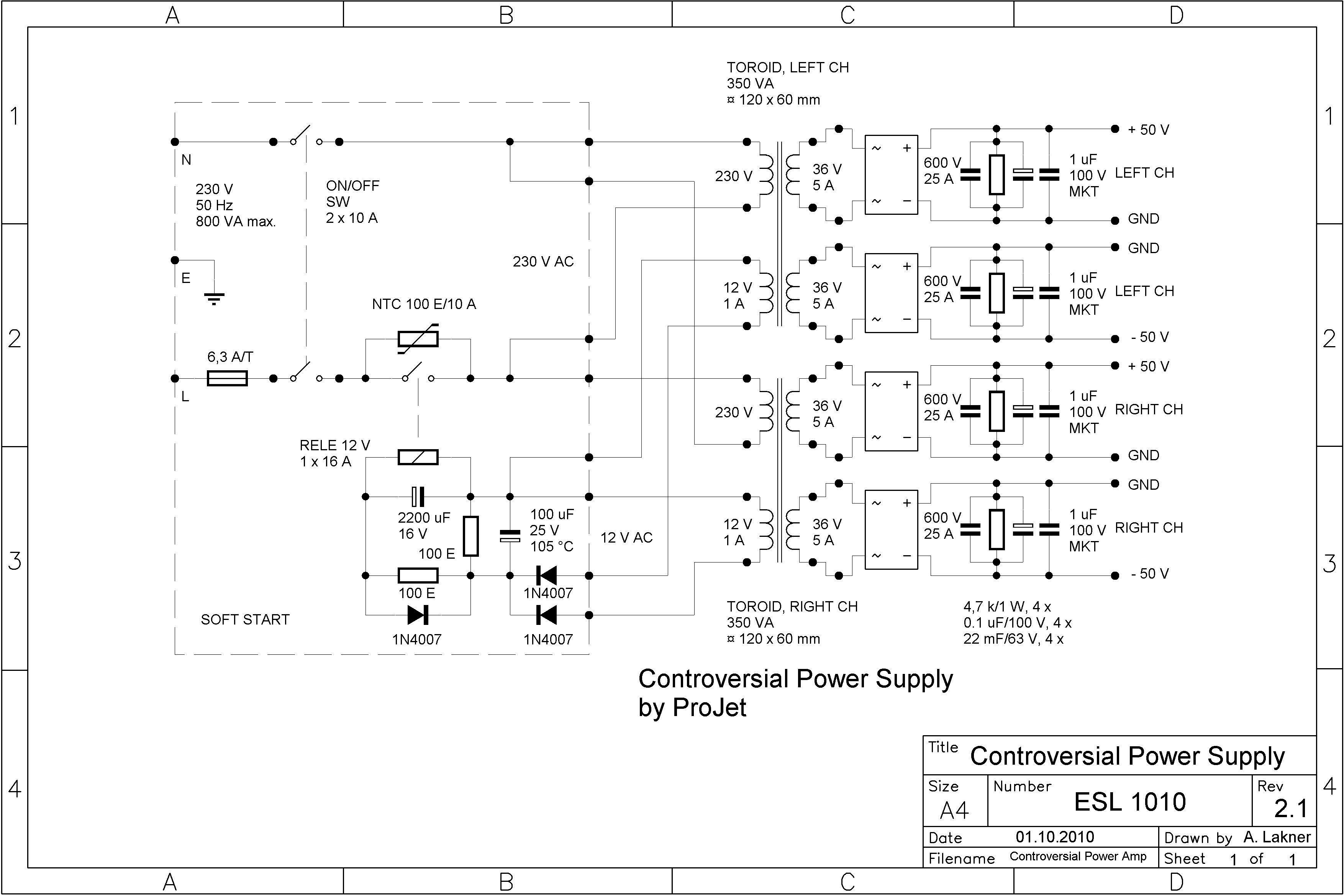

What do you think of this one:
TOROIDAL TRANSFORERS - Soft Start
I use 2 of them, 1 in my monoblocks 2000VA.
Is this a good design?

Rudi, I'm glad it works, not that there was much doubt. Did you grind away some of the low voltage ground trace to get >6mm between it and the mains traces? This suggestion is for your safety.

if you think Rudi's creepage distances are bit on the low side, you should compare that to the soft start that came out of Brazil.
It even has power planes for mains voltages that surround some LV pads/traces.

This exact schematics, simple but effective, was originally published in Elektor Electronic a long time ago ... and just like allways, without any authorization, there's someone making the business out of it. Otherwise this is simple relay delay (fixed delay time) made out of passive components and thus very reliable.
...is off-line powered.
