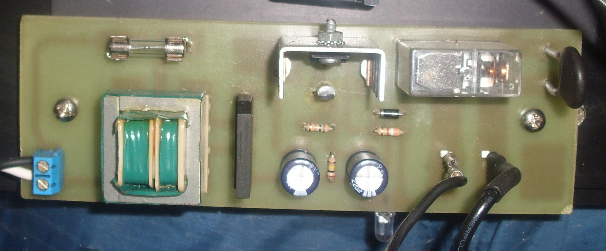

I use 20 Ohm/12W high temp resistor and a relay powered from DC output. As soon as all voltages are proportionally up the relay shorts the resistor up.
It will protect from inrush when cycled on/off: if relay is still on that means capacitors are charged, so no inrush current. If they are discharged, the relay is off. However, on/off voltages for relay are different, but it is not a big deal, according to my experience.

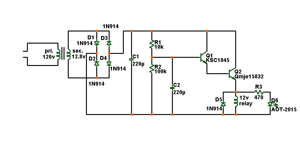

I use one of these ...
15A NTC thermistor , as current passes through resistance goes down to 2-3R. Circuit below, ( magnetron relay - 20A and 12.8V trafo from broken micro oven) triggers relay across the thermistor after 3 seconds.
All junk parts , has lasted for 3 months now to keep inrush from 1KVA trafo at bay.

Hello Samsagaz,
I have just etched these PCBs:
following this schematic:
My old laptop-PSU's output (15VDC /2.5A) is fed to a 12V 7812 voltage regulator. The 7812 voltage regulator will then activate relay K1, which passes the main's voltage (220V) via 2 NTCs (22 Ohm each, thus delimiting the inrush current to approx. 5A) to the main's output connector.
The 7812 voltage regulator's output will also trigger a LM555 timer (via R1/C1).
The output of the LM555 feeds relay K2, which will bypass the NTCs after the pre-defined time (aprox. 0.8 sec).
I will solder this little PCB (70 x 70 mm) and test it over the weekend.
If it works (and you like it and you have a wallboard-PSU), you can have my spare PCB.
Best regards - Rudi_Ratlos
