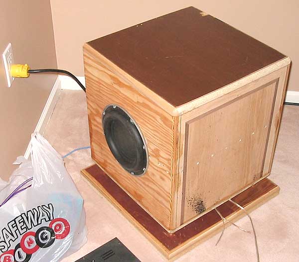

Below is a push-push (ie 2 of them) prototype woofer we are playing with..

jleaman said:Complements of my picture..
Yep JL gets credits for the proto pic (not the Super 8 one)... i get credit for the detour to get the batteries so JL could take the pics 🙂

Credit yes yes camera need's batteries : O ) And yes that sub had every kind of material used : O ) sounded pretty good too. Say all but one.
Tekko said:Nice sub, different material in every side😀
Prototype, made of scraps... including bits from a table project and the top from a console hifi :^)
Got to get a decent XO made for it, the one we tried -- a vintage 70s dB systems was kind of hard to listen thru (and we didn't have the bits necessary to bypass the hi-pass)
