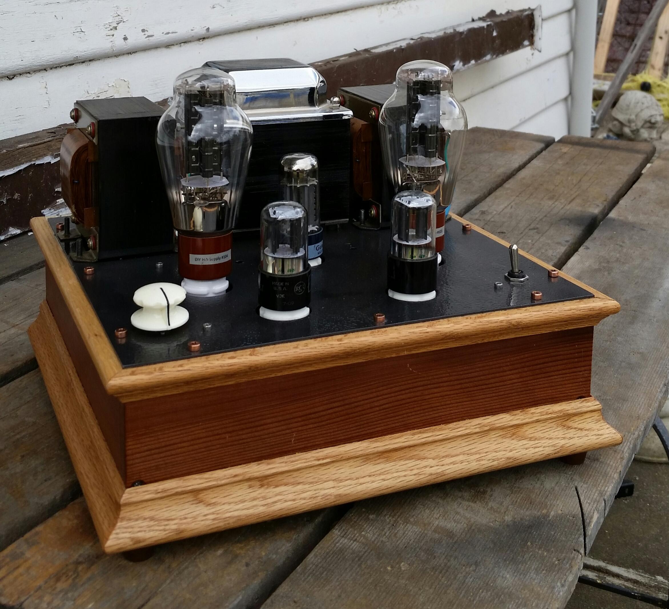

Cheap 300B project
So the Vdc of the circuit is 350 Vdc, less or more.
Which is the value of Resistor that comes from Vdc of the entire circuit?
If we can reach about 400 Vdc for the 6SL7 we can get around 2 volts at each cathode that is better.
What you feel about sound now?
Walter
Thanks Walter and everyone for your help and knowledge, I'm very happy with the sound .

circuit for kit amp
Hi everyone, I just finished a amp using a cheap Chinese PCB kit. It works ok but hasn't got much volume or bass until I turn it up to max on the pot.I'm not skilled enough to work out whats wrong .I have no readable schematic, just one from the description online. I've attached a pic , maybe someone might be able to help.
thanks
