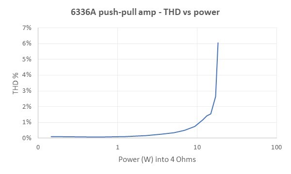

6336 push pull
Recent build 6336 in push-pull Class A, 8K plate-to-plate, no negative feedback delivered 10W at <1%THD, 19W at 5%THD.
De Haan and Heuvleman achieved even better measurements (Glass Audio, May 2005).
Just curious . . . how much power does a 6336B make in SE and in PP? And what OT primary do you use?

Wow, they used 450V B+ with an 8K P-P OT, in class A, to get 10 Watts out with 0.1% distortion.
Pretty good distortion figure, but lowish Watts (for two 60 Watt 6336 tubes) with the high Z primary OT.
I think I would use a lower Zpri OT and lower B+, with some local NFdbk to the driver stage, to get the low dist. with 25 Watts output. (class A)
With 10 Amps of heater power, one should make use of the high current capability of the tubes, and leave the distortion fixing to the driver.

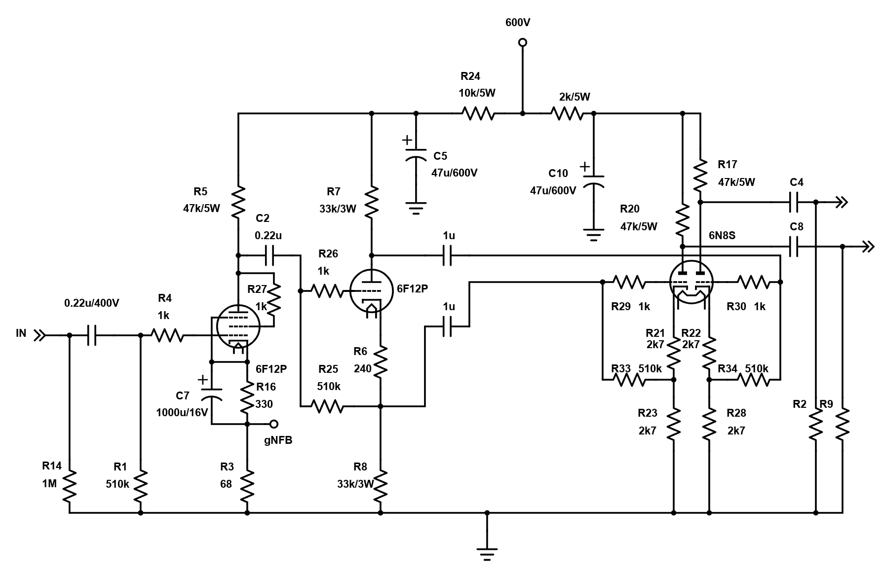

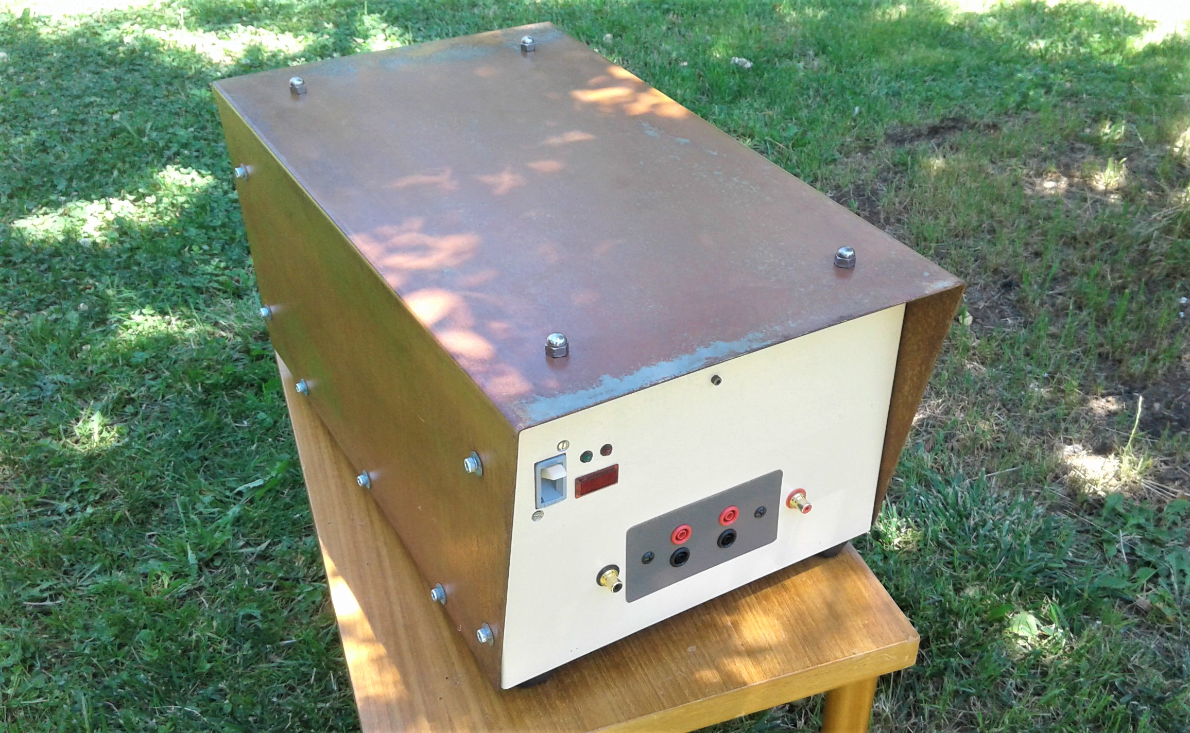

Anyway, I tried H&deH's approach with 6336s - I found the distortion figures achievable but the circuit and the power supply got so big that I found it difficult to tame.
Casting around, I was intrigued by Lynn Olson's Amity and I reworked the 6336 amp to a simpler 2-stage topology with a less demanding power supply ...
Both topologies sound BIG - and here I am comparing the 6336 amps to very good PP-KT88. However, my ears told me that my build of the H&deH design could sound edgy with my speakers, where the two stage topology did not and was more pleasant to listen to - so far so good ...
On driver valves, I tried 8077s and 12HL7s, of which I am fond. However, I had better results from big-bottle RCA 12HG7s that deliver gain + mo' current - probably better suited to driving the 6336's significant input capacitance.

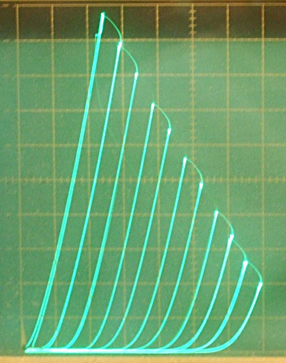

Looking at some V regulator tube datasheets (6AS7, 6080, 7233, 7236, 6528, 6336, 7241, 7242) all except 7233 and 7236 have plate curves that end abruptly at their Vmax spec. 7233 and 7236 go up another 150V above that.
Looking at the plate current curves plotted, all of them go up to 1x the max current rating, except 7233 and 7236, which go up to 3x the max current for 7233 and 2x the max current for 7236.
The 7236 datasheet states that it is for amplifier use. But it still has exactly the same high 2nd Harmonic laden curves as the V regulator tubes.
When you take into account the max Watt ratings on a load line (in class A), it becomes clear that exceeding just -HALF- the Vmax rating by say 50V or so for the V reg. tubes, you will be leaving behind the high current capability in order to stay within the max Watt rating. So the high heater current and Htr. Watts begins to be wasted.
There is some longevity advantage in de-rating below the max current rating for sure, but going below 50% is just wasting Htr power.
So my take on these V reg. tubes is to use a Zprimary OT that gives expected typical class A output power (rather than prioritizing low dist. at lower Watts or exceeding the Vmax rating) and then use some minimal local NFdbk to get the dist. down to an acceptable level (below hearing).
Or use the triode emulation scheme (with driver NFdbk enforcing) to get high quality triode curves from the outputs. When you have a quality triode emulation
-model-, the NFdbk has relatively little work to do to get a real output triode to conform to it.
Finally, it seems that these high current V reg. type tubes (except 7233 and 7236) have essentially the same Imax DC and Imax peak ratings. So while 300 or 400 mA DC rated (per section) may seem impressive, the TV Sweeps have similar DC ratings at the 30 to 40 Watt rated level too, but they have 3.5x times that for the -peak- current rating. (of course pentode mode with grid 2 helps assist that greatly)
Once one achieves "Nirvana" using triode emulation NFdbk, there seems little reason to use these large expensive triodes, including 7241, 7242 ... and 300B for that matter. Just use a big TV Sweep tube(s) for the output tube, with a driver stage with a high quality internal "model" triode. (driver UL NFbk, make sure to get the phasing correct with crossed N Fdbks)
Using an UnSet drive scheme may still make good sense with a 6528 V reg. tube (mu 9).
I have some 6080, 6528, 6336 and 7233 V reg. tubes to try out, so I'll see what is making the best sense for an amplifier set-up with these.
