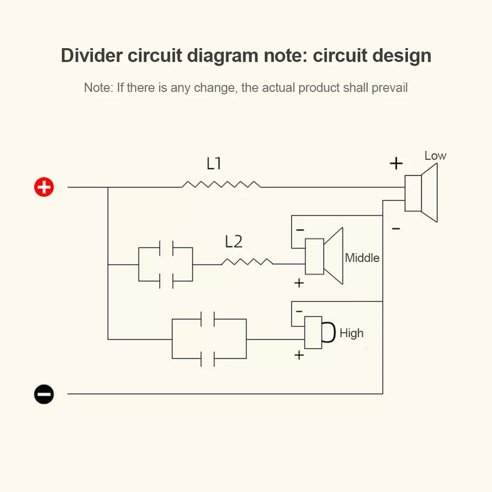

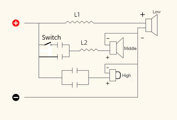

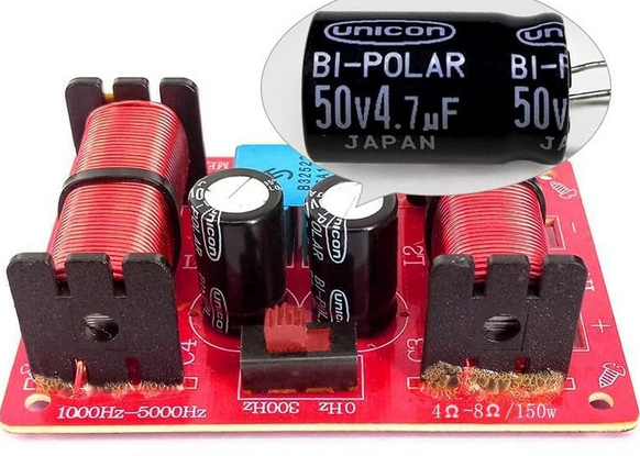

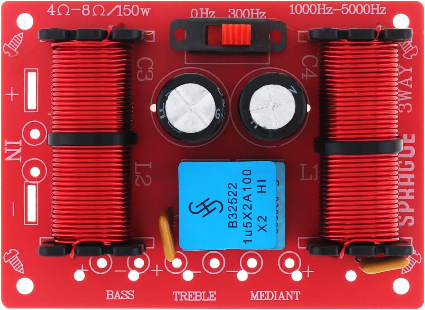

Cheap 3 way crossover question. Anyone have any ideas what this switch does?
I don’t know. It’s not impossible for those who know to work out why it’s there. But I’ve gone for the other option now that Galu kindly helped out with and suggested.
Thanks for all the input, everyone. I just wish when they do these ads they would clearly state what is exactly what, other than some garbled description.
The one Galu suggested also came in at £8.26 for two (cheapest I could find) as opposed to the Amazon £14.99. Prob on a slow boat from China, but I’m in no rush. As long as it works ok. It’s basically the same crossover without the confusion, and it actually says what the frequency divisions are in this ad.

Trying to be kind sometimes can misslead people and make them waste money. Imo a clear and definite answer will help much more. Some may be so politicaly correct to think this is rude. Discussing his wrong picks will not help him.
There are countless threads describing why NO universal x-over EVER works. All what you will get for your money is the perfect proof of this fact.
If you want a x-over, design one or look for a proven design.
As a "I don't know and don't care" DIYS person, the only way to do a useable speaker is to copy an existing design. You have the illusion that your combination of 100% wrong parts will give you maybe 50% of a perfect speaker. You are dead wrong!
If you don't blow the drivers with such useless Chinese junk, they will sound awfull and insult anyones ears listening to them.
So please, stop and try to do it right. Active crossover and a measuring microphone would be you fastest and only way to something working. Then, there are many nice passive projects out there you can copy and that will not cost more than the money your are going to waste. Just ask here, be prepared to answer some questions and you will have a great chance to be a successfull first time builder.

I changed the tweeters, to a decent peerless I already had here (I like them anyway). It’s a 98db horn though, so I thought it would need an L-pad, which I also added. But after opening, I found its rather pathetic crossover was also not letting treble through on one speaker. So a new crossover has now been sourced (thanks Galu). The cheapest one I could find actually, and it still looks like an upgrade 😀
