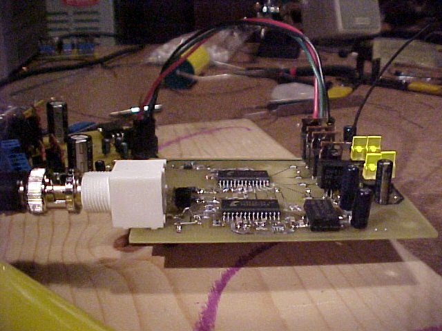

I built this thing today, but haven't listened to it yet as pulse transformers are still in the mail.
Here's a contest: spot the missing wire in the PCB layout.

If I read your drawing correctly, you are connecting it directly to the RXP and RXN pins of that Crystal receiver?

Tacky, isn't it? But I tried it out with these parts and saw no trouble. The pattern was clean with the trafo coupled directly to the 8420. I measured it on tx and rx side of cable with my full battery of space-aged instrumentation*.

Those inputs are Schmitt trigger types.......saturated logic.......very bad for reflections. It will sound and measure much better with some type of buffer in between.
I built a D/A convertor prototype once in one night's work. Spent the next 6 months getting all the reflections out of the circuit.

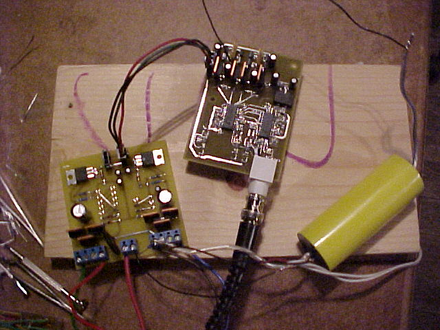

I'm quite pleased to report that this unit works as drawn. I completed my prototype assembly tonight. It starts and runs perfectly well. There are startup and shutdown transients of approximately 3Vp-p at 10Hz, so be careful when testing.
The mistake I made in the layout, which nobody took my challenge of finding, is a missing trace between the LEDs in the current source for the line driver on the left channel. I had to bridge that with a bit of wire.
Also, I mistakenly rotated the two pull-down resistors on the right of the CS8420when assembling, and it took some time to find that problem. Be careful, and next time I'll draw them assymetrically.

Did the pcb have split groundplane? Have you made any tests with RF-emission. Can you listen to radio/TV near the DAC?

I'm putting together a similar circuit(but with AD1853), but am new to the digital side and had a question on your layout. On the Cs8420 you have pull down resistors on the unused pins. Is this the best way to deal with them or can they be left floating, or just grounded?
Also the spec sheet shows 3 of the HW mode1 select pins direct to ground, and you have pulldowns on those also (DFC0 DFC1 S/AES) at your original 4.75K value this is pretty close to gnd, but with the spec'ed 47.5k they're a bit off the ground?

Actually I have pull-downs on the pins because that is how the CS8420 configures itself. In hardware mode, the 8420 needs pull-up/down on each pin to set the options. Check the datasheets for the hardware mode options.
I wanted the 4.7K to ground because, as you point out, it improved the logic margin. But, this makes the chip sink a lot of current per pin, so I reverted to 47K. I don't have any problems.

I understand the pull/up/downs for the startup pin settings, but was curious about the best way to deal with the pins that are completely unused such as TXN, TXP, etc. and also have no startup function in HWM1. You have pulldowns on all of them and I was just curious...
Well okay, I forgot about TXP and TXN. I pull them to ground to keep them from picking up noise.
Oops. I just got the transformers in from Scientific Conversions. They are bigger than the pads I drew for them. Another board bug. Luckily my CD player has a transformer-coupled output. With all these bugs piling up, I should me a second revision.
