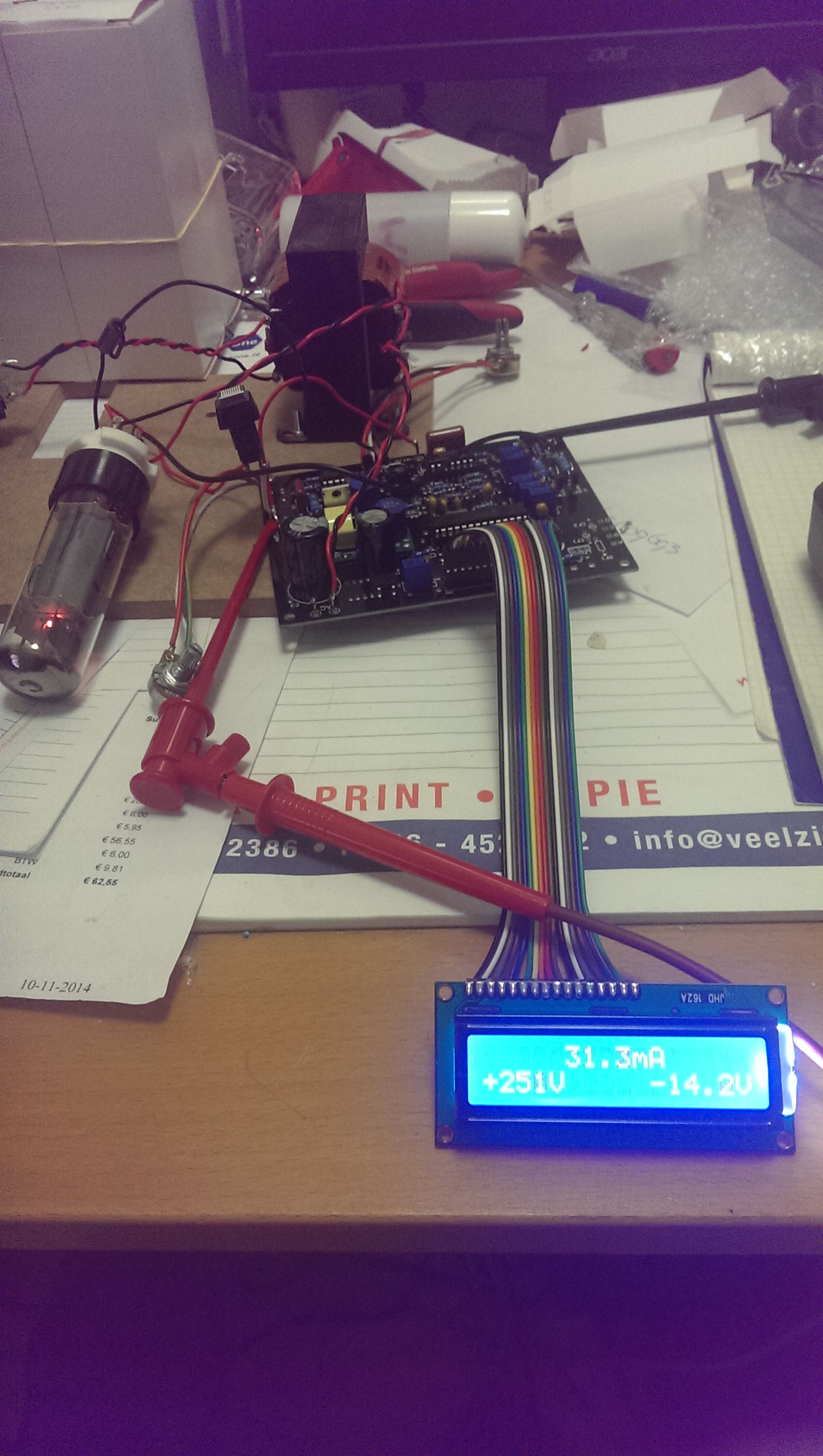

In about an hour I had it working and was testing my first tube; see picture.

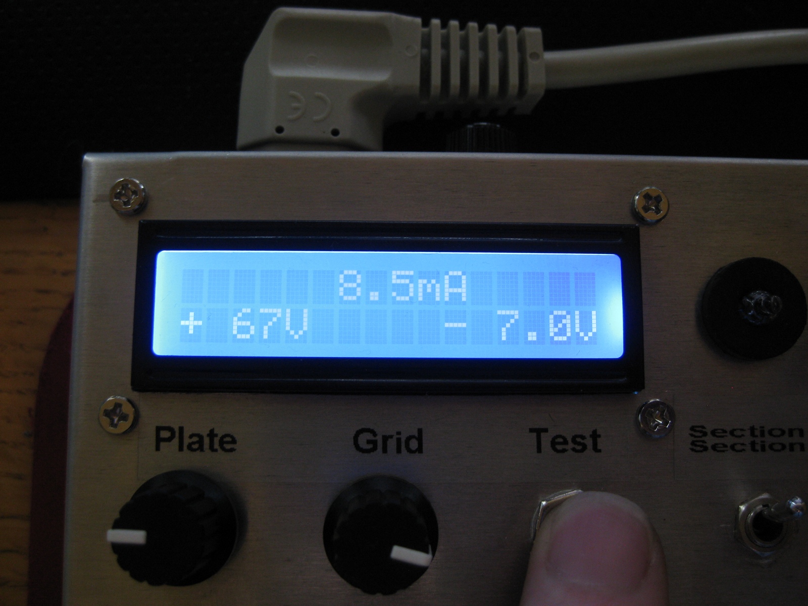

The tester works really simple; it has two knobs for setting Va (anode/plate voltage) and -Vg (grid (bias) voltage).
If you push the test button it measures the Ia (anode/plate current). It measures pulsed so the tube is safe from overload.
You have to know what you're doing with these kind of testers, because you have to interpret the measurement yourself.
Manuals for vintage tubetesters are easily found on google; you can base setting on these, or use tube-curves to determine a measurement point.
For example: In an old AVO manual I saw that EL34 is mostly tested at Va 250v and -Vg -13.5v. According to the manual 75mA should be "new".
The meter measures in pseudo triode mode. There is an add-on in the manual to build a screen grid supply for true pentode measurements, but I decided to leave that be for now.
I quickly found out that al my old RFT EL34 are in different conditions, but not one broken. To my surprise, I had ordered 4 new electro harmonix el34 in october last year from "elektrodump.nl", 3 of the 4 tubes were defect. This was easy to see on the display, they were pulling grid current (gassy), so the negative Vg drops as the measurement starts. One of them even started flashing in the tube! As you can imagine I was a little bit disappointed... but after telling "elektrodump" my findings, they offered to replace the tubes free of charge! So the tubetester paid itself immediately back!

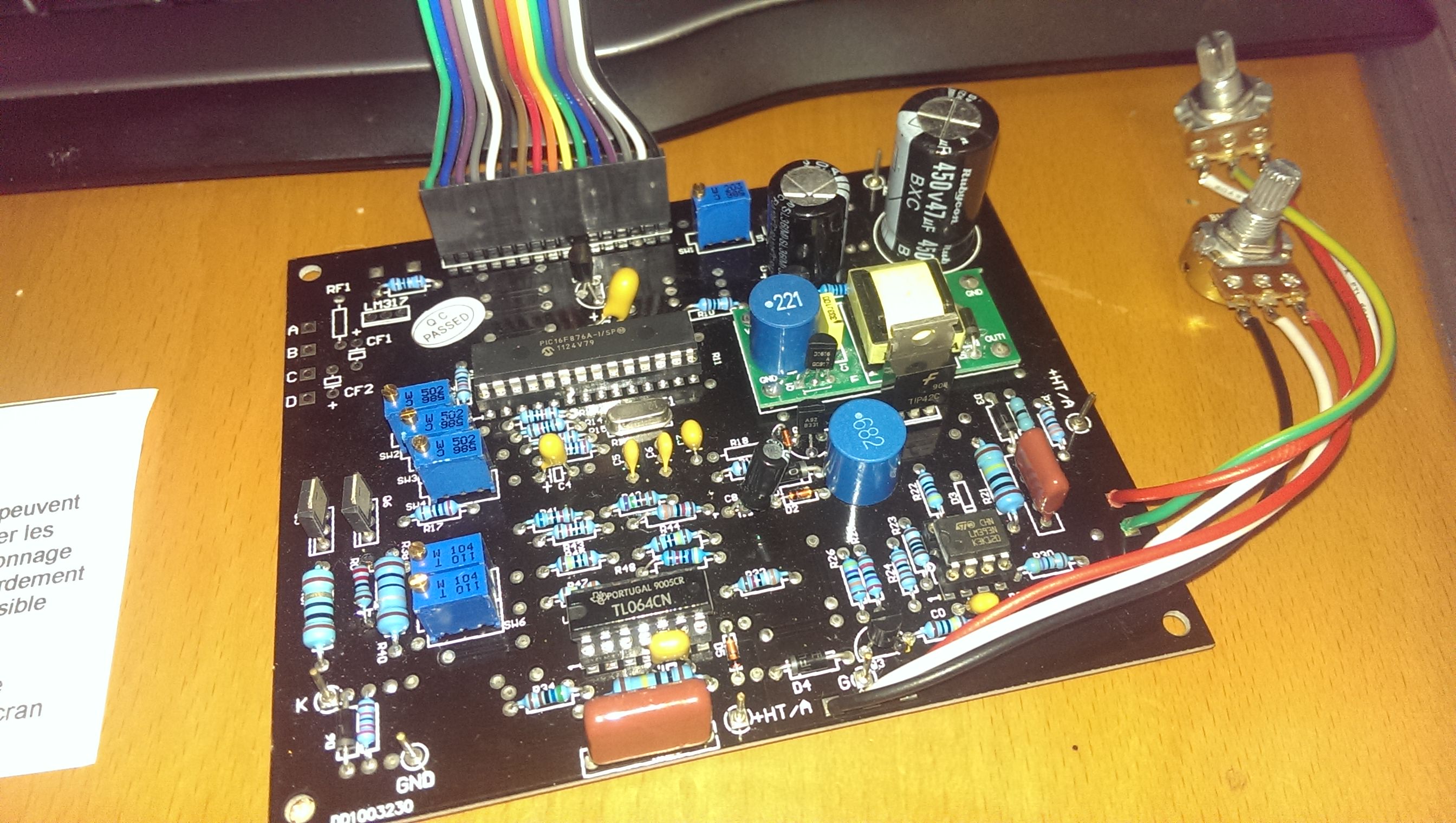

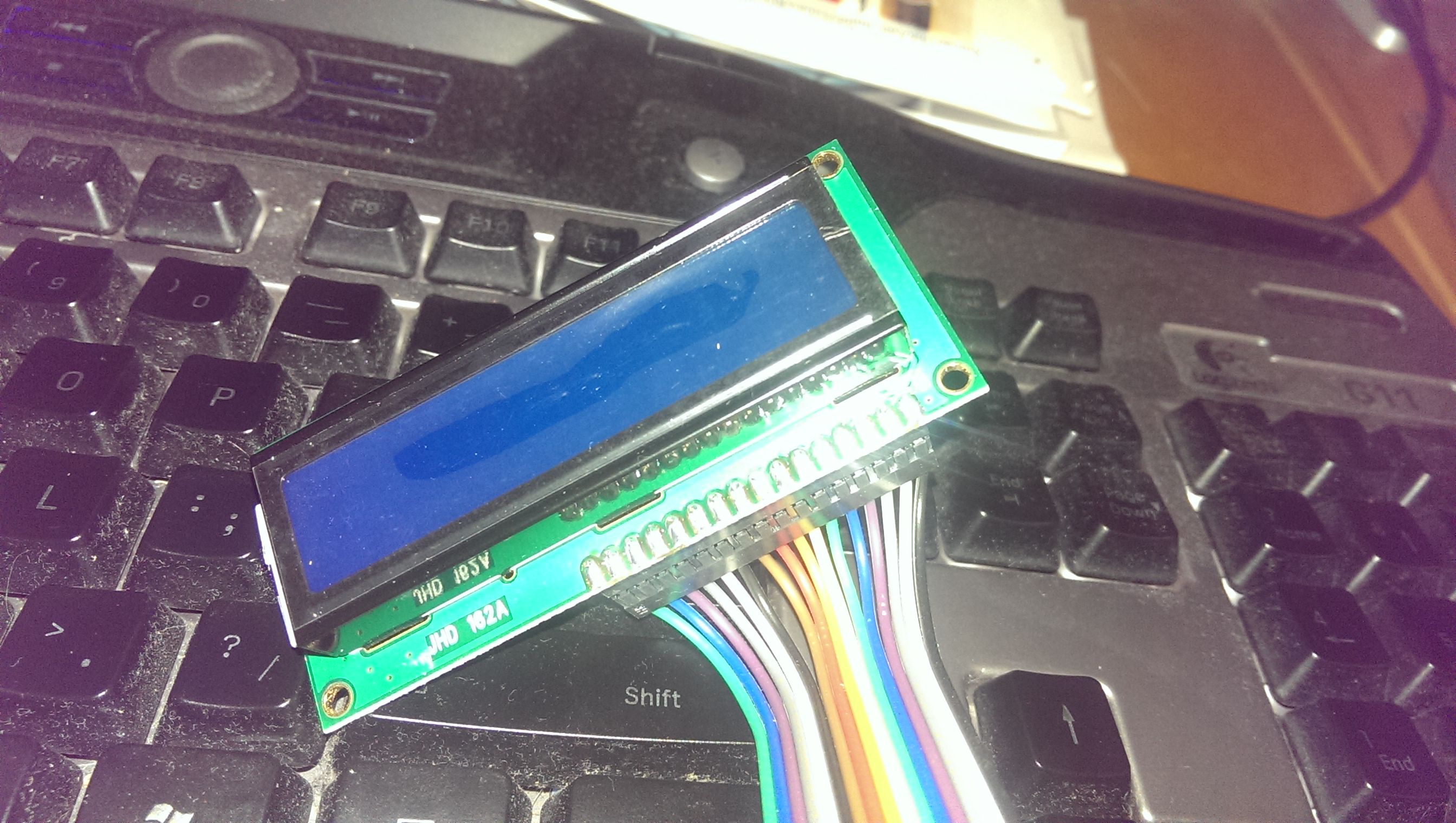

I believe I didn't mention it before, but if you order the tester, you get a completely build pcb, and a small pcb with the display. The flatcable between the two pcb's and the potmeters are also included. The complete module is powered through a single 6-9v ac connection, approximately 600mA. It generates the Va (plate voltage) and Vg (grid voltage) through an inverter!
I used an old tube transformers its 6.3v output; worked perfect.
As I was planning to be able to use 6.3v heater as well as 5v, I swapped the transformer for a 9v toroid later on. There is room included on the pcb for a lm317, but more on that later.

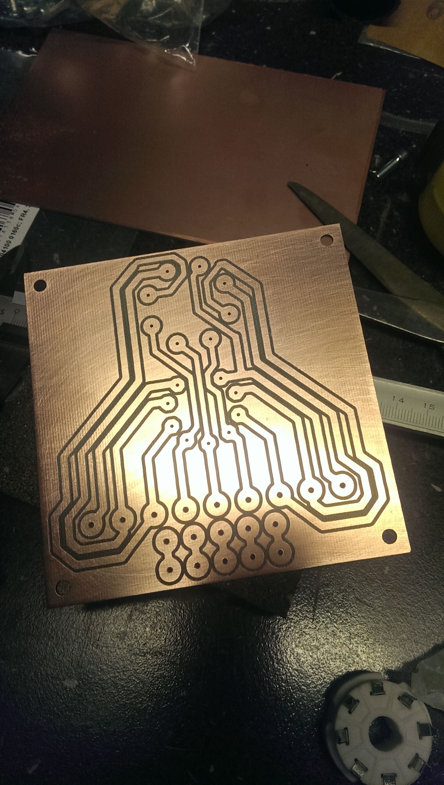

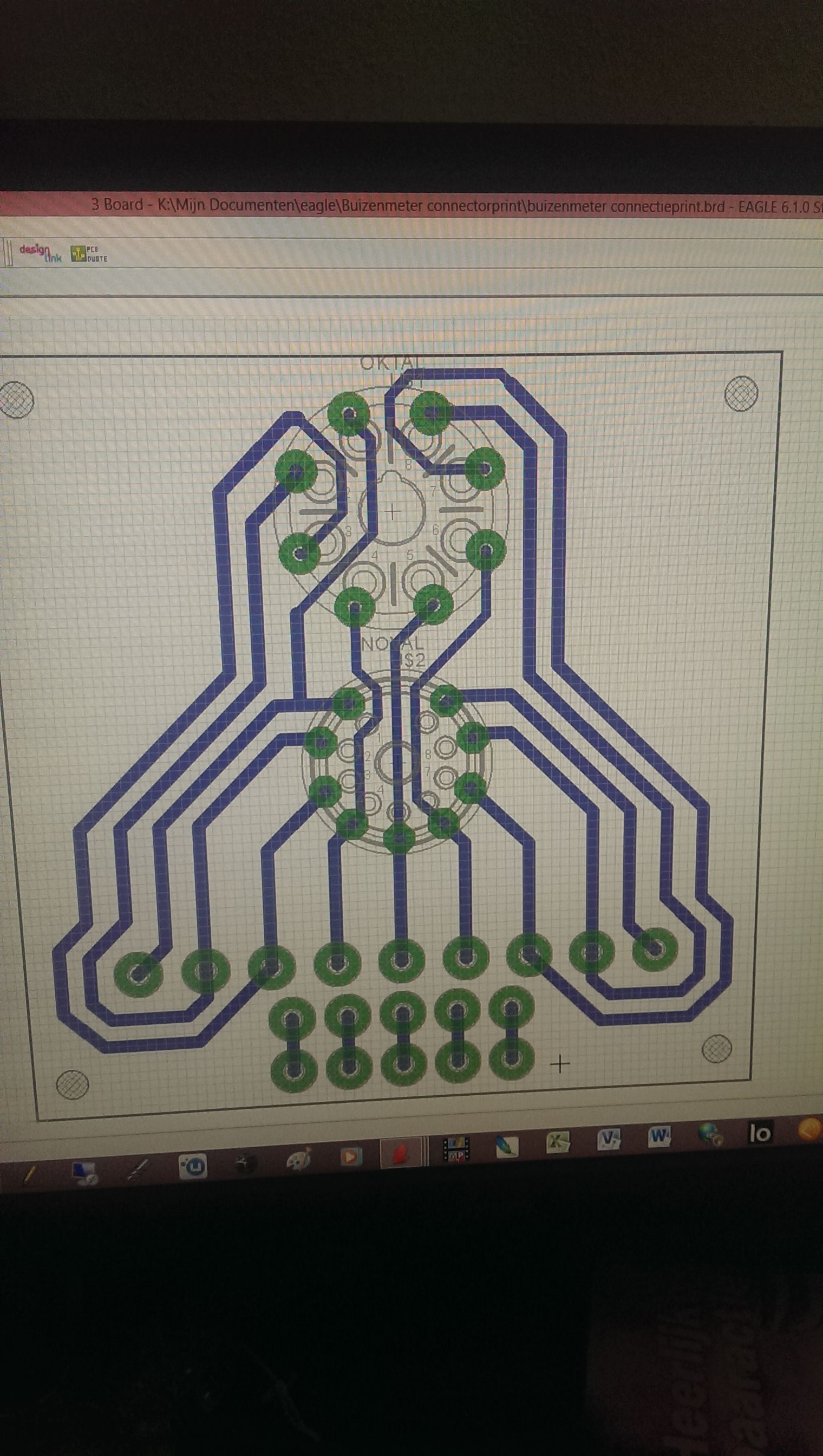

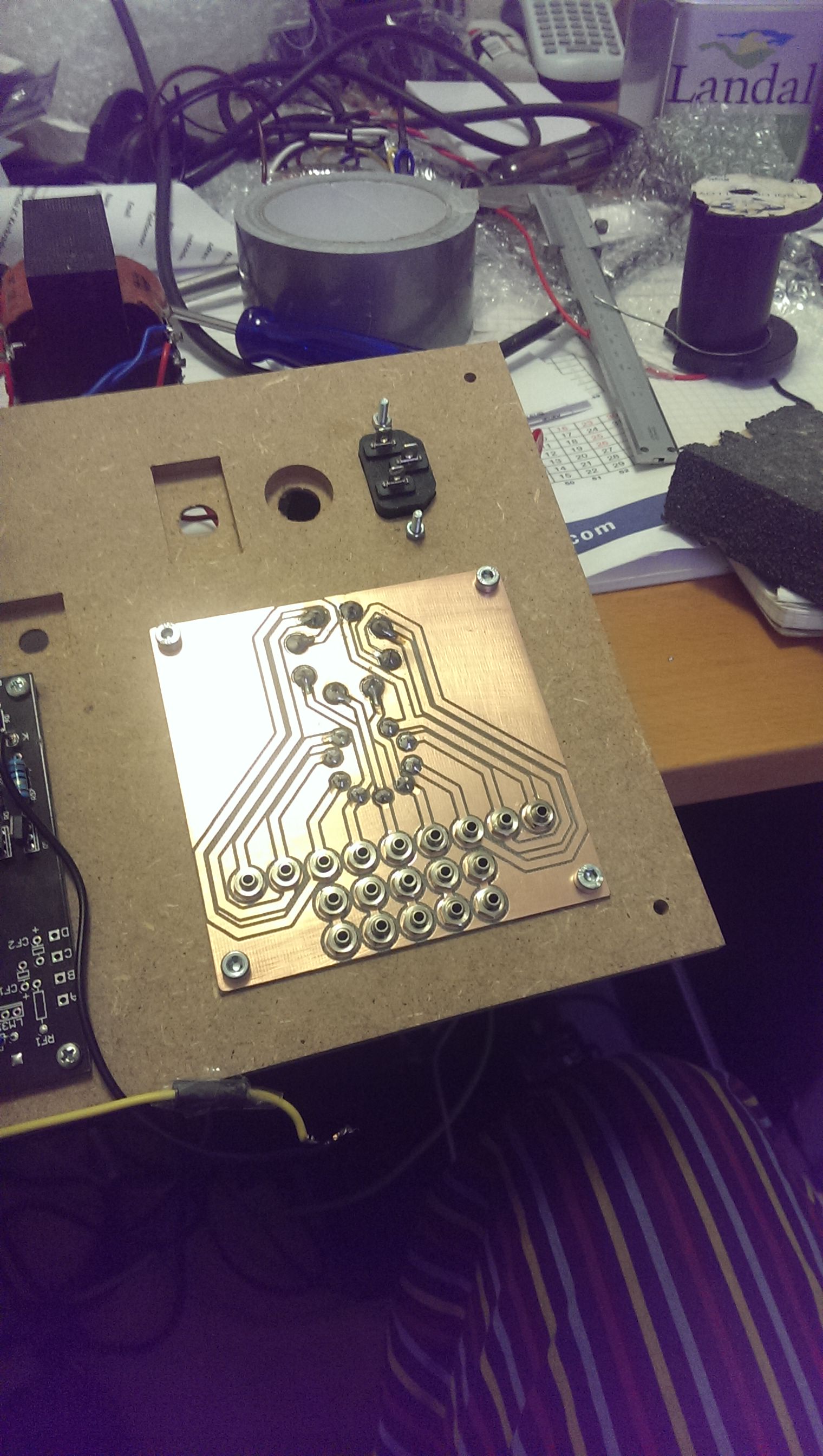

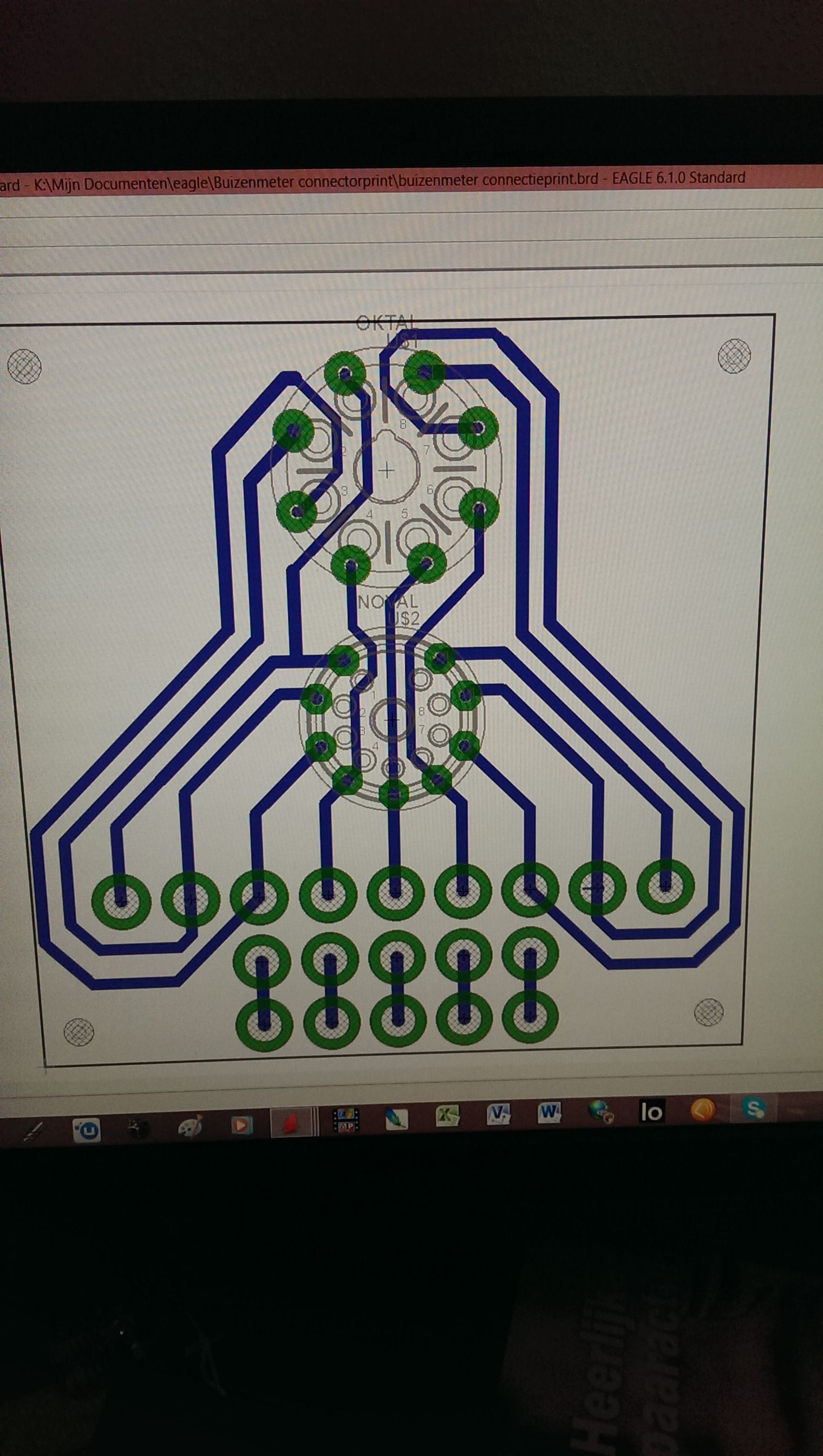

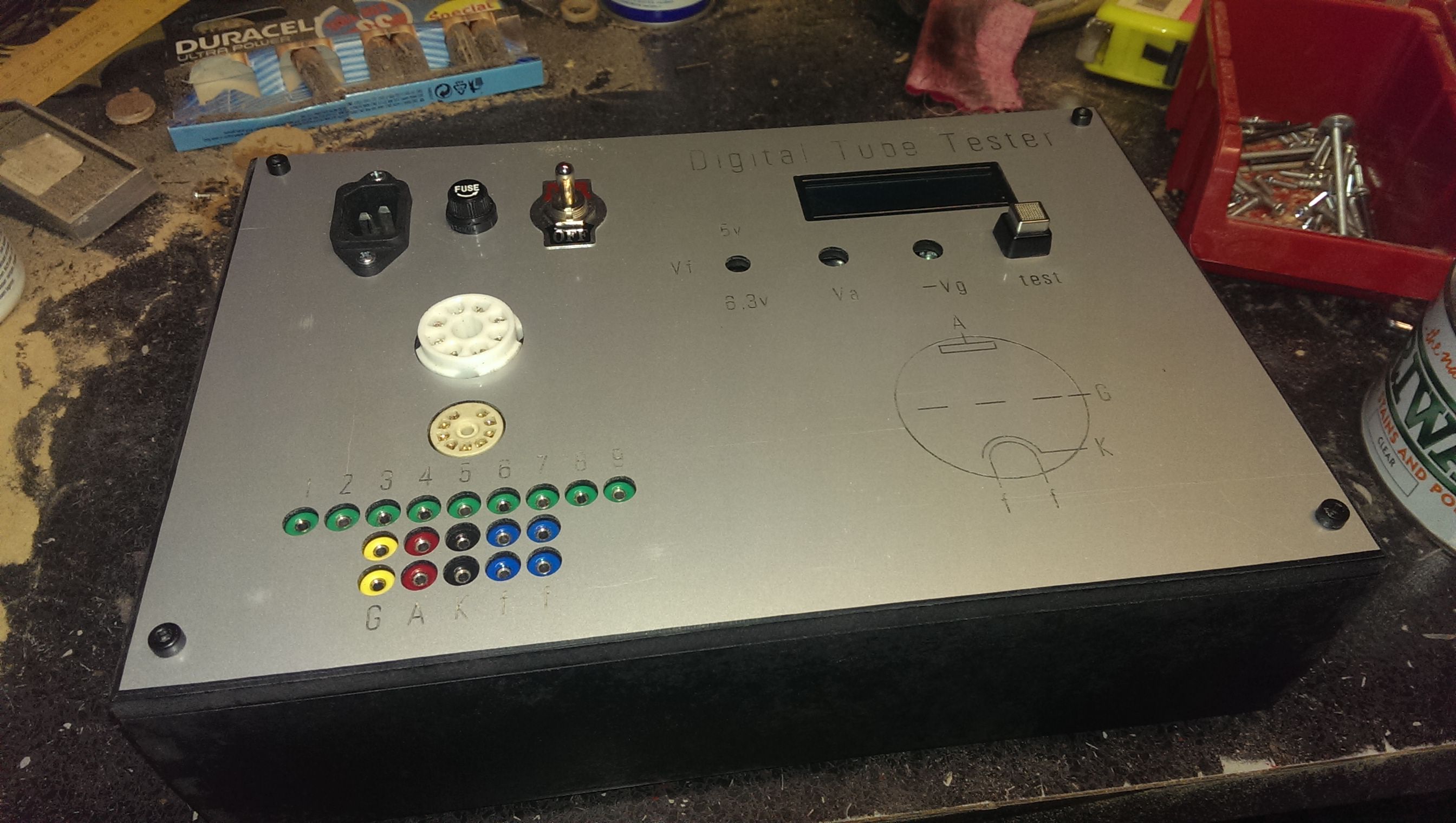

The thing I did after the first tests is design a connector print. As I planned to make a nice enclosure for it, this seemed like a logical step.
I wanted to use mini banana connectors; alas I was impatient and started designing before they were in my posession. Of course they were bigger then expected and I had to redesign.
Then I designed the front of the enclosure; i was afraid the loose pcb would be broken soon:eek:. Now I could assemble the parts.

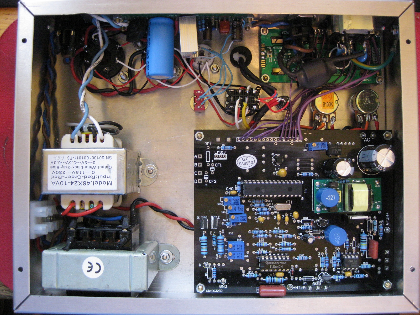

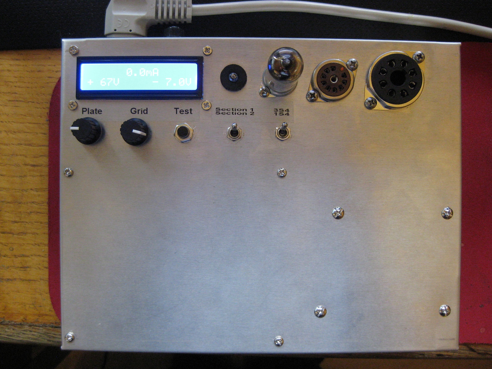

Hello ,
I build this tube tester with the curve tracer from this seller in the same box and you can switch between this two applications and also a regulated HV power supply .
Kind regards , Alexander .

That looks really good. Also a good idea to build them together; so they can share the powersupply.

I talked about the empty space on the board for the LM317. If you want to use this possibility, don't do it!
The circuit on the PCB is wrong(LM317 placement), there is no space for a rectifier.
If you want to use a LM317 for the heater, you are better of making a separate PCB. Had I noticed this upfront, I would have included it on the connecterboard.
