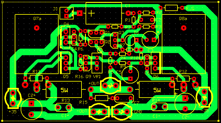

Shouldn't the image of post #22 be removed? If it's indeed a board designed by Rod Elliott then posting it here is a copyright violation. The reason why Rod Elliott is able to publish such a vast database of information in his website is that he makes living selling boards to his designs.
No, it's a PCB designed by one of diyaudio's users - r!sc!
I emailed him to ask kindly for the pcb original, but he didn't answer. 🙁
Also I didn't wanted to make a chip amp...i like projects 03, and 03A, and there is no worries about shortening the output, beacause as I said, i will use it for a subwoofer - once it's soldered nobody touches it. 😀
Chips are expensive, for making a chip amp for this sub. And after all ... wich chip runs on +/-42V ? STK's are even MORE expencive than other chips. And those darlingtons are very cheap and reliable here, so I decided to give it a try ... bad beggining. Still wating for a suitable proposition for an amp circuit for my sub.

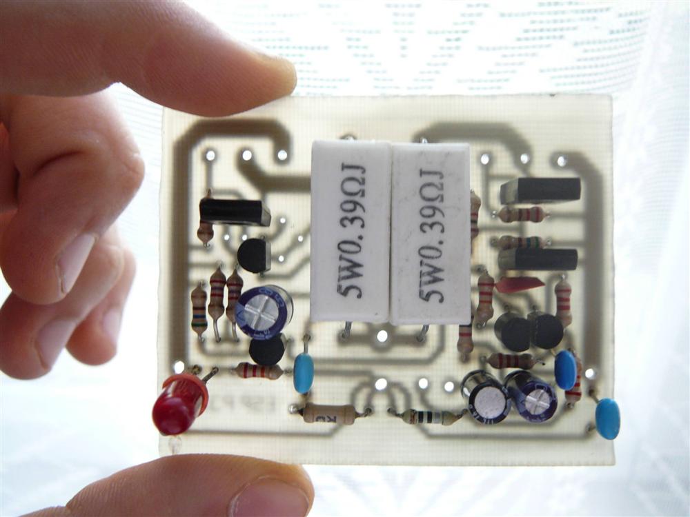

Hello, gtforme00. I like the PCB, and just my luck - I am also using Express PCB as my main design-learning program. I would appretiate it if you send me the .pcb and .sch file (used for checking the connection nets) on my email, but the forum sais that I cannot PM anybody...and you disabled your email or something, so I cant reach you. Please find me on : kalmara [at] bitex [dot] bg
p.s. I would like to see some pics of your completed PCB (or why not the whole amplifier) also, if possible.
It doesn't matter - pin locations are the same ... if you are talking about the PCB on this page. Anyways ... i dupmed the 'cheap and easy' thing and made my own P3A PCB with guidance from r!sc!`s layout and some minor modifications. I just have to get a trimpot, another 100pf and my output trans, and I'm in business ! 😀
p.s. I soldered a red led just for the test, beacause that's what I've got ... afterwards I'm going to make it legit with a green one. 😀

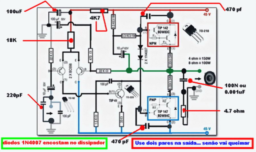

A friend from Brasil, into the Orkut, have bougth those Darlington and wants to build
I have offered him those modifications.
This will turn the amplifier more stable.
To the 18K resistance shown, use a trimpot and adjust the off set, starting with 18K and them tweak.
To avoid oscilations, because of those darlingtons, i suggest the use of 470pf capacitors...this will turn it more stable...BUT, will triangulate the wave shape into high frequencies , into top audio frequencies end.... say... sinusoidal signal enters and into the output appear triangle.

ohhh come on carlos !!!!!
make your friend a favour make him a couple of DX bords and he will ove you for the rest of his life ....
a bit of reactive load , the smalest short circuit, some overdrive and any form of abuse will kill this amp ...everybody knows that ...
if this was coming from an amature i would say nothing ....but you ????
just give him some ideas on how to construct a DX and thats it ......
none of the amps i ve seen with this idea ever worked properly un less rail voltage is like 25+25 may be then its possible ....
any way .... my best regards

Yes.... i have informed to the Brazilian friend this amplifier is dangerous
He knows that... my modifications is to avoid the explosion only.
Nobody said it is good.

I built it just for the sport ... well, It didn't start at its current condition ! I modified a bit, just using good ol' Rod's Project 03 component calculations, and guess what ... it had no problems with the powering up, and in fact - sounded very well indeed. 😎
See this, but imagine the output stage with darlingtons ... also some other minor changes :
- There was a miller cap only in VAS.
- The bias control circuit was in my case - only 2 pcs 1N4007, no Vbe multiplier. (and that's why it ran cold-blooded at 8mA bias 😀 )
- Power supply rails were +/-42V .... I had no problems at 8 ohms load for about half an hour of playing at maxxed volume - fact, the heatsink was as close to COLD as it could get. 😀 It was just fairly warm...
- Output offset was about 30-40mV or so...pretty good, concidering the parts arent exactly the same as in the circuit. (bootstrap, and base resistor for the first BC - 2k, NFB and input resistance - 18k
Untill .... i decided to make myself a kamakaze mission - and connected another 8 ohm speaker in parallel ... then after about ten minutes of playing : POOF, BANG &#$%@$#^ ...... (smell of fried Si and electrolyte) ...... (deadly silence)
What happened you'll say ... well - these are the heroes :
In your left corner - fake TIP147, in the right - fake TIP142.
As you can clearly see - the PNP darlington is a BIG fake, and probably it got loose first with the 4 ohm load, blew, took the other darlington, and beacause of this - dropped about 80V (the two rails) between the bootstrap cap's leads, and taking it with them. (the cap was for 50V)
Here's my test pcb before the blast ... it's sitting there in a lonely corner, waiting for some good darlingtons...and a bootstrap cap. (all other components are OK)
That's it for now from me .... I might come back in this thread, as soon as I find some decent POWER darlingtons ... (not fakes, and weaks like those 😛)
