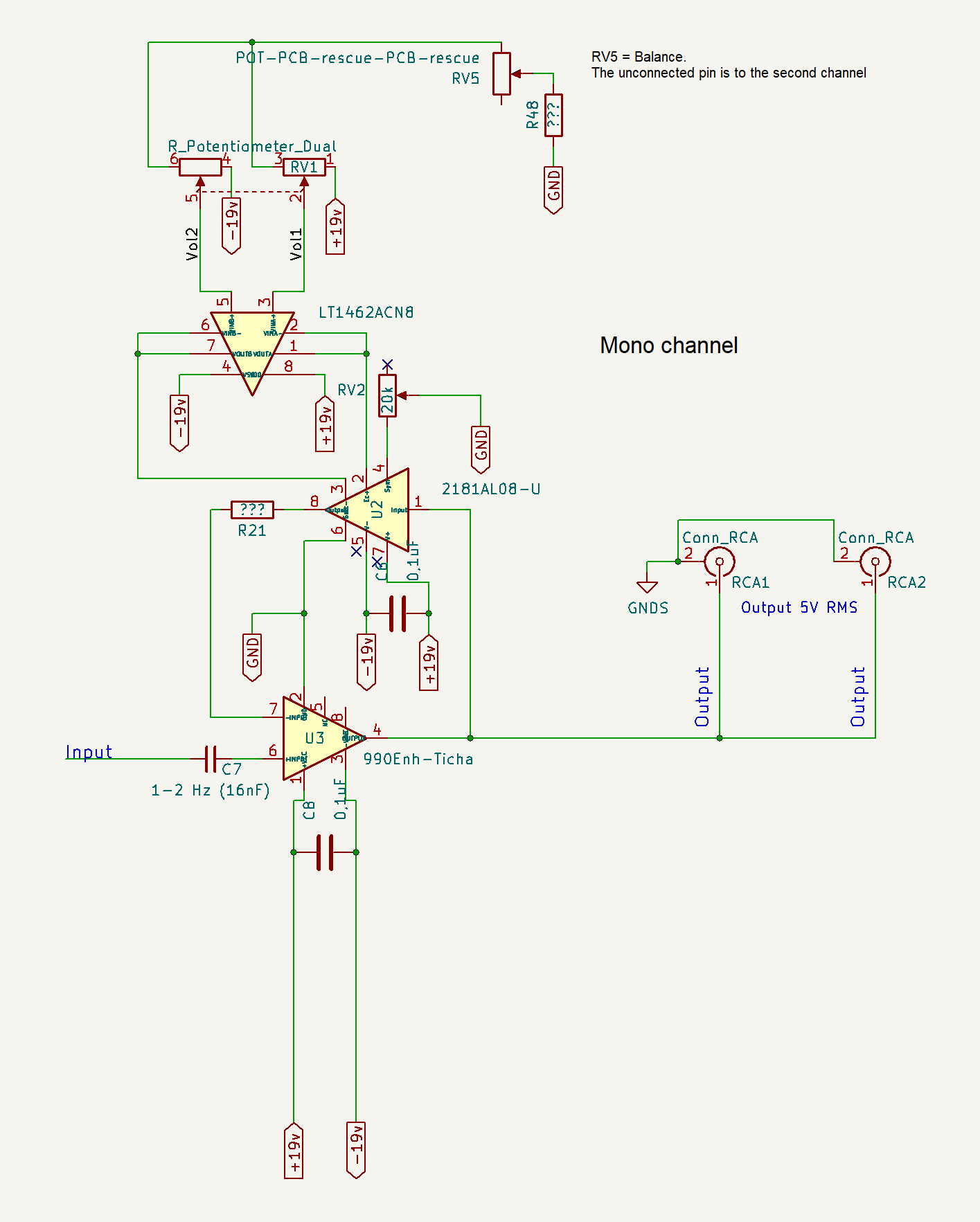

I could not leave my ChatGPT project just hanging, so I changed the rules a bit and this time was I allowed to ask leading questions and argue my case, but I was still not allowed to place any components that ChatGPT did not accept as "a great idea"
I would like for you to look for errors, I am not sure if it in fact will work correctly.

I am sorry, I may have been very unclear in what I have written. I can easily understand your reaction and your thoughts.
I'll try to formulate my question a bit better🙂
Is this a sane way to design the circuit, I know my constraints did some of it, but I do not think I have seen a design like that before.
I am not unsure about noise, but I am unsure about its performance, "if it will work", meaning is it pure stupid or is there some sanity behind?
An op-amp with an VCR in the feedback with a buffer and a pot. Will it work correctly, as a "damaged pot does not influence the sound"?

I don't seem to get the purpose of this experiment...
Anyway, circuit won't work at all, for very obvious reasons:
  • OpAmp has no bias
  • VCA is hooked up completely wrong. This is a current input/output device with input and output at to operated virtual GND, so an AC-coupled resistor must be used as V/I and an opamp as I/V. Hence, no DC feedback and the polarity is inverted, too... wrong way...

I'm still quite impressed... the AI must have been using a tool to draw this? Or did it find these schematics in a dark corner of the internet? If it indeed started up the tool, drew the components and took the requirement into consideration, it is quite a feat for a "machine" in its infancy.
The drawing is unfortunately made by me, from description and some primitive drawings on ChatGPT.
I am also a bit impressed because the AI did all that from different text documents and managed to combine across the articles it has been trained on.

I am not sure if I understand your comment?
Could you please add some details to make it easier to get hold on?
