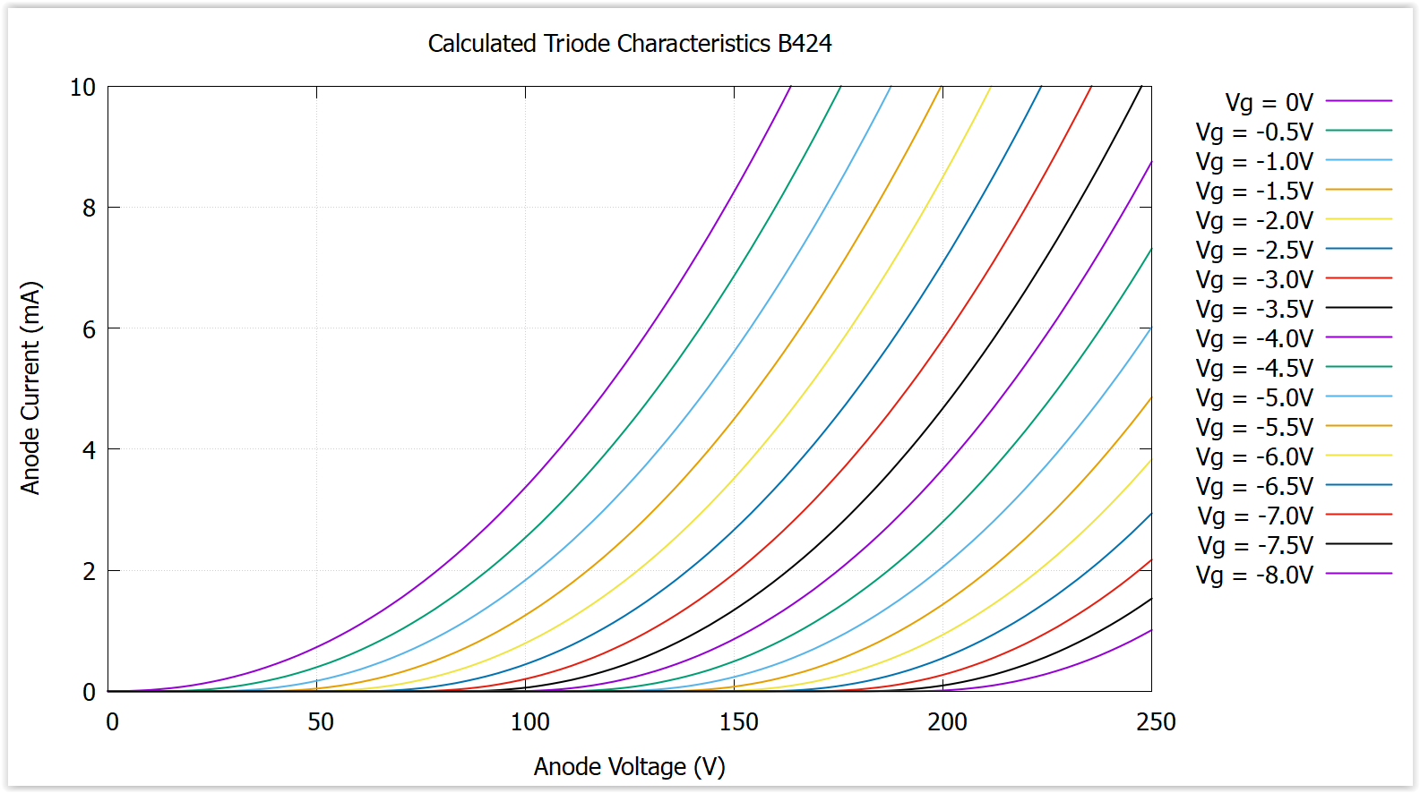

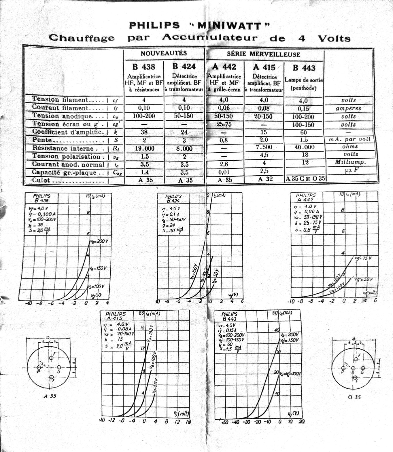

I'm trying to locate triode curves for a vintage B424 triode tube. All I found were curves with the grid voltage versus anode current. I would rather like to have a set of grid curves with anode current versus anode voltage. As this is more easy to work with for me. So I decided to give ChatGPT a try. After some initial discussions with ChatGPT on how to get the curves printed, ChatGPT suggest to download and install GNUPlot. This can be downloaded for free from https://sourceforge.net/projects/gnuplot/files/gnuplot/
In order to get accurate triode curves it turned out that it is most helpful to give ChatGPT a list with triode data points derived from the odd graph on the old tube data sheet.

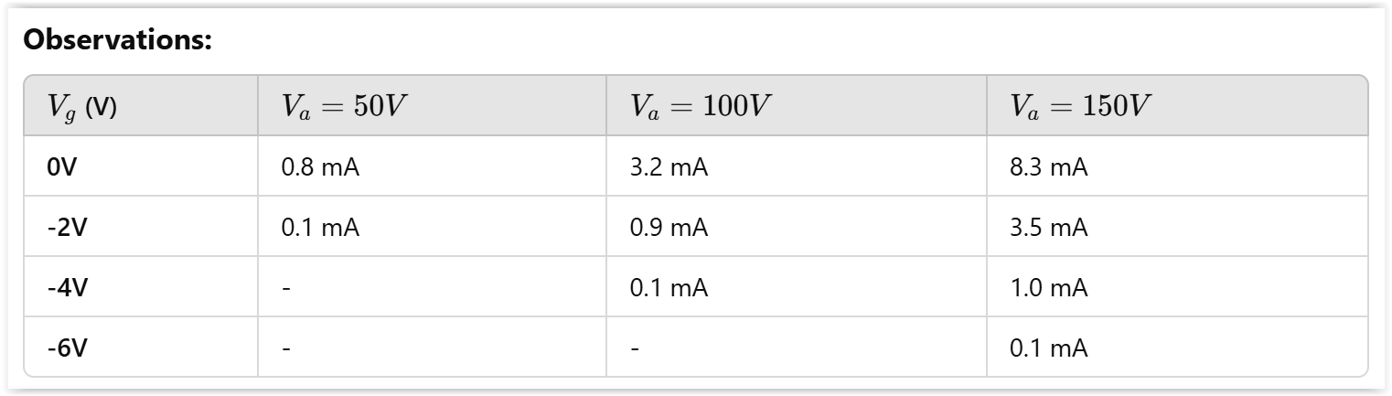

The triode properties are S=3.0 mA/V mu=24 Ri=8kOhm for the curves max anode voltage 250V, max anode current 10 ma and negtive grid voltage between 0 and -8 V in steps of -0.5V. The measurements are as follows at grid voltage 0 volt at anode voltage 50V 0.8 mA - 100V 3.2 mA - 150V -8.3 ma. At grid voltage -2V at anode voltage 50V 0.1ma - 100V 0.9 mA and 150 V 3.5 mA. At grid voltage -4 V and anode voltage 100V 0.1 mA - 150V - 1.0 ma. At gid voltage -6 V and anode voltage of 150 V 0.1mA anode current. Can you calculate a similar triode curve model for me ?

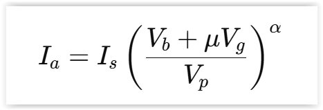

We’ll use the same empirical formula:​
Ia=Is(Vb+μVgVp)αI_a = I_s \left( \frac{V_b + \mu V_g}{V_p} \right)^{\alpha}

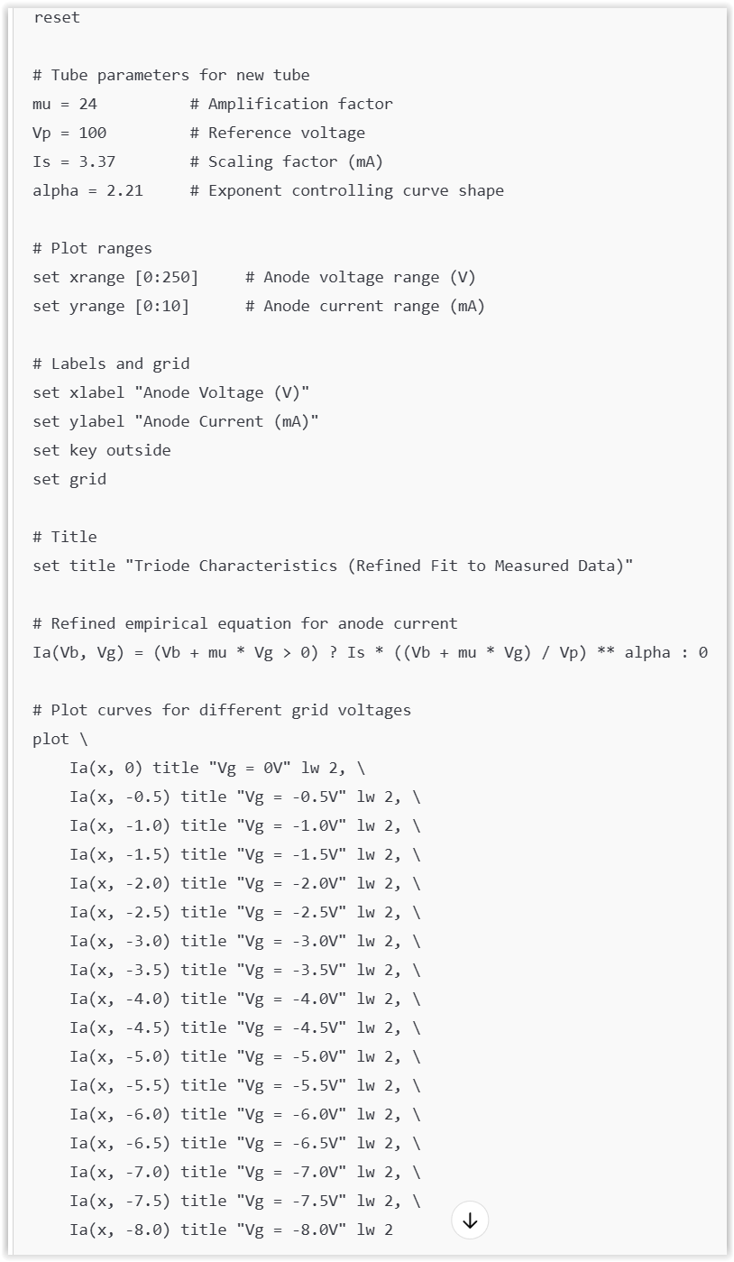

Step 4: Updated GNUplot Script
Now, let's update the triode current equation in the GNUplot script for this new tube:
This file was cut and pasted into Microsoft Notebook and saved as b424.plt in the documents folder.
You then open GNUplot and type at the command prompt load 'b424.plt' and press enter.
A window with the plotted curves will open.
You then check if the data points you took fit the curves.
The fit was pretty accurate.

This is the code ChatGPT generated to draw the triode curves for the B424 tube. You can use this file to test your GNUplot version. You can also upload this (cut and paste form Notebook) to ChatGNU and tell it that you like a triode curve model comparable with this earlier generated code. Might save time to get the required results for other triode tubes.
