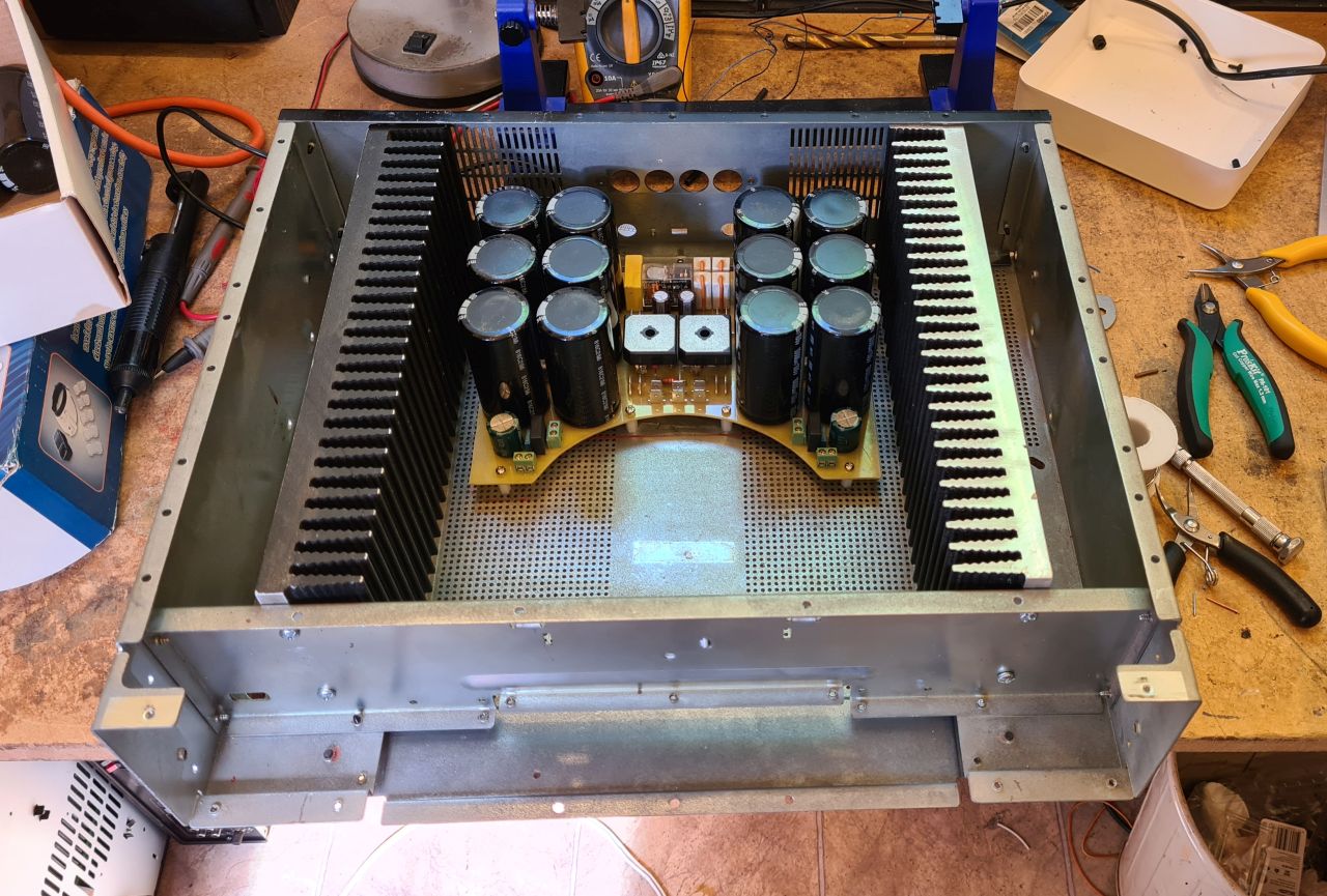

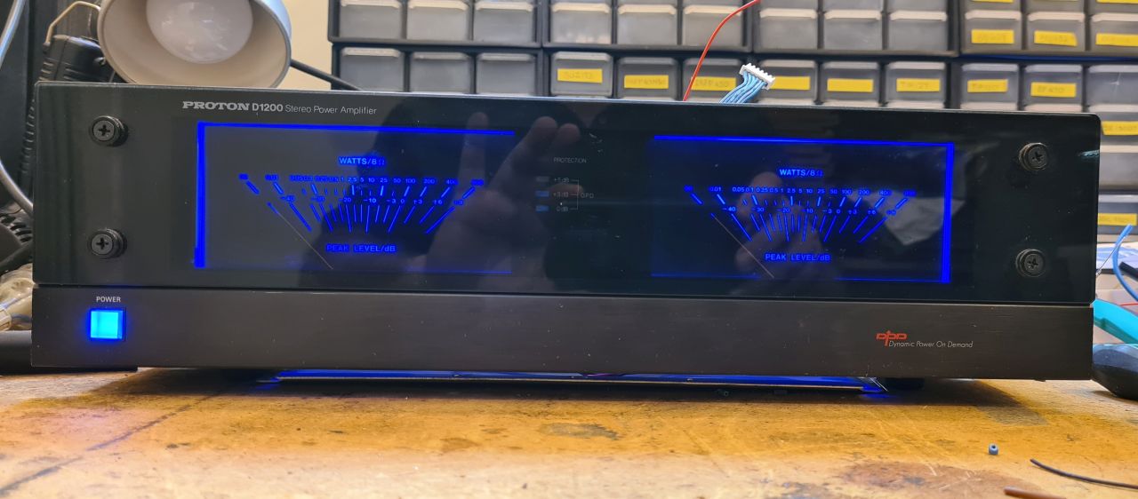

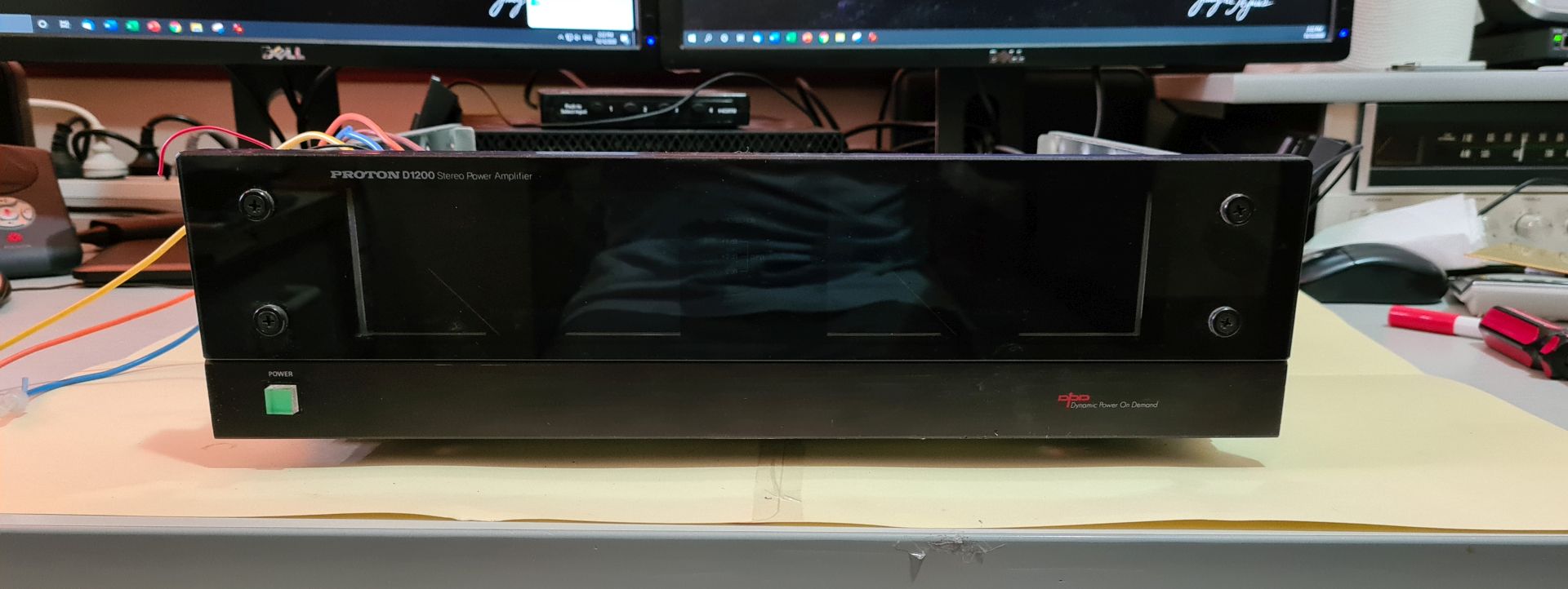

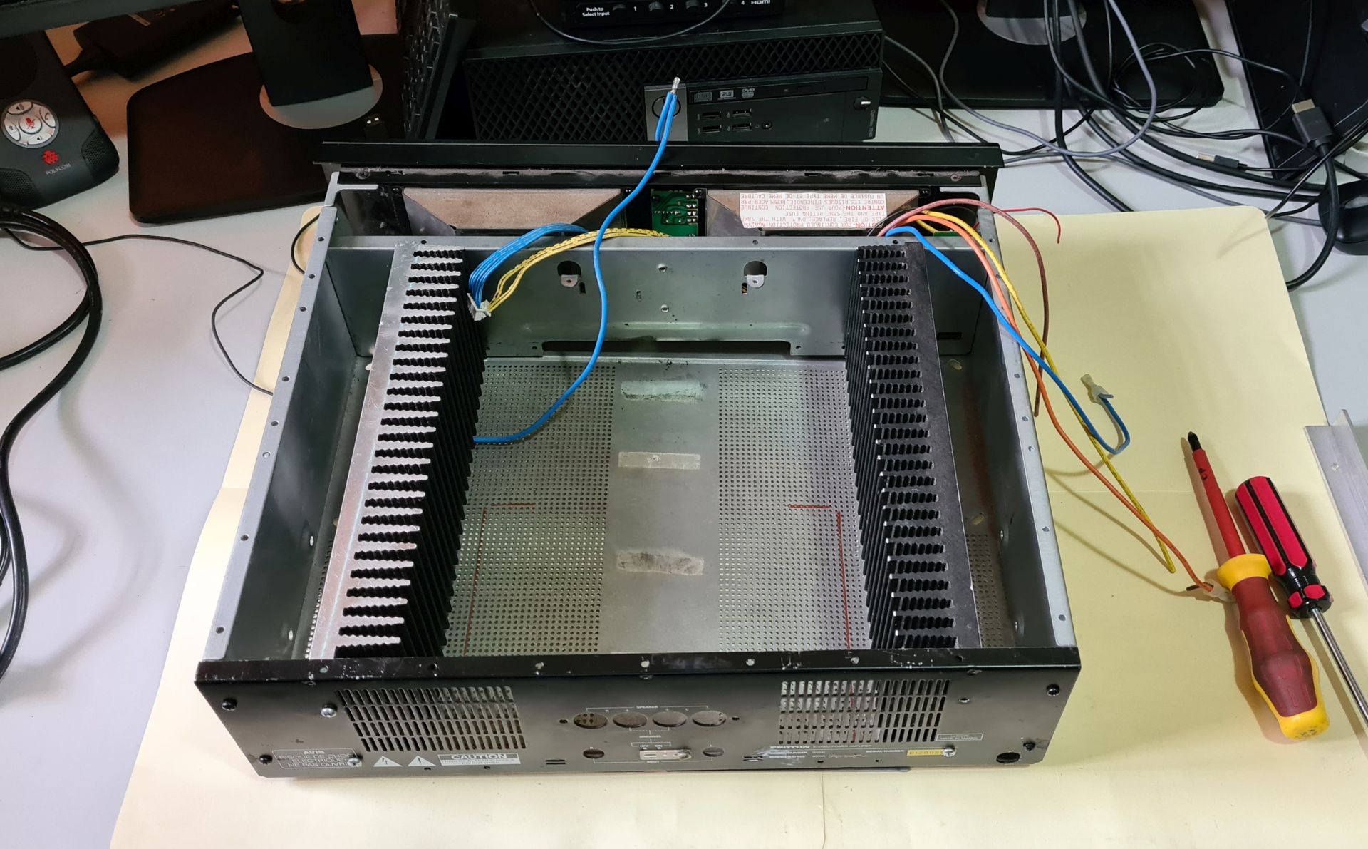

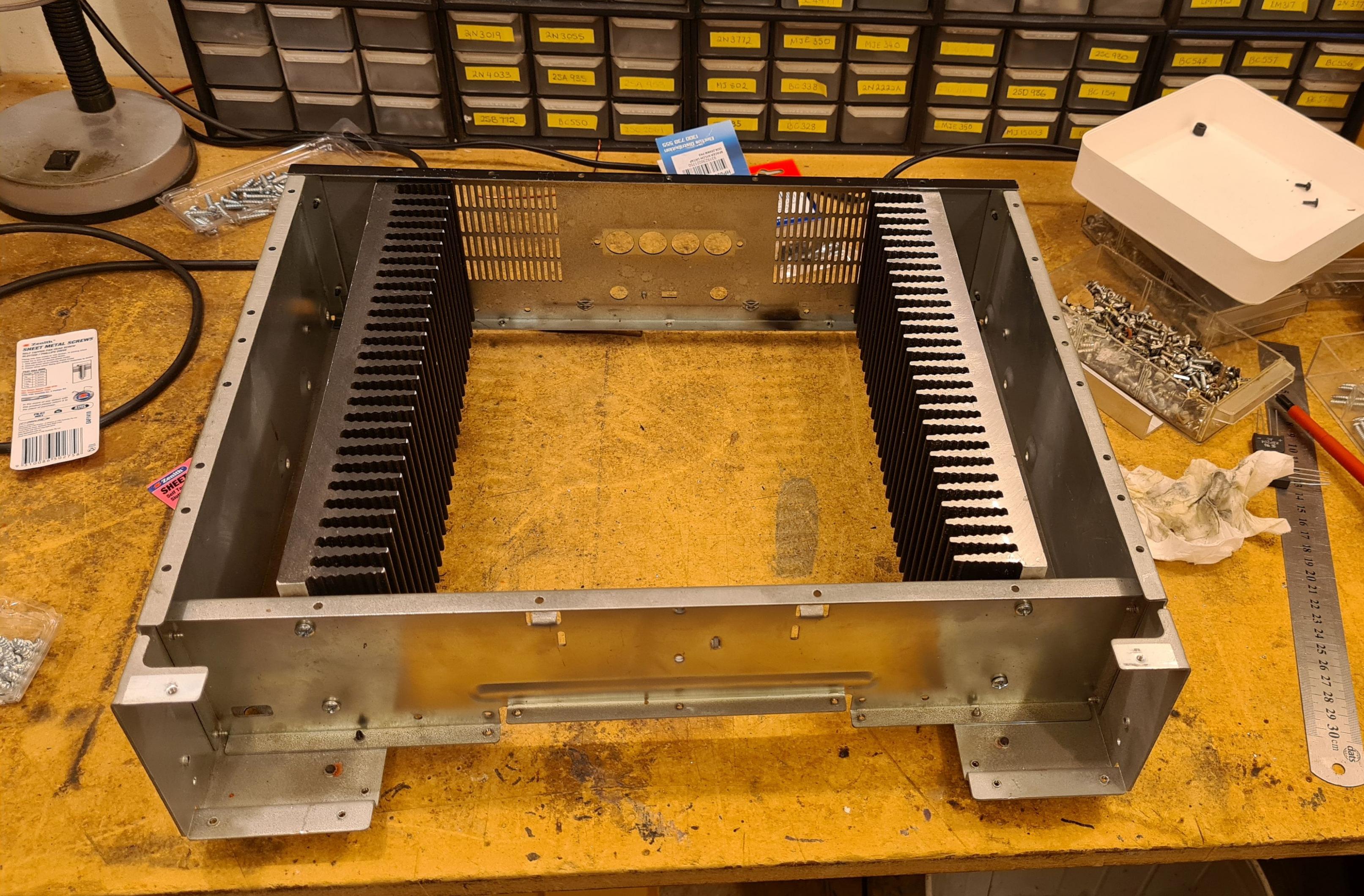

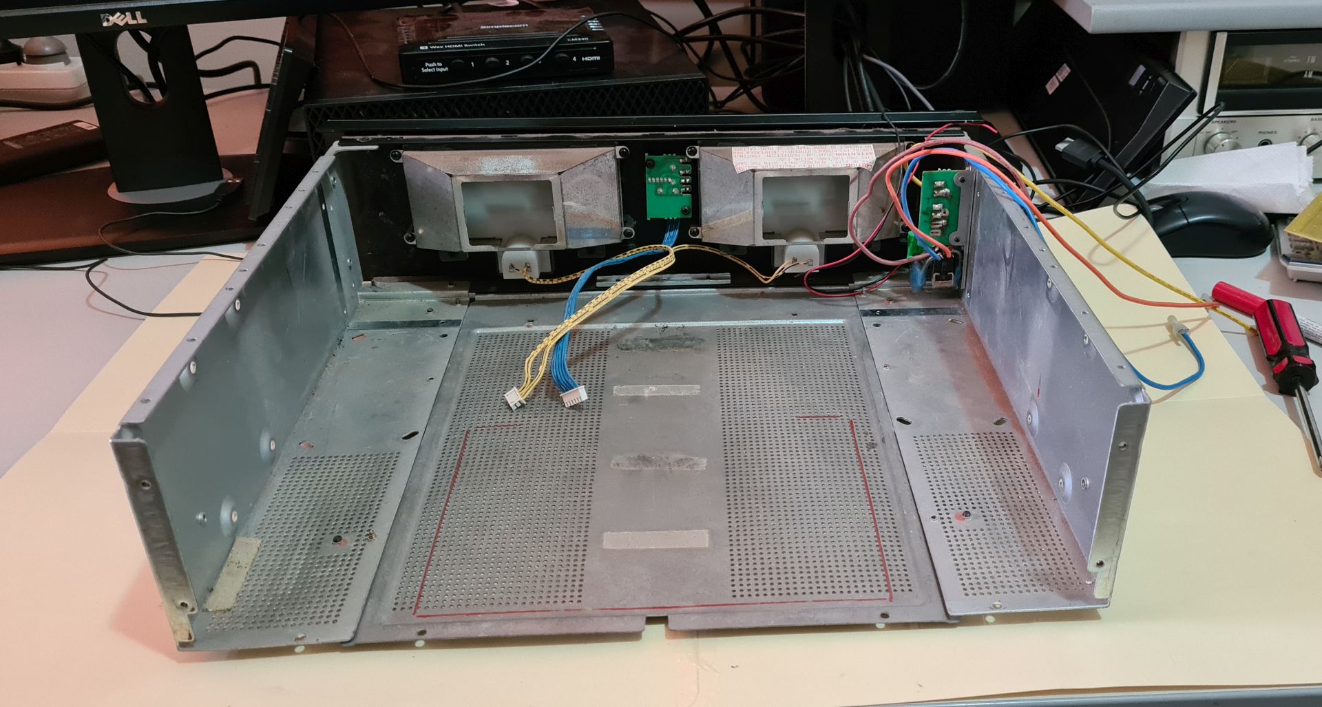

Work so far - the chassis works
Luckily the chassis is in pretty good condition and the VU meters are still there and working! Members who own a working D1200 may not be happy at this stage but an empty chassis is what it is.

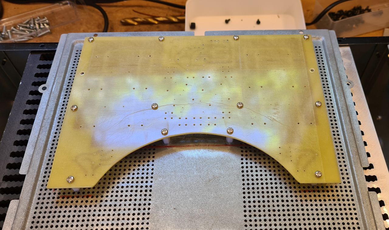

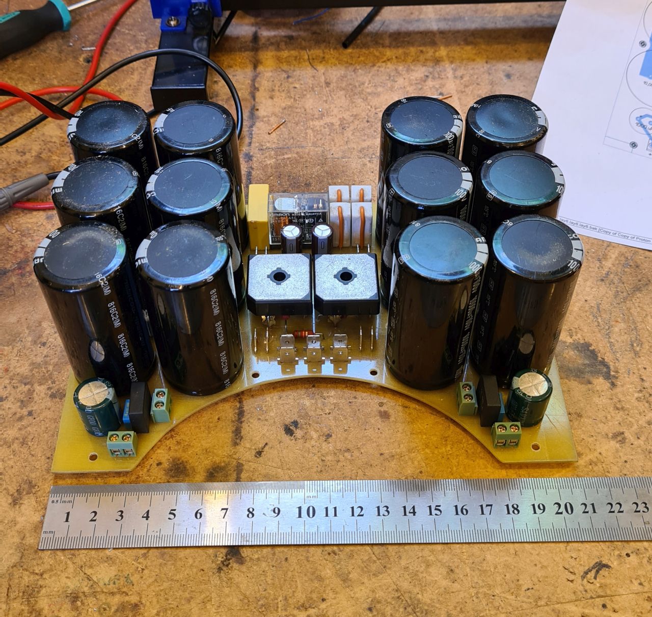

Work so far - Power supply

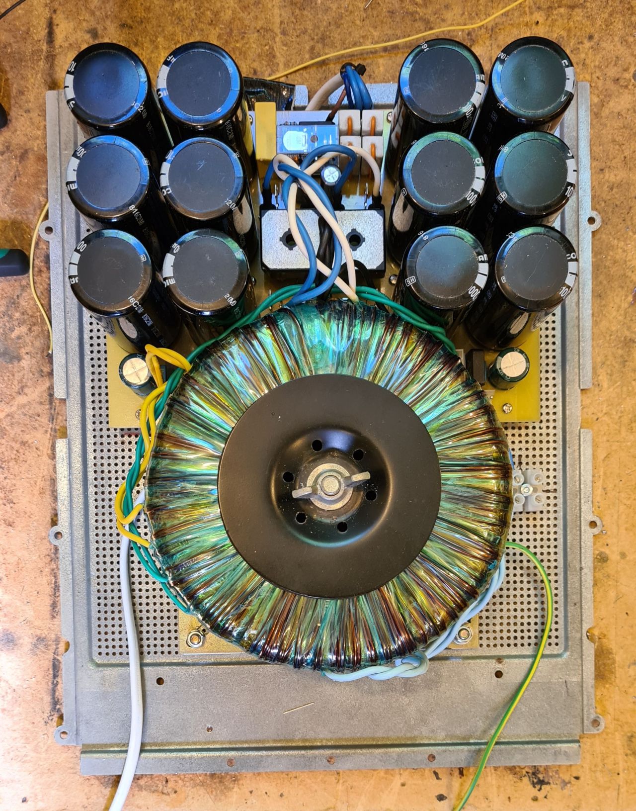

I designed the power supply to fit partway around a large toroid xfmr. Main rails will be +/- 82v with 2 ancillary DC supplies of +10v and +24v. The ancillary supplies will power the DC protect ccts, the VU meters and backlighting plus the 3 level LEDs (0db +3db +6dB).
Soft start cct is also on board. This one is straight from Elektor with some modification - simple as and works a treat.
The amp should deliver around 320 watts per channel into 8.

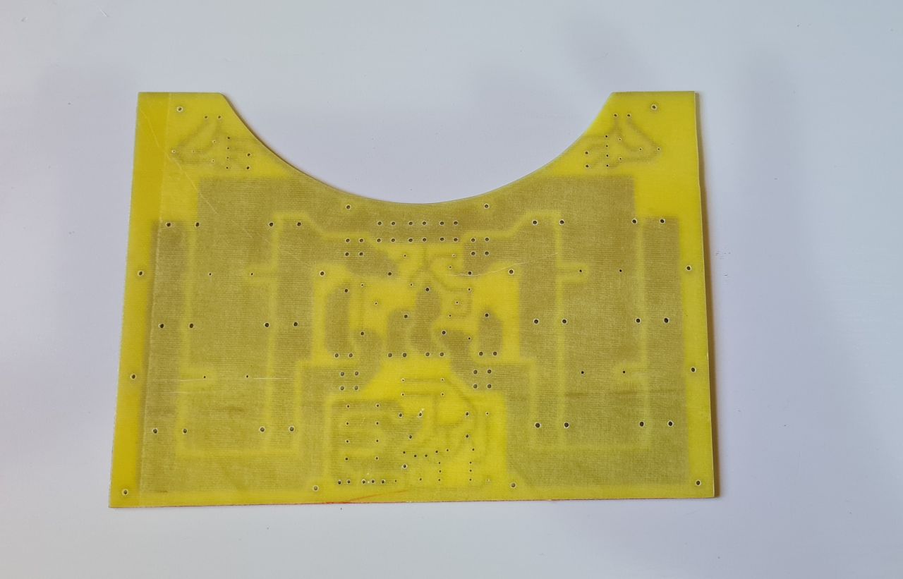

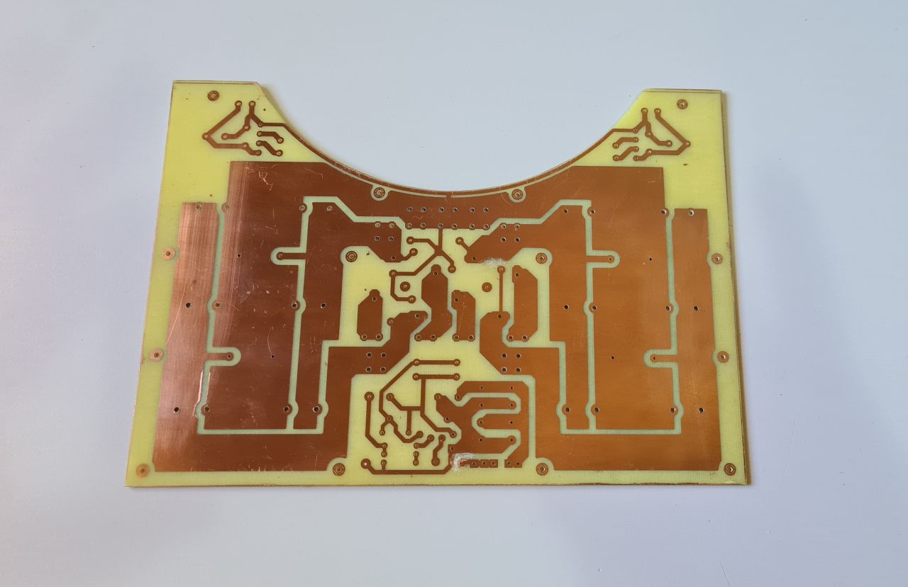

A couple of adjustments on the PCB where exposure / etching didn't work that well. DIY rules apply.

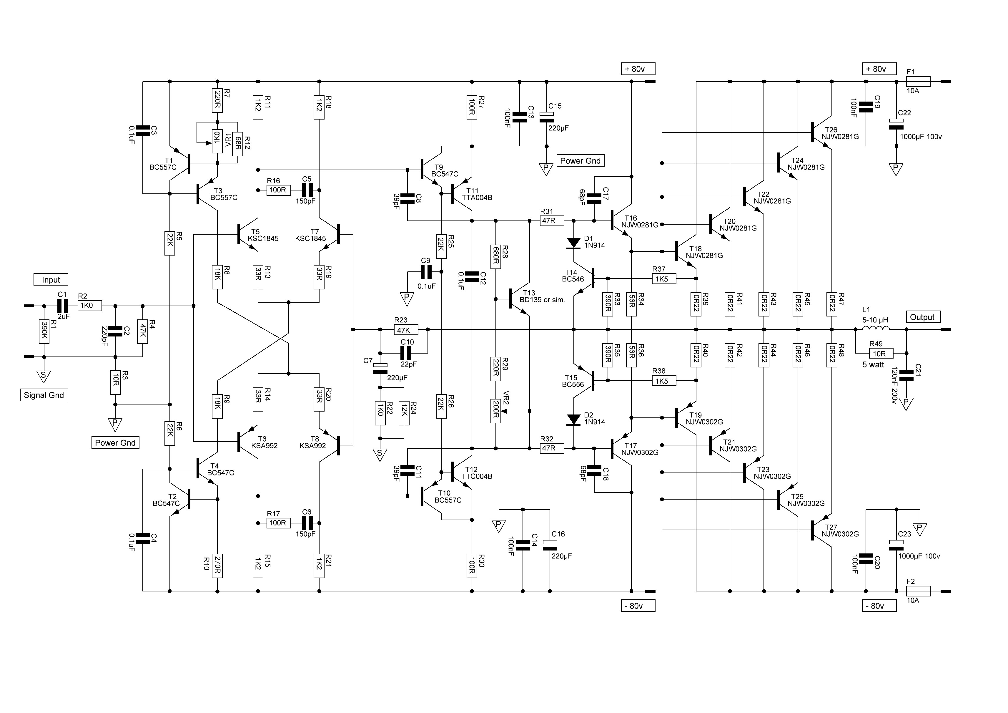

No to the amp modules.
This is the schematic that I think I will be going with. I have drafts of it around in other posts and with the help of a few members have arrived at this version.
The PCB's are made so other than some component values, I don't anticipate too many changes. Of course I've been wrong before.
The PCBs have provision for a separate feed to the output stage and this allows for cleaner current delivery to the first few stages. It could also connect the first few stages to slightly higher rails - gaining some efficiency.
So where to from here?
I now need to build the amp modules. The amp schematic SIMs rather well but the real world could be different. Hopefully all the research, help and adjustments pay off.

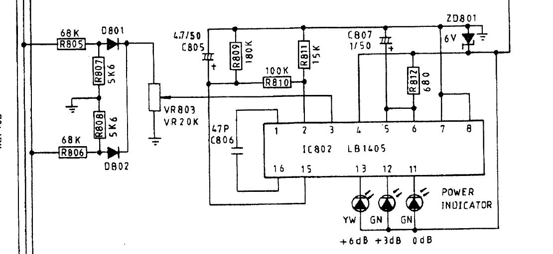

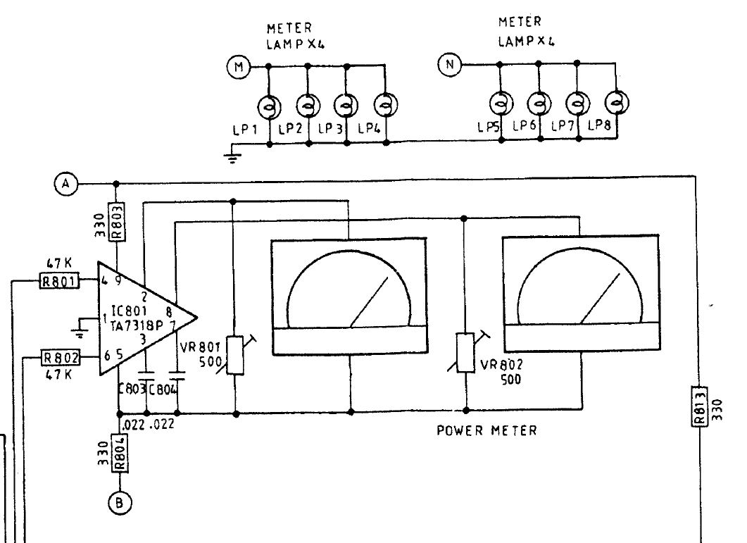

I also have to re-create elements of the original Proton features; the VU drivers and LED power indicators.
I had trouble finding a TA7318P so I purchased a pre-built VU driver PCB to do the job. I also purchased a LB1405 LED VU driver to make my own PCB with. Both of these from Ali-Express so wish me luck.
So unlike the Proton big main board, this will be assembled with several discreet modules. Hope it all fits!
