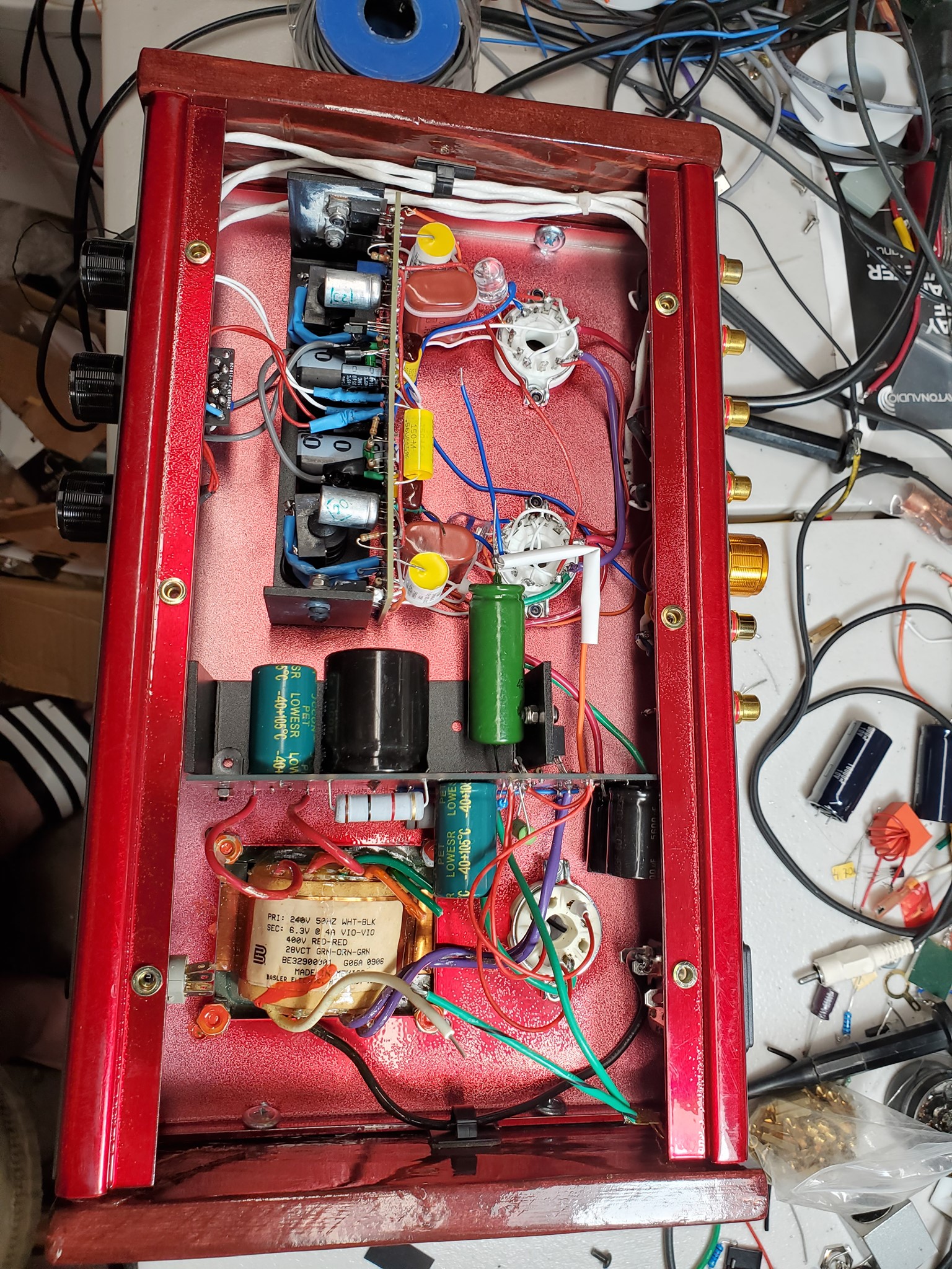

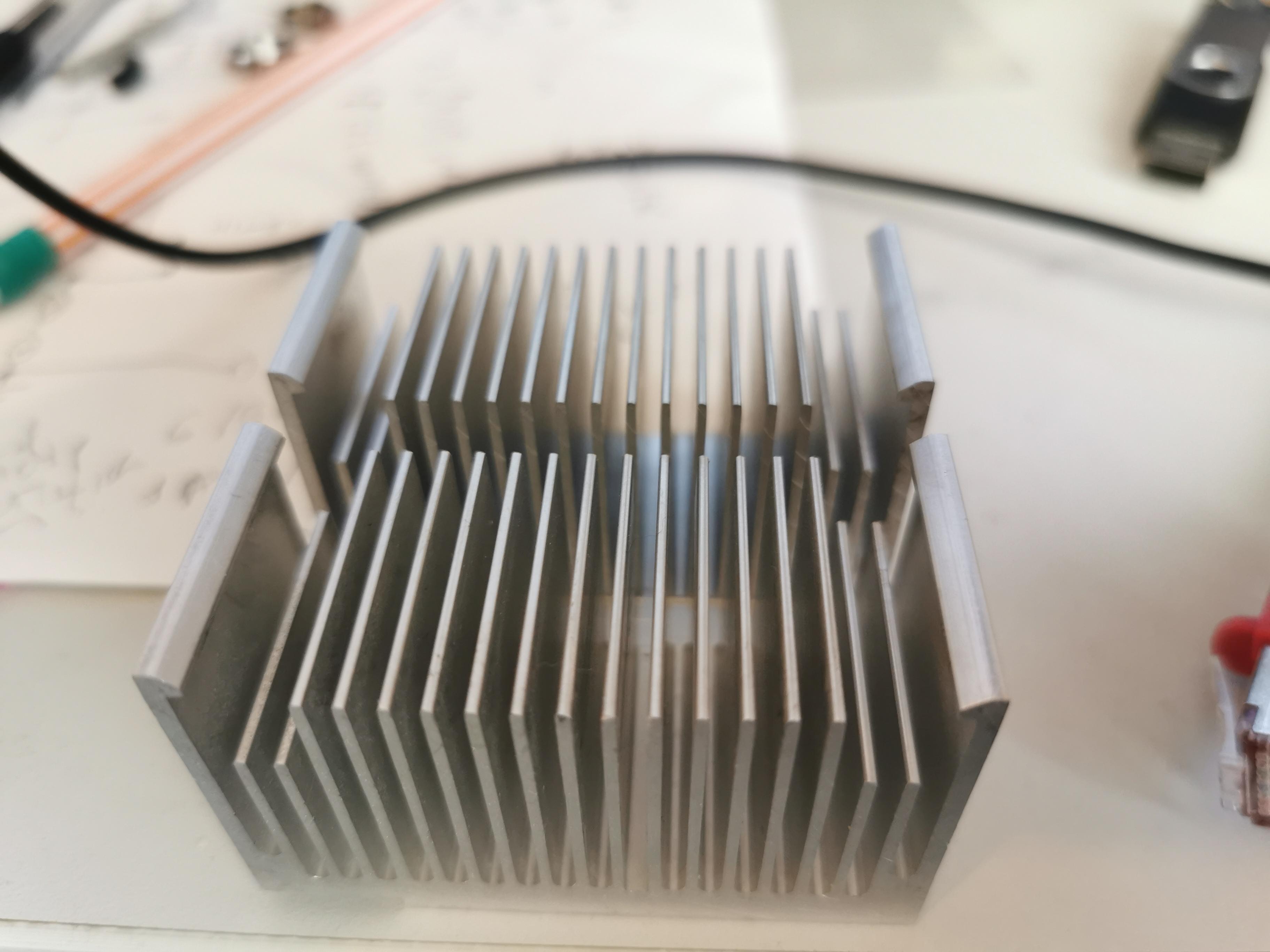

I use П-shape heatsinks bolted to aluminum chassis
If some thingy is called "heatsink" it does not mean that it works better. It has own area, the smaller, the higher is the thermal resistance between it and an air. Also, if it is installed on a board, the board closes convection path. Then, most of them that I see on DIY pictures, were designed for forced air cooling, too small distances between fins to be optimal. And finally, the heat dissipated by them must some how go from under the chassis.

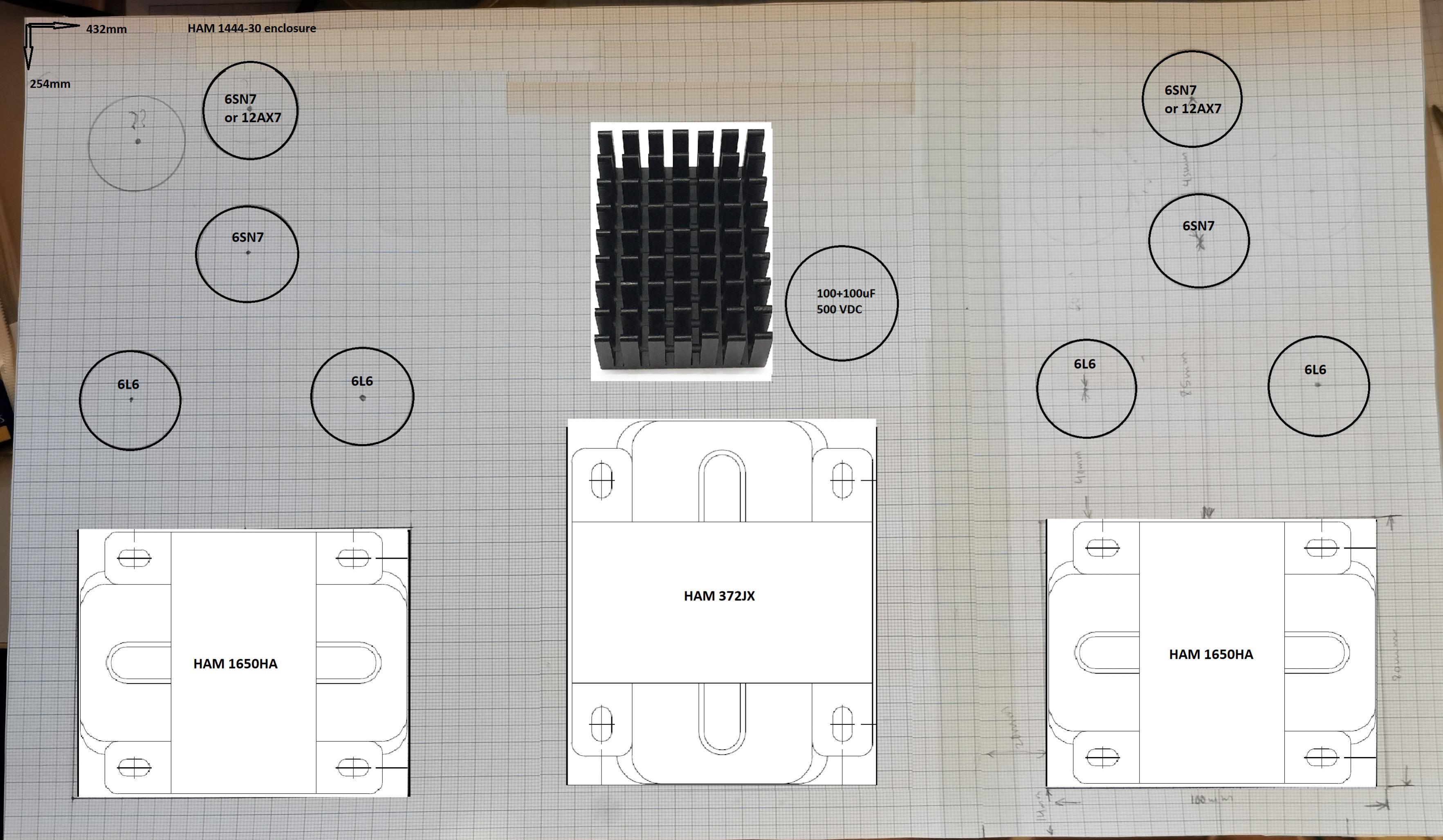

I'm using an aluminium chassis, 17x10x2 inches, 1.5mm thick sheet. I expect the dissipation to be 8W or less based on screen current datasheets, let's say 100V across, 80mA max for an AB1 6L6GC stereo amp. I will now better when I build the thing 🙂

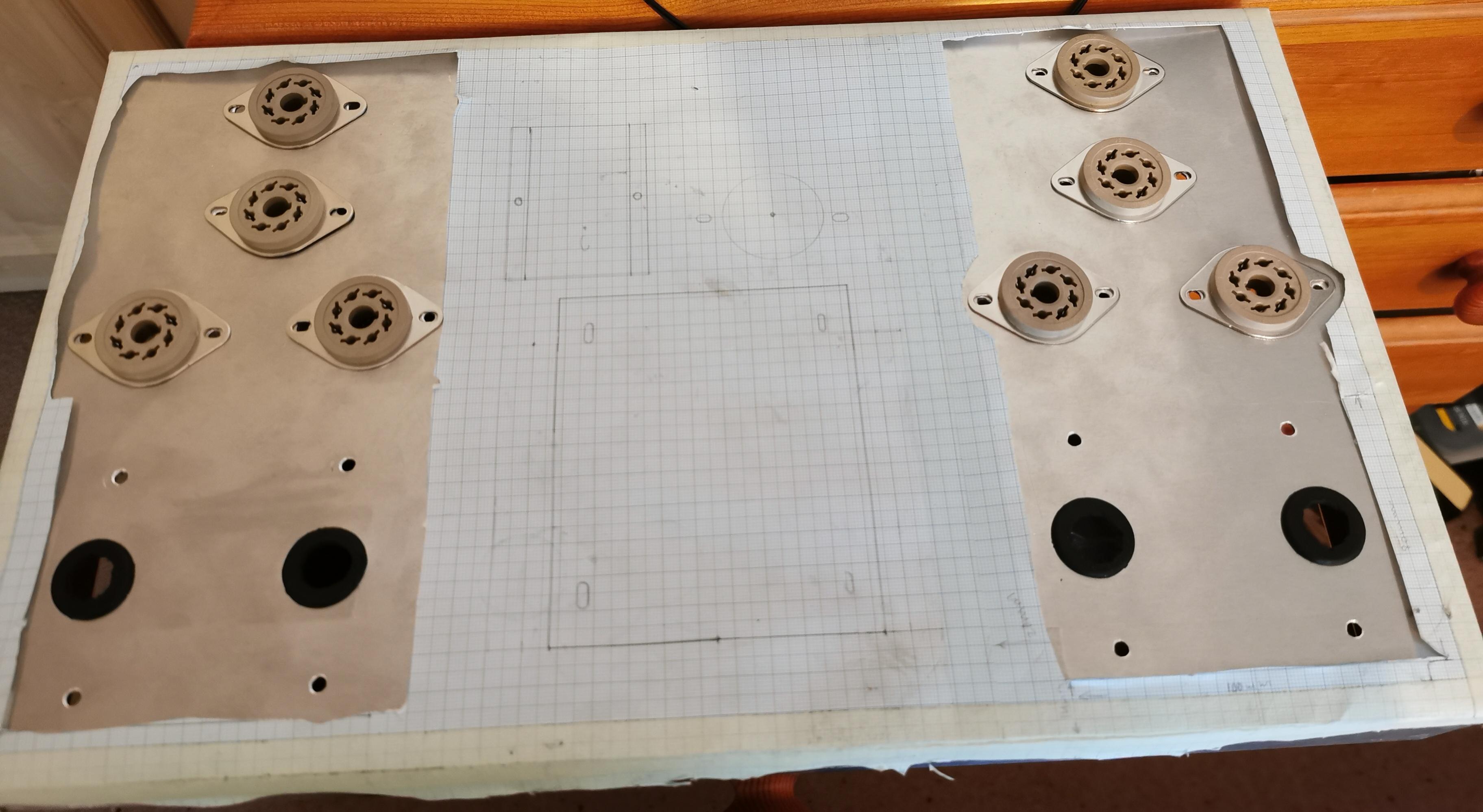

I agree with you, I will definitely not put heatsinks inside the chassis, the thermals would be horrible. I was planning to use an old CPU heatsink, bolted on top of the chassis, and the transistors attached from the bottom side, through a rectangular opening. But I'm sick of drilling and cutting 🙁

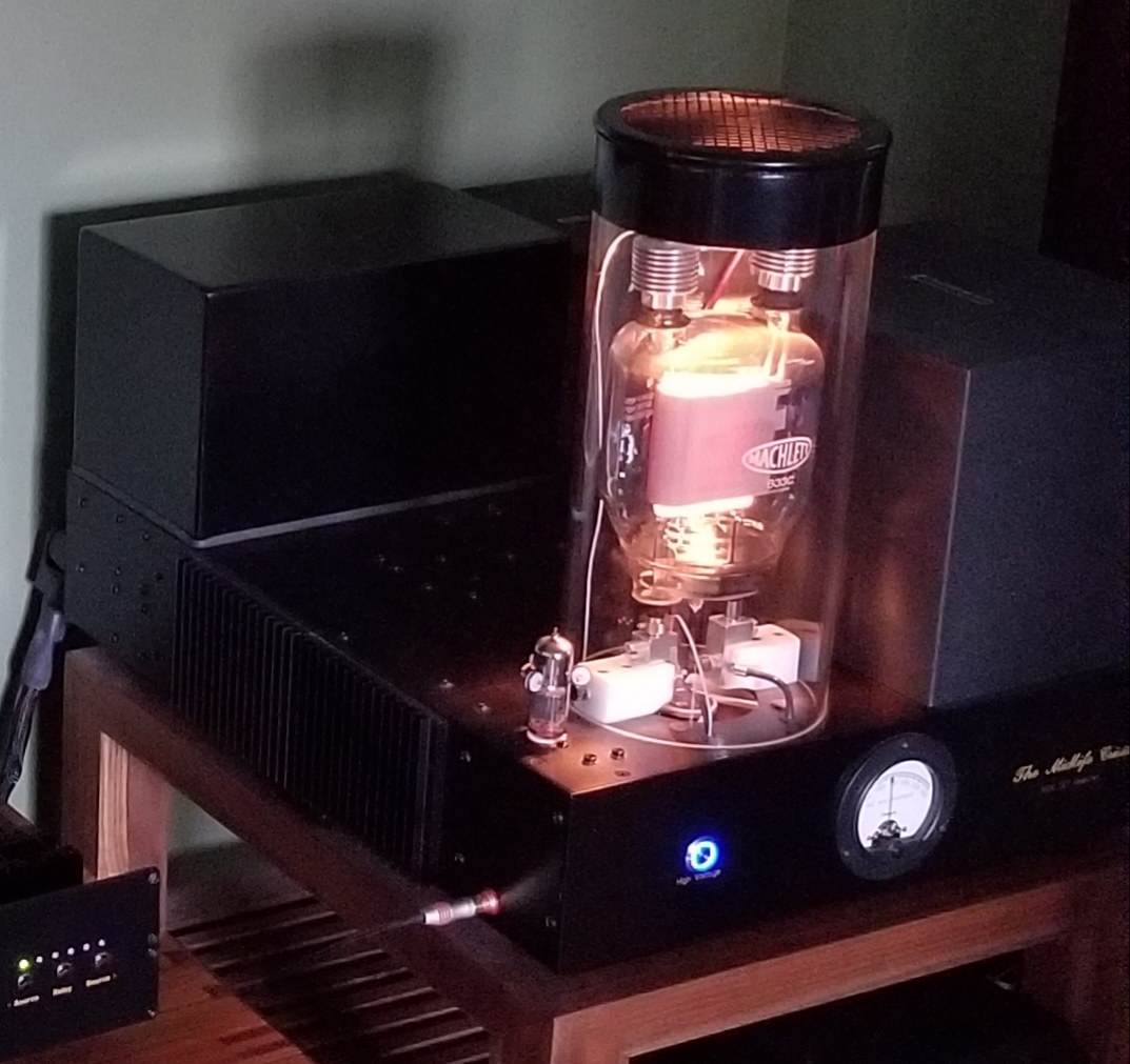

I have a MOSFET dissipating about 45W under the 833C in my amps. It is attached to the inside of the chassis side extrusion with clips, and finned heatsinks are mounted on the outside of the chassis side extrusion in the same location. So both the chassis and the heatsinks dissipate the heat. See the finned heatsinks on the left side of the chassis in this picture.
Wow, that's a beauty, thanks for the photo! :up:
When oriented such a way it becomes much less efficient that when the convection path is open all the way along the fins, when hot air goes up through the bottom to the top of them. And the optimal distance between fins for convection cooling is 8 mm. For forced air they are denser. Look how they are installed in professional equipment. Either at the rear panel, or inside between bottom and top covers with vent holes.
The area is good for 8W, but 1.5mm thickness can make a single TO-220 hotter than optimum.
If you have two packages, spaced out across the chassis it's OK. If you have one TO-220, a heat 'spreader-bar' is helpful to keep the junction temperature down. You can get pieces of 5mm thick alu on ebay. Even 50mm x 100mm will help.
TO-220FP packages can have high Theta-JC (thermal resistance from junction to case). 6 °C per Watt is quite common.
Example: If the heatsink surface is at 45 °C, with 8W to dissipate: the junction will rise maybe 48 °C for the package, and another 10-12 °C for the heatsink interface (using thermal grease). That's 105 °C for this example - already a bit uncomfortable for high reliability. High voltage FETs in the standard TO-220 package can easily achieve theta-JC of 0.5 to 0.9 °C/W. The high voltage is no problem if clips are used instead of screws, to mount the transistor.
