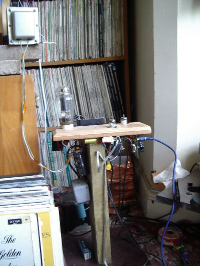

I can't offer anything quantitative to substantiate this, other than to invite anyone interested to play around with the internal wiring of a high-gain guitar amp. you can hear the hum increase as sensitive wires near the chassis, and heater wires couple to the metal. OK, some of these designers actually run power-stage currents THROUGH the chassis (Marshall), but I suspect there is something to watch out for.
My personal preference is for wood. Dry it out properly (and preferably seal it) and it presents a very reasonable dielectric.
I use pieces of copper-clad FR4 to build each individual stage, then wire them together on the wood platform. The whole lot stands above the power supply on a chunk of 2x4 (50x75mm roof timber).
You don't need to screen any stage (even MC cartridge inputs) if you keep all the wiring loops VERY small - and the wiring between stages twisted.
The picture shows my B.300B-SE.
you can see the power supply at the distant right, covered in copper foil to limit emissions from the 6CJ3/UF4007 hybrid rectifier.
The output transformer is remote from the amp, mounted on the loudspeaker support - even a 300B output valve picks up the emissions from these (unless you have a toroidal) - and better still, I don't need any speaker cables, or need to get into any endless argument about which kind work best!!😀
