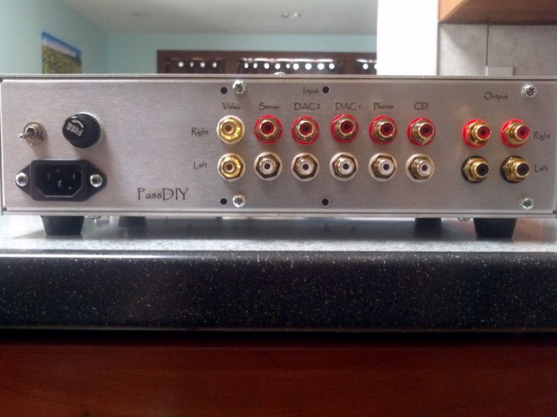

Looks great Vince, have you coated the decal with anything after applying?
Thanks. Someone suggested spraying clear coat and I think its a good idea because off axis the brush on clear coat shows much more. A complete, even coat on the face would be better.
Thanks for all your suggestions. Much appreciated.
Vince
