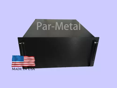

Most of the products bought even from 'reputable companies' suck. I went through a slew of brands and experiences until I found a company that sold at least decent, heavy metal steel chassis with an aluminum front and rear. Yes there are more expensive ones there for a 50% increase in price above these and are worth it too if you got the money, but I have found no need to make excuses for these:
Par metal designs on eBay. I have this one sitting on my bench right now deciding where to drill the first few holes. They can customize if you like too.
This one cost me $189 shipped to my door and is 4U X 19" W X maybe about 16" D

Sorry for the delay.Could you comment on quality of machining, finishing of edges, packaging, etc.? Did the package sneak through customs, or were you charged anything?
The quality is supreme as is most enclosures from China in my experience. The system of bolts and thread taps is insufficient to load it up to 80 pounds of amplifier that it will become when it is finished. Mechanical enhancements are in order, I'm working on them right now. It needs to be 'beefed' up. I do not have a problem with that at all.
The packaging was funny and weird. It was very 'hodgepodge' and home brew-ish. I was a bit disappointed when I unpacked it. I thought there to be damages on the faces of the aluminum plates. Meh, it was fine in the end.
Nothing sneeks through customs. We(Canada) have trade agreements in place that cover all the stuff we use in this hobby from many countries. It was shipped to be received by Canada Post. They opened it up for inspection at some point and taped it together and sent it to me as per normal. No extra charges.
