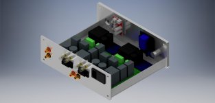

I'm building an amplifier with 2 IRS2092s modules and 2 500w dual 65v power supplies, a speaker protection module and a volume control module.
My question is this: How and where should I ground the internal electronics to the case?
Should I isolate all the modules from the chassis, and have only one ground connection directly to the chassis straight from the AC input? Or should I ground the power supplies and amplifier modules separately to the aluminium chassis?

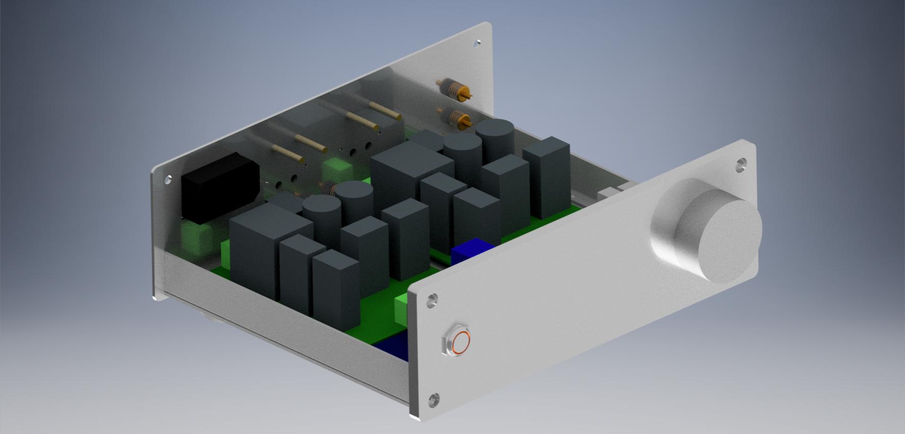

This is information I can work with. Thanks for taking the time to answer my question in depth!
My power supplies are indeed SMPS. I'm building the enclosure from scratch. Aluminium is not anodized (yet), and I plan on using a copper screw to ground the earth from the AC outlet to the chassis.
I have already tested one half of the amplifier (one ps and one amp) with both the power supply and amplifier floating. There seemed to be a sleight humm, but the improvised audio input wires might have been the culprit for that.
Here's the design I worked out in Autodesk Inventor.
I really wish I left myself more room for cables, but I already had the aluminium cut to size. No turning back now!

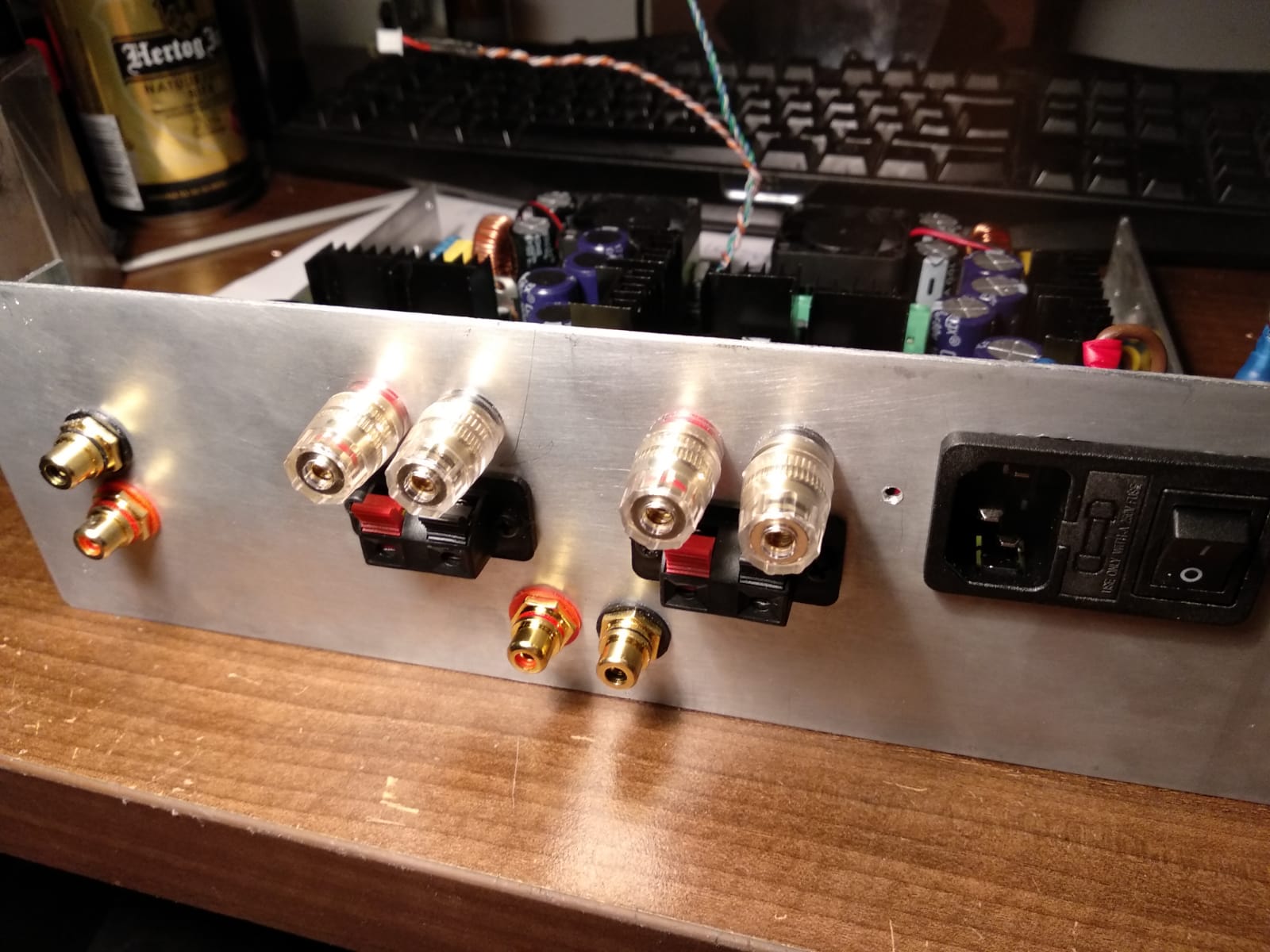

Update on the amplifier build.
During testing something went horribly wrong...
The setup is 2 SMPS's and to mono IRS2092s boards with a speaker protection board on the outputs. Speaker protection board is not in the picture
I was only testing one channel, but the other power supply and amp module where connected to power.
There was a short on the speaker outputs to the chassis. A lot of noise happened, and some smoke from the amp module.
As far as grounding I currently I only have the AC earth connected to the chassis at the power input socket.
The amplifier module seems to be still working, altough it sounds muffled and is missing a lot on the top end of the audio spectrum. I do not know if this is from the damage or if this module was already sounding like that before.
However.... My PC does not have any sound anymore. Not with other speakers or headphones. It seems my soundcard is fried :(
Any recommendations, tips or explainations are very welcome
