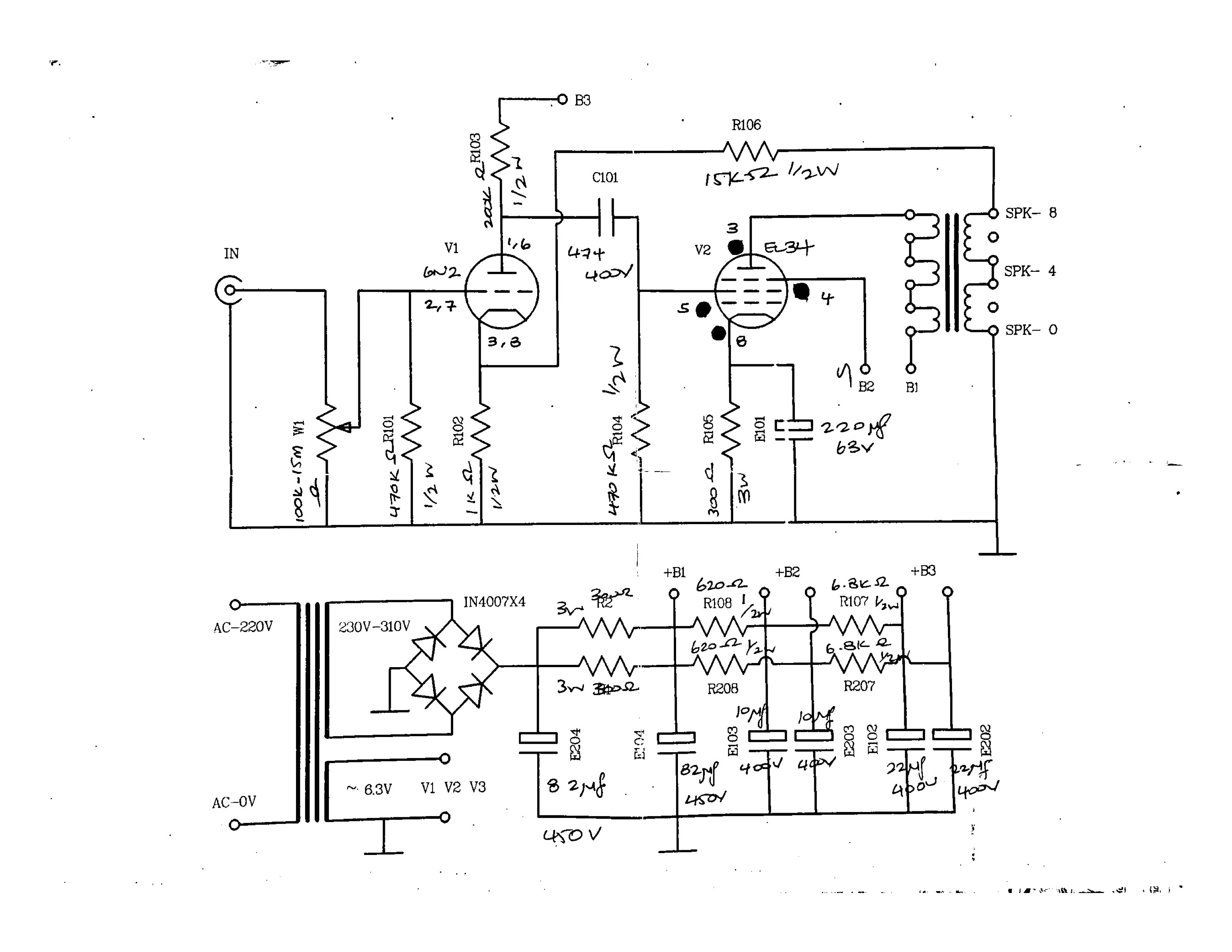

I've been building an enclosure for my tube amp and ran into some contradictory information regarding chassis grounding, so I figured I'd ask the experts.
My enclosure has a wooden frame with a couple of sheet metal (zinc) plates for the top (where the sockets are) and the back panel (where all the audio connectors are). From what I have read, it is common for these metal chassis plates to be attached to the earth connection on a 3-prong cable. I just want to be sure that I won't be introducing additional noise or the possibility of an electrified chassis by attaching the ground side of the amplifier to earth.
I attached the schematic below. Thank you for any and all help!

Connecting the chassies to ground ( 3-rd connector ) is the safest solution.
BUT do not ever connect chassies to any of the mains leads, even if one is
ground at your place, moving the amp will create a death trap.
Yes, ground loops may be introduced, but that is helped by grounding other
stuff too, and possibly loosening the signal ground <> chassies ground.
A small resistor of 100 ohm might do wonders !
Zinc plates, how did you end up with that?
For multiple plates and wood sides, get everything mounted together and use your meter to be sure that the plates show continuity to each other. You may find using some steel L-brackets between the plates will help with this.
For earthing, where your wall power comes into the amp, connect the earth wire to the chassis as close as is reasonably possible to where the mains enters the chassis.
For your audio ground, you want the entire ground (bus or star) to only connect to the chassis in one spot. You may find it very helpful to use a resistor between audio ground and the chassis, or a pair of antiphase diodes with a 0.1uF ceramic cap across them, or all four.
Thank you all for the helpful replies. I will:
-Connect both chassis panels and ensure there is continuity between them
-Connect earth to the chassis panel as soon as it comes in from the mains
-Connect the audio ground to the chassis ground in one location with a 100 ohm resistor in between

Only use a resistor is you encounter hum and need a solution (which this may provide).
I tie Earth (house ground) to the chassis at the IEC connector, Signal ground to chassis at the RCA jacks, and heater/b+ return (power ground) to the chassis (like in the 1950's...) and have no hum whatsoever.
The usual trick though is 10R || with anti-parallel diodes like this:
