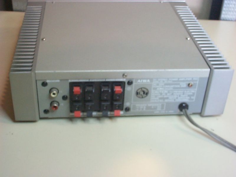

I recently bough this little amp on ebay. I was wondering if the heatsinks are big enough for a small (10-15W) class A clone?

Hard to see, but comparing the size of the heatsinks to the size of the RCA connectors, I think more than 25 Watts of heat dissipation per side would make this amp run too hot. I might be wrong, of course
Are there plastic parts near the heatsinks? 😉
25 Watts of heat per side would mean not more than 10 Watts pure class A per channel.
