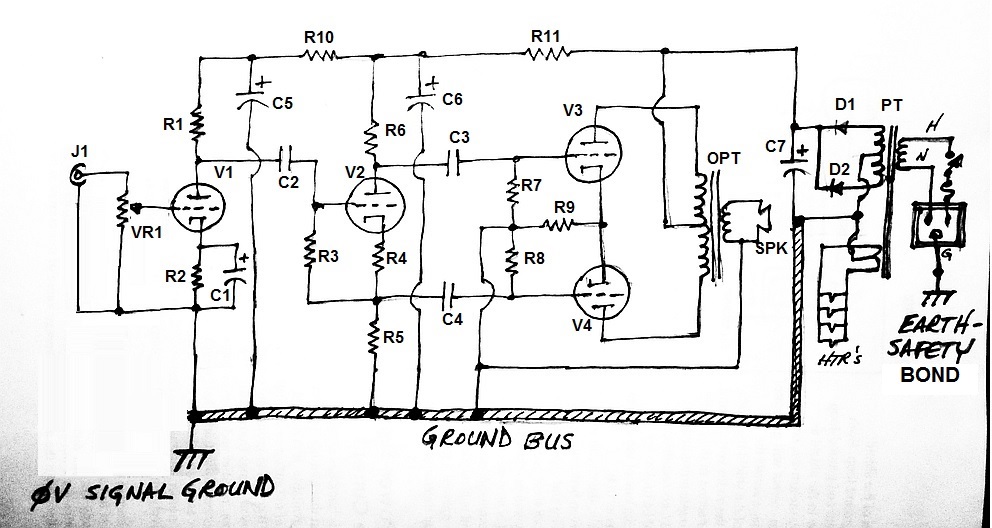

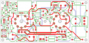

Hi,& Cnpope. I want to share with you an actual practical work experience. This is OTL driver, the thick background track is the signal ground and on the left G1 is the M4 screw nut on pcb and 1 ohm resistor to chassis. The input W1 is near the ground nut. Once the drive is ground lift it makes little difference as where it's connected to chassis, but preferable on same place as power amp. Very little hum is dead quiet, ~1mV for 25W model, I could not barely hear hum from a sensitive headphones. A bigger ground lift can be install on chassis to PE if require to adapt to other preamp. The scheme does make a difference to buzz and hum as learn from practical experiences.

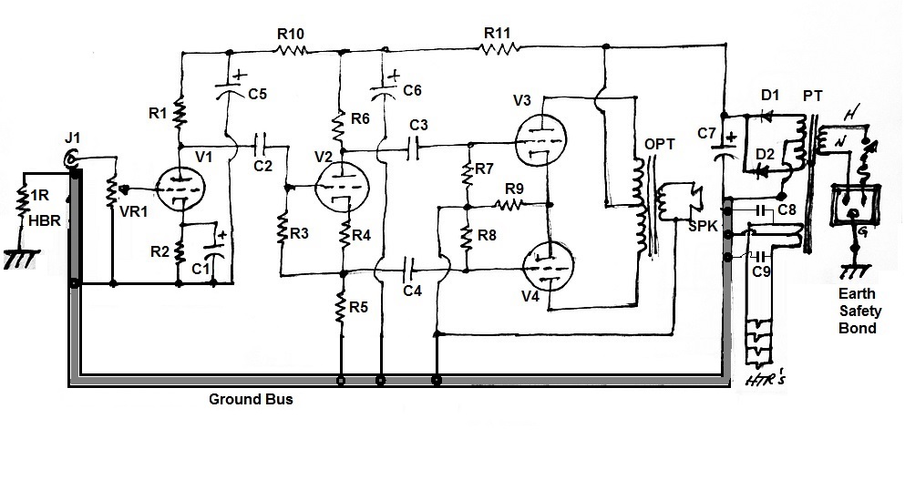

I could change the HBR (1 ohm) to paralleled bunch of two diodes in anti-polarity, 0.01uF 1kV ceramic cap and 1R resistor. That's the best way to do this, correct?
I think I'm following you. Attached is a drawing of what I think you're saying... --
Yes, that's it.
Below, combination of the left of the first image and the right of the second image (as recommended by Sy) should give good results.
Try to get the lowest as possible impedance for the bus ground.

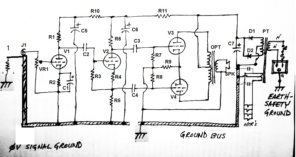

The second image shows the two separate connections to chassis earth, two separate ground buses. I thought that was a bad thing.
I think you mean the ground wiring for the input stage from the top image. I think...
And I think you mean change the heater wiring to follow SY's suggestions (in the bottom image).

That statement conflicts with the solutions that Joffe proposes in his paper. Introducing a 1 to 10 ohm resistor in between the Ground Bus and Chassis does not provide the lowest possible impedance for all frequencies, or at least I think so.forr said:Try to get the lowest as possible impedance for the bus ground.

Lowest impedance for bus ground to where? The input stage's -ve? To chassis earth? Which of the two attached drawings accomplishes this better?
(Note that the drawings are identified in the upper left corner)
Referencing this:
I think add a capacitor is like grounding ac signal include hum to chassis directly defeat the purpose of 1 ohm ground lift!! Not for HBR.

Your two last drawings are quite similar. My prefered one is #6.
I may even use the chassis as the ground bus.
But many people will disagree, there is no consensus about ground schemes and I am not going to claim that I hold the ultimate truth.
In an active control and phone amp I recently built, I played with a piece of wire to introduce various ground loops. I did not succeed to obtain any hum at the output.
It may be time for you to experience now.
I'm not sure I'm catching the drift here. Maybe you are saying that in a specific example, a particular grounding scheme you adopted turned out to work well? That could certainly be true; there are so many factors at play that trying to extract general principles based on specific anecdotal examples is not necessarily easy or useful.
As a general principle, the idea of keeping the signal ground distinct from the safety ground seems to be a good one. In a specific example, it may not be needed, but in another example it may be worthwhile.
