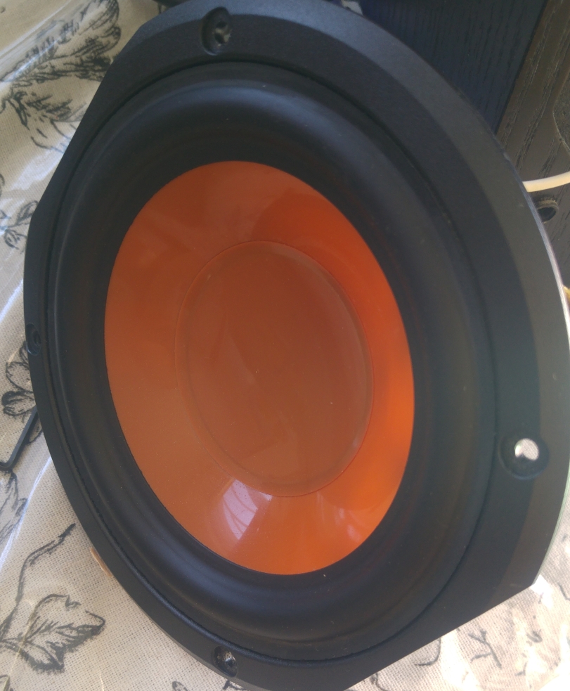

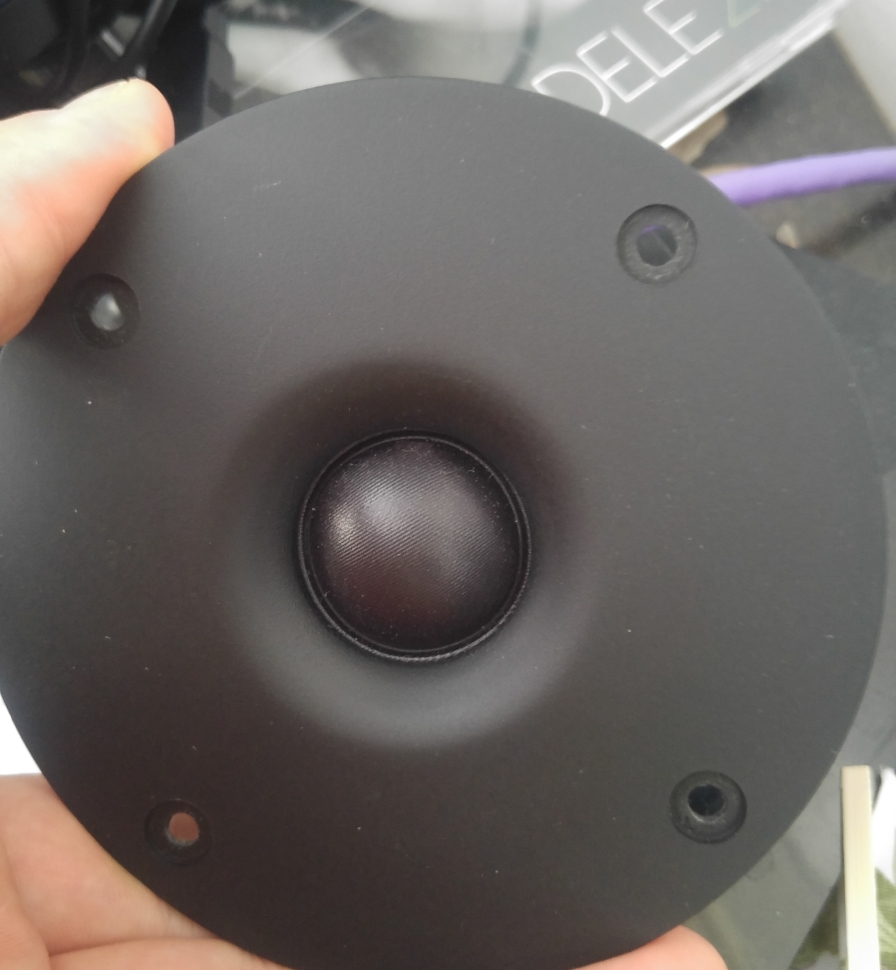

Tweeter is something small. Looks exactly like at this picture.
Not sure if it can have Ferrofluid at all.

check also if the tweeter has Ferrofluid, if yes try to know the grade and go for a little refurbishing here...
Not sure I understand what you meant about the polyester caps : according to me, they are good, chosed carrefuly not only for the precise capacitance, and a polypro would had costed nt much, so make your conclusion. No so hard to find more precise values with polypro outside standards capacitances. Less choices of brands, that's all. In your shoes I will just measure the yellow cap for the future ! 15 years is ok for modern lytics, this is not a 70s' speaker. That's what I meant to rephrase it.
For the tweeter, you could ask Chario themselves if it is FF or not. Idem for the yellow caps at the customers dpt. Anyway : capacitor should be capacitance measured : such tool is around 40 usd. Measuring ESR on the whole range needs a LCR tools which asks a zero usd more for a precise enough portable device or a little DIY as pointed out above with free soft/soundcard and few resistors.

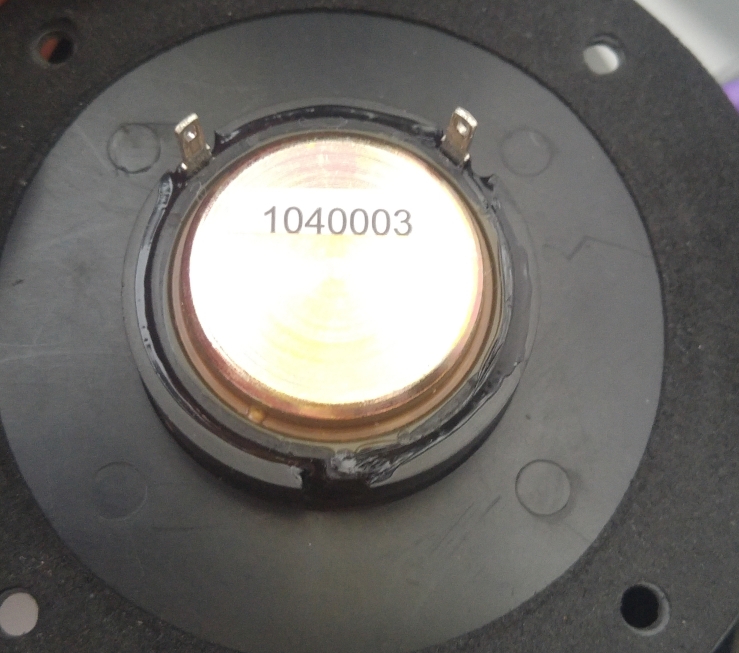

This could all be a waste of time. Film capacitors used in the tweeter circuit are unlikely to have deteriorated.
Have you tested the tweeters?
Usual troubleshooting for tweeters is to measure the voicecoil resistance with a meter. Expect 3 to 6 ohms, or it's open circuit if broken. If resistance is good, look at the state of the black or brown ferrofluid oil in the gap. Has it dried solid?
Simple test for tweeters is just to wire a 1.5V battery across it using a paperclip or wire. It should crackle if it works. Otherwise you might be cleaning out the fluid with blotting paper and WD40 and replacing: Blue Aran - The UK's no.1 Loudspeaker Component Stockist > Sonitus Audio > High Frequency Drivers > Ferrofluid
You can run a tweeter without ferrofluid, just keep the volume down.

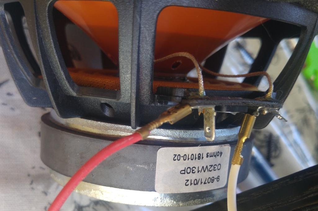

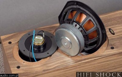

Do you know what Tweeter they used at Chario ???
The woofer seems a modified Peereless ???
Looks like Chario make the drivers:
Chario_Sonnet
Don't know if the tweeter even comes apart. Looks glued.
Chario_Sonnet

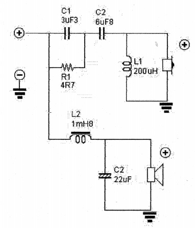

Thanks for noticing.
But as I understand this 22uf capacitor is used in parallel with mid-bass for some impedance correction.
Do you think that we really need here bipolar capacitor? Maybe we can have here polar one? Please look at schema.
I am not much competent in types of capacitors )

So question to GURUs - can we replace bipolar 22uf capacitor in schema above by polar 22uf capacitor?
I think we need bipolar cap.
Membranes of driver are moving in both direction due to current that flows in both directions, so current that flows in both direction in turn is caused by voltage applied in both directions. Checkmate.
That has to be 1 . 55 Ohms!! 🙂ESR measured @1kHz is 155 ohm.
Right, and a film (and any modern bipolar) will come in around ~ 0.3 Ohms. So, you would need to add a high power resistor ~ 1.2 Ohms in series to compensate. My suggestion is buy a film cap (Axon? Cheap, good in bass), and a 1.2 Ohm 10 Watt resistor.
Then try with and without. You can bypass the cap with a jumper. My guess is you'll find the resistor makes the amp sound better and more full.
Best,
E
No, it is the usual cap for a 2nd order LP crossover. Changing its value will alter the slope and/or the crossover point of the LP filter. I usually suggest replacing an electrolytic cap with another electrolytic one, so the chance of maintaining the same ESR is pretty high.But as I understand this 22uf capacitor is used in parallel with mid-bass for some impedance correction.
You really need a non polar cap as we are dealing with AC.Do you think that we really need here bipolar capacitor? Maybe we can have here polar one?
I suggest you don't change caps in the tweeter circuit as there is nothing there that really needs to be replaced (polyester caps doesn't degrade).
Ralf

As I already said, you need a non polar cap, and unfortunately those Elna are polar ones. Just as an example, buy something like this (if you lives in the USA):
Bennic 22 mfd Electrolytic Caps
or
22uF 100V Electrolytic Non-Polarized Crossover Capacitor
Ralf

Hi guys, sorry for no reply for so long. Had many other things to handle.
Thanks for all your advises and notes.
1) Drivers pictures are attached to this message.
Tweeter is glued, so no point to open it for checks. It sounds pretty much OK, so I don't think there is any issue with it.
Mid range driver is 9-6071/012 Bravox (this is what google search gave me).
I think both tweeter and mid range are cheap and it will be not very smart to expect for very high sound quality here 🙂
