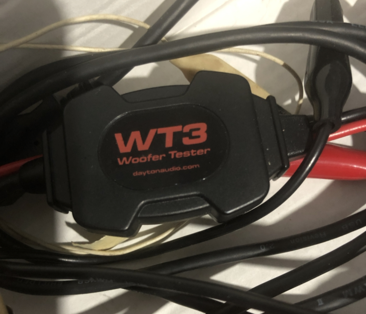

Check out Dumpster Diving, Yard Sale and Thrift Store Speaker Quick Assessor as a way to have a first look at such things you may come across in the future -
