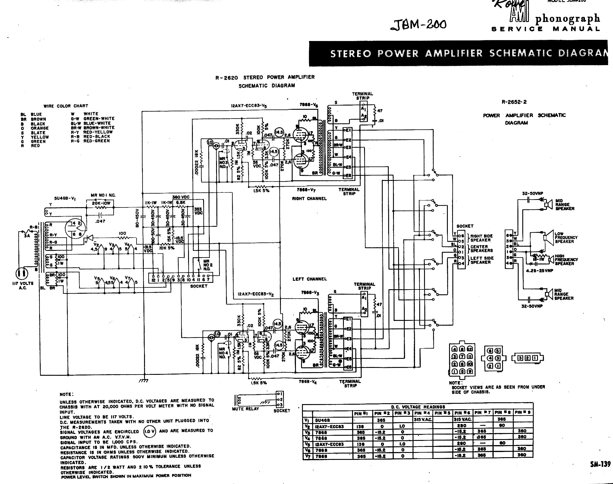

I hauled in a bunch of push-pull audio transformers to test on my AC sine wave source at work. I generally test using a 50V, 300Hz sine wave. I monitor the output with a DVM set on AC, and look at the exciting current with a Yokogawa WT210 power analyzer that is also hooked up to the sine source. That way, I can determine turns ratio and from the exciting current, I can calculate primary inductance. I had some unknown transformers that looked good for ~40W (on the hefty side) that tested out at around 6k:8, a pair of "7k:8" transformers that tested at around 6.6k:8, some Baldwin organ transformers that tested out at ~3k:8 (probably wound for 16 ohm speakers), and some bitty transformers that tested at around 10k:8, with not a lot of primary inductance. Next weekend, I'll bring in some Wurlitzer P-P transformers that came off of an amplifier that used 7868 outputs. Fun times ahead, as I figure out how to purpose all this iron...
