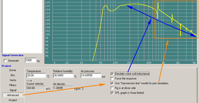

It ALL interests me 🙂 & i'm sure others too, even if they don't post !
Actually, WinISD can show resonances in v0.7.0.900 under the Advanced Tab. Also the effect of inductance can be included.
True, but most people ignore that feature and I wouldn't trust it without doing a comparison with reputable 1/4 wave software like Hornresp first. I'm pretty sure you would find that it's just simulating the port resonances, not the enclosure resonances. And even then it might not be simulating the port resonances in an accurate fashion.

Now the first thing to do (and you can bet I'm going to document everything this time since I'm being challenged) is create a full size horn to compare to your 599 liter small horn design. We'll use the same driver, same input power, same low knee frequency and let Hornresp design the full size horn. The horn loaded bandwidth is going to be limited to 45 - 150 hz due to the compression ratio and rear chamber size issues.
Now the first thing to notice is that a full size horn for the driver and low knee that you have chosen is only 1475 liters. That's only 2.5x larger than your "small" horn. When the difference between the "small" horn and the full size horn is so small it's no wonder that the differences in response characteristics are also small.
