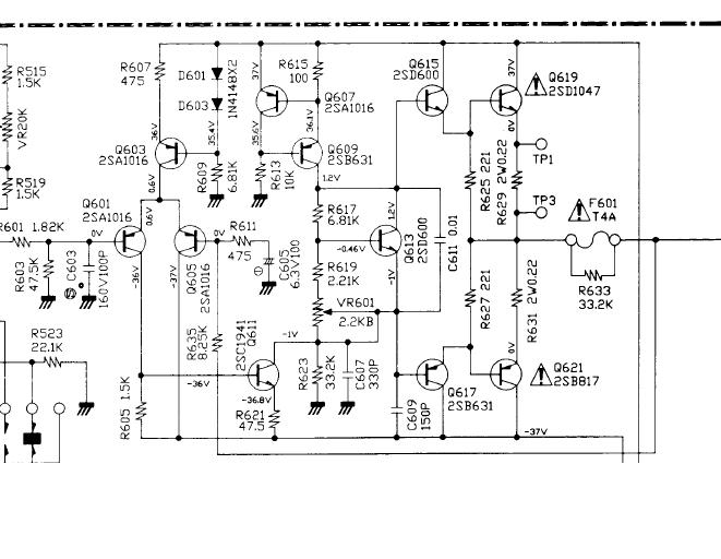

Good evening !
I am attaching the schema of the power amp stage
As I said above in front of it there is a opamp line stage and a tone control stage
I like the idea of "pruning" both these stages
Nevertheless I do not know which is a normal voltage gain for a power amp stage
In this case I see a feedback 8,25 K resistor and a 475 ohm resistor to ground
In the end there would be just the 50K volume pot before the power amp stage
Any suggestion would be very welcome and appreciated
Ciao
gino

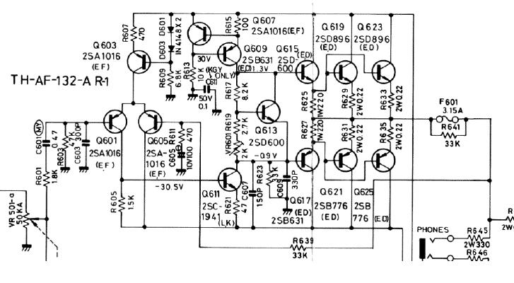

Good evening !
My doubt about the gain being too low is that in a similar power amp stage (that I am attaching as well) with a volume control the overall gain is set much higher
But I have at hand the previous amp
So I am thinking about raising its gain in order to be able to use it as an integrated but just with a pot in front of it (like in this second model from the same brand and similar power)
The first is from a Rotel RA-930AX (that I own)
The second stage is of a RA-820B
Thanks and regards,
gino
in the first amp, the voltage gain is set by the ratio of (R635/R611)+1 and is about 18, the second amp, the gain is (R639/R611)+1 and is about 71. if you really wanted to you could make R635 (or R639 depending on which schematic) a 50k pot, and you would have an amp with a voltage gain variable from 1 to a little over 100. you can treat the power amp as an op amp.
As said, you can treat the power amp like an opamp. IMO, you'd be well off to get something like Walt Jung's Opamp Cookbook, or maybe there's lots of info online, but study up on the basics of feedback and gain. The tradeoffs for a power amp are very similar to an opamp and you'll see how stability and other parameters are affected. My worry is that whatever gains you'll make pruning input circuitry, you might lose in fooling with the gain of the power amp. Without some test equipment it's hard to know what's really going on after a change.
Conrad
I think that maybe the existence of C611 shows that the designer recognises that all of the grounds have a different job and terminate in different parts of the amplifier/chassis. But, he has typically used a schematic drawing program that does not differentiate between all these different grounds.
you would want to be careful about how you add a potentiometer as a gain control, since stray capacitances of the potentiometer and it's wiring could cause stability problems. a better solution might be a CdS photocell and LED opto device with the LED controlled by a remote poteniometer
