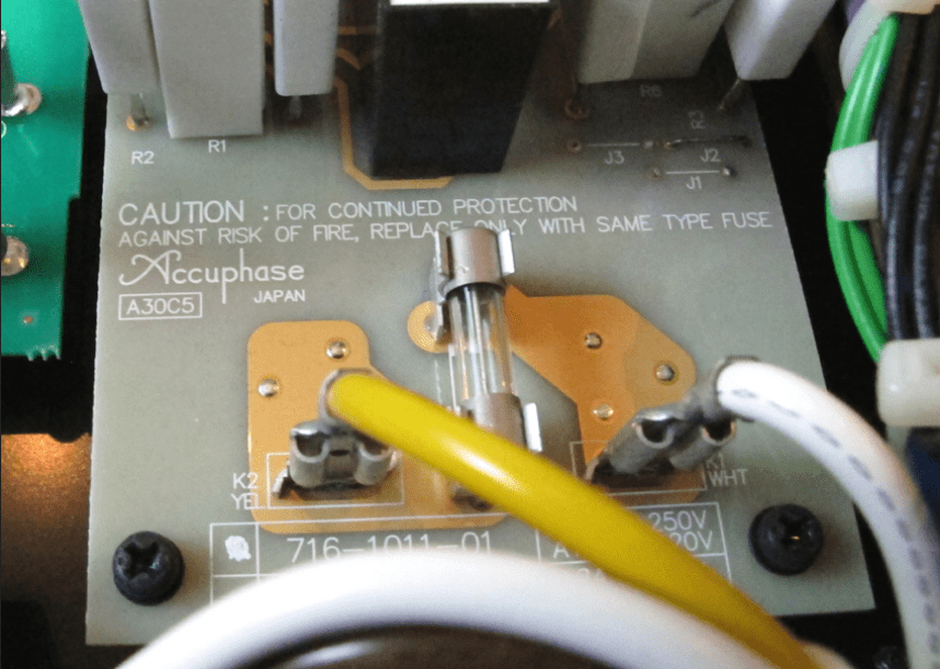

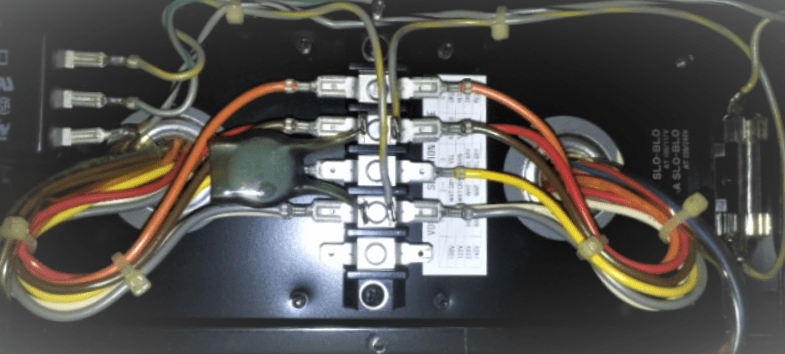

It depends on the model, most of their older model amplifier has printed voltage selection table on the power supply board and use quick disconnect terminal, make it very easy to change voltage.
However, their newer models are harder to change voltage without a service manual in order to protect their distributors.

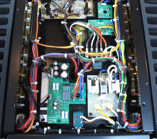

It’s the A-70 I’m specifically interested in. I have started another thread asking if anyone has the SM as nothing comes up when you google for that model.
@chrisng thank you very much indeed ! 🙂 That confirms as I suspected that its the same as the A-60 and A-65 for which I have found service manuals; as you mentioned previously its just a question of switching the wires from the transformer based on the guide they provide.

There's a picture show the fuse and soft-start resistors, I believe J2 is the jumper to connect both set of resistors in series for 220/240V mains.
