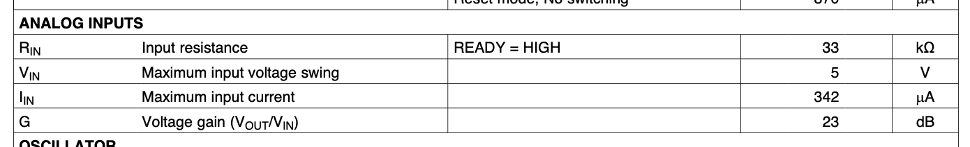

TAS5630 datasheet - 5v input for full output

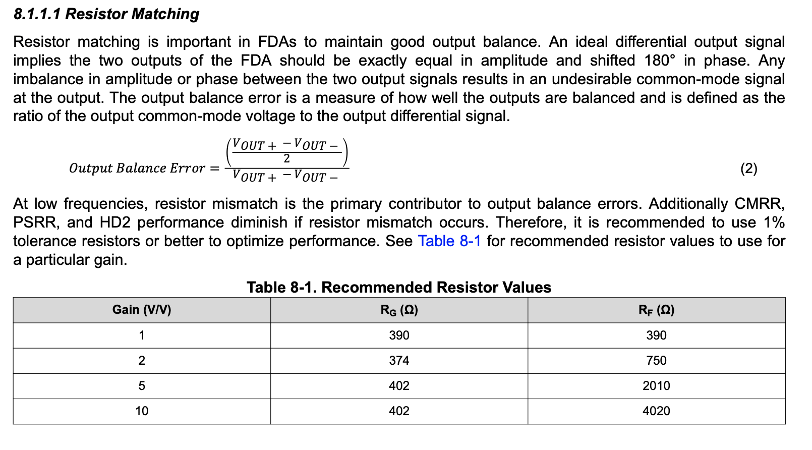

OPA1632 datasheet- As far as I can see I would be aiming for a voltage multiplier of 5.6x for full output (5v into TAS5630 / 0.9v into opamp).

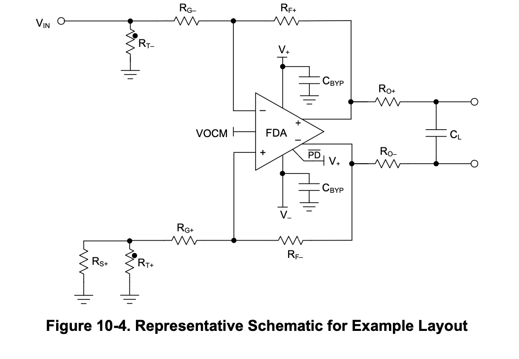

OPA1632 datasheet- The opamp Datasheet shows Rg and Rf here

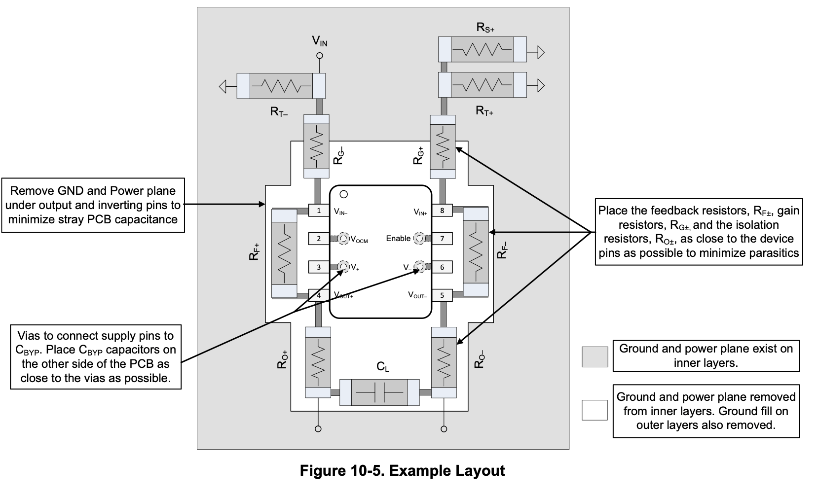

OPA1632 datasheet- Example layout matches with schematic

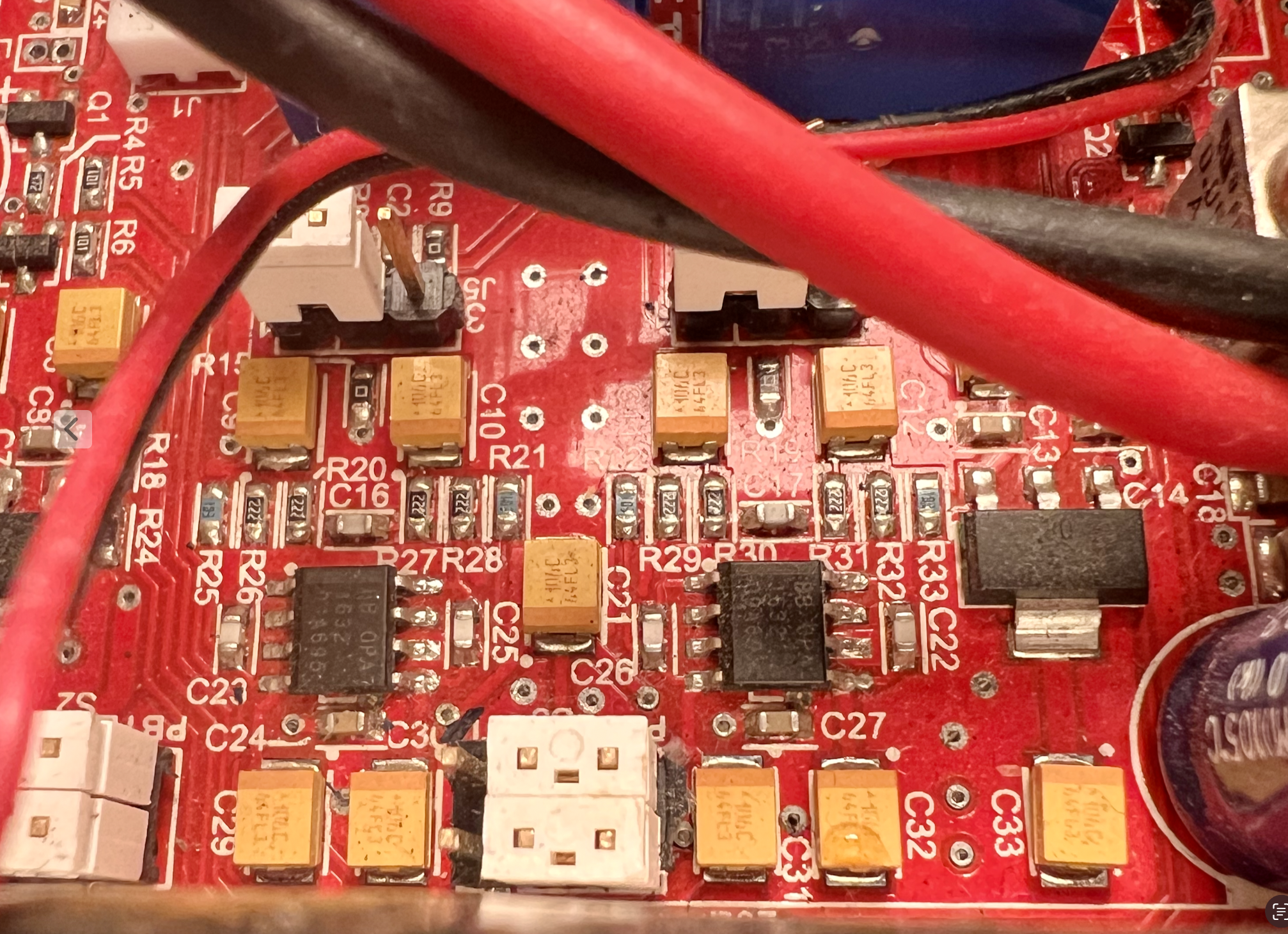

Own photo -
On the board I measure R26/28/29/32 to be 2.2k each and <1R to the op-amp input pins, indicating they're Rg.
The components R25/21/22/33 measure to be 10K resistors. I can't see the traces exactly, but resistances are <1R to where they're meant to go if they're Rf.
In which case 10k/2k2 = 4.54x gain rather than the ideal 5.6x.
Changes to board-
Am I right in thinking replacing the Rg resistors (R26/28/29/32) with 1.78k (1% E96) will yield the desired input sensitivity?

Own photo -
Changes to board-
