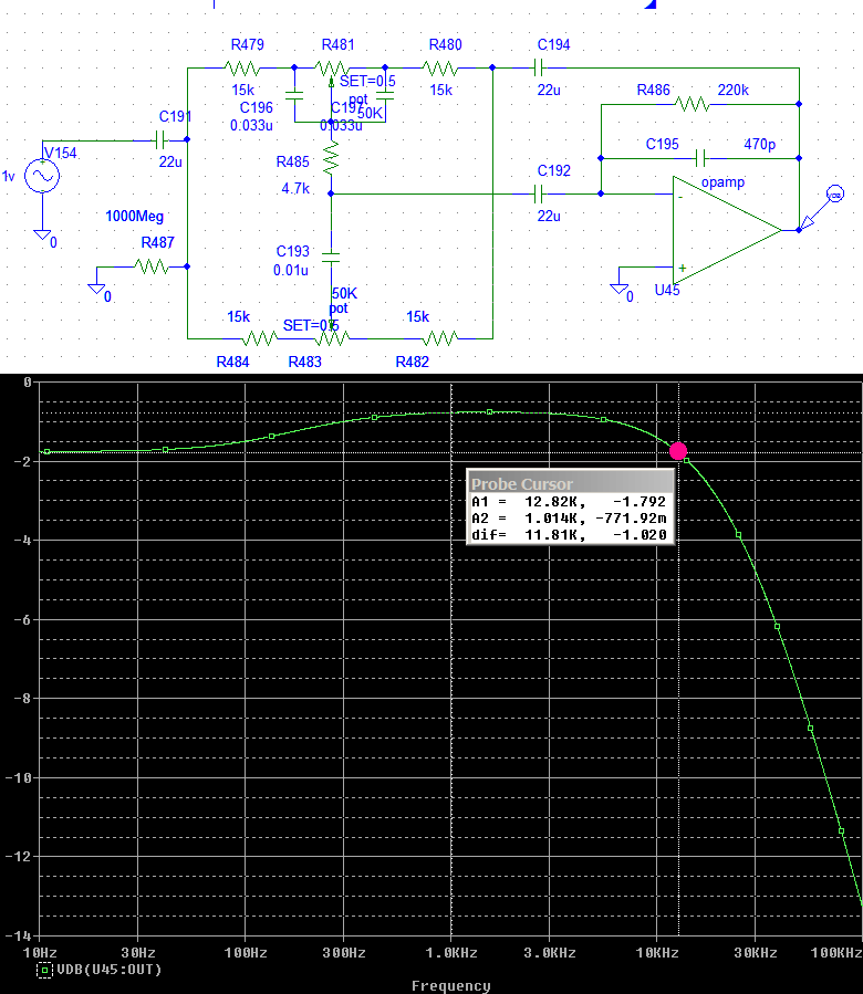

And that´s my point, having high impedance signal sources is BAD for straight driving a Baxandall network.
That preamp would benefit from a buffer exactly where I suggested.

Again: adding a unity gain buffer, high impedance input, at the point I suggested, driving the tone control network, will improve things in a sensible way, because it will make tone control action/range independent from Bass pickup; you might even use a regular passive Bass pickup there and it will work fine.
Again: IF you want brighter/more defined/more "Hi Fi" sound, you should at least boost highs above 1600 Hz.
let me see the schematic again, maybe it can be easily modded 😉

I have been chastised for speaking about "treble murdering" ; yet your Spectrum display shows exactly that, in spades:
Mid/High response goes downhill like a snow avalanche.
And NO highs to speak of.
Oh well.
Let me see if we can improve that somewhat.

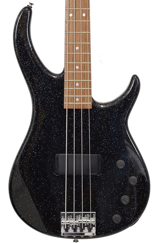

so this is the bass
Volume
Bass middle treble
no balance needed

The preamp with the 220K||470p is flat -1dB to 12.8KHz.
Follow the link in the quote header, eh?
Woah..Follow the link in the quote header, eh?
