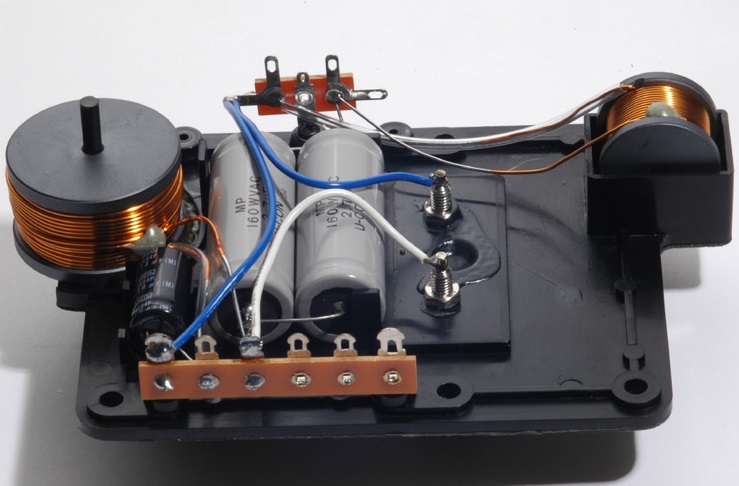

I'm really not sure what you are doing here. And nor are you in all probability.

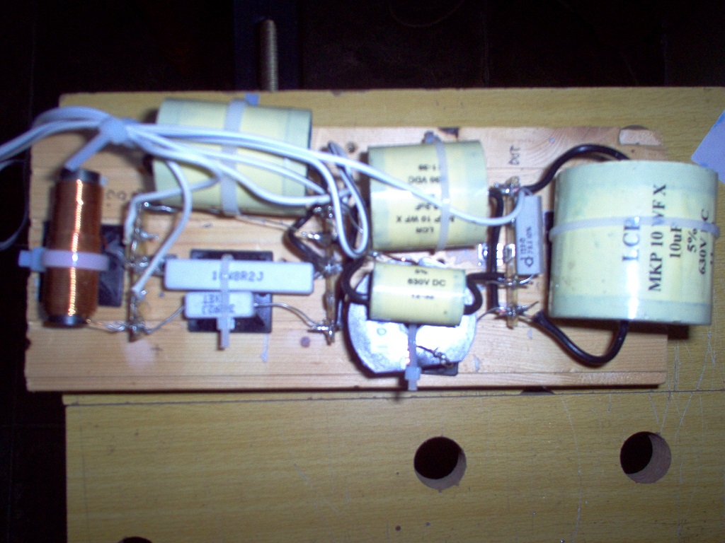

This is what happens when you overdrive a KEF Q70 crossover, and they don't have an easy life at the best of times, being often covered in foam in a poorly ventilated box:

You could have helped your cause by being more informative. What model Yamaha were these speakers? Where are the photos of the existing crossovers? Otherwise it's all guesswork and vagueness and unfocussed in reply, you follow?

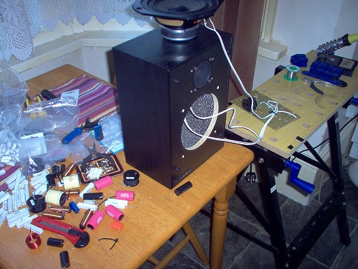

This crossover was largely built with parts from the Maplin store. But more suitable and cheaper parts are available at Wilmslow Audio and Falcon Acoustics and Blue Aran.
You also need at least a 40W soldering iron kit, some long nosed pliers and some small wire cutters. Again from Maplin. Below is my own workshop.

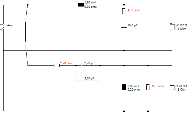

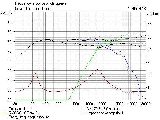

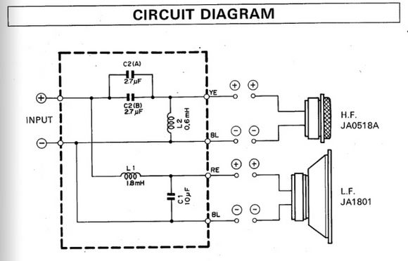

As it goes you are talking to someone who knows those little Yamaha NS10 speakers: The Yamaha NS10 Story |
I think we had somebody a while back who found them too shrill at the top end. I doubt if messing around with capacitors will fix it, but new NPE's do no harm if man enough for the job. In fact Yamaha went almost over the top in paralleling two big NPE 2.7uF. Should give what we call a low ESR.
Which is a good thing. So here, to my ungrateful Yamaha NS10 audience, is a reasonable stab at taming the top end on this cheap and cheerful monitor. Real changes will do far more than swapping components, IMO. I would use 10W resistors in the bass filter and 3W in the tweeter filter. I think I was allowing for MKP-type capacitors here, which are always a bit brighter, but I really can't remember.
