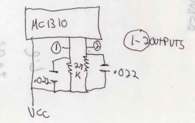

I finally found the R and C which make the deemphasis
There's a 2.7K and a .022 uf cap for each channel as seen in the drawing.
In the National typical application sheet, they show a 3.9K and a .022 uF. I tried a 3.9K instead of the 2.7k and I think that the sound is perharps worse with more or as much treble than it was.

Rather than change the resistor, which might effect bias points in the chip, why not just parallel 5.6 nF caps with the existing .022 uF caps? That should be pretty close to a 75 uS time constant.
I'll try 5.6nF
With the standard setting of .022 and 2.7k, I calculate a deemphasis of 59.39 uS. This is not near 50 uS I tought this tuner had.
I also tried .033 uF to replace both .022 uF and the multiplex didn't want to decode in stereo with .033 uF caps.
Something is not correct here... The deemphasis pins not 1 and 2, but 4 and 5. The capacitor value of 33 nF should be OK for 75 us, since there is an internal resistor shunting the external 2.7 k.

that diagram of pins1&2 was not the de-emphasis.
