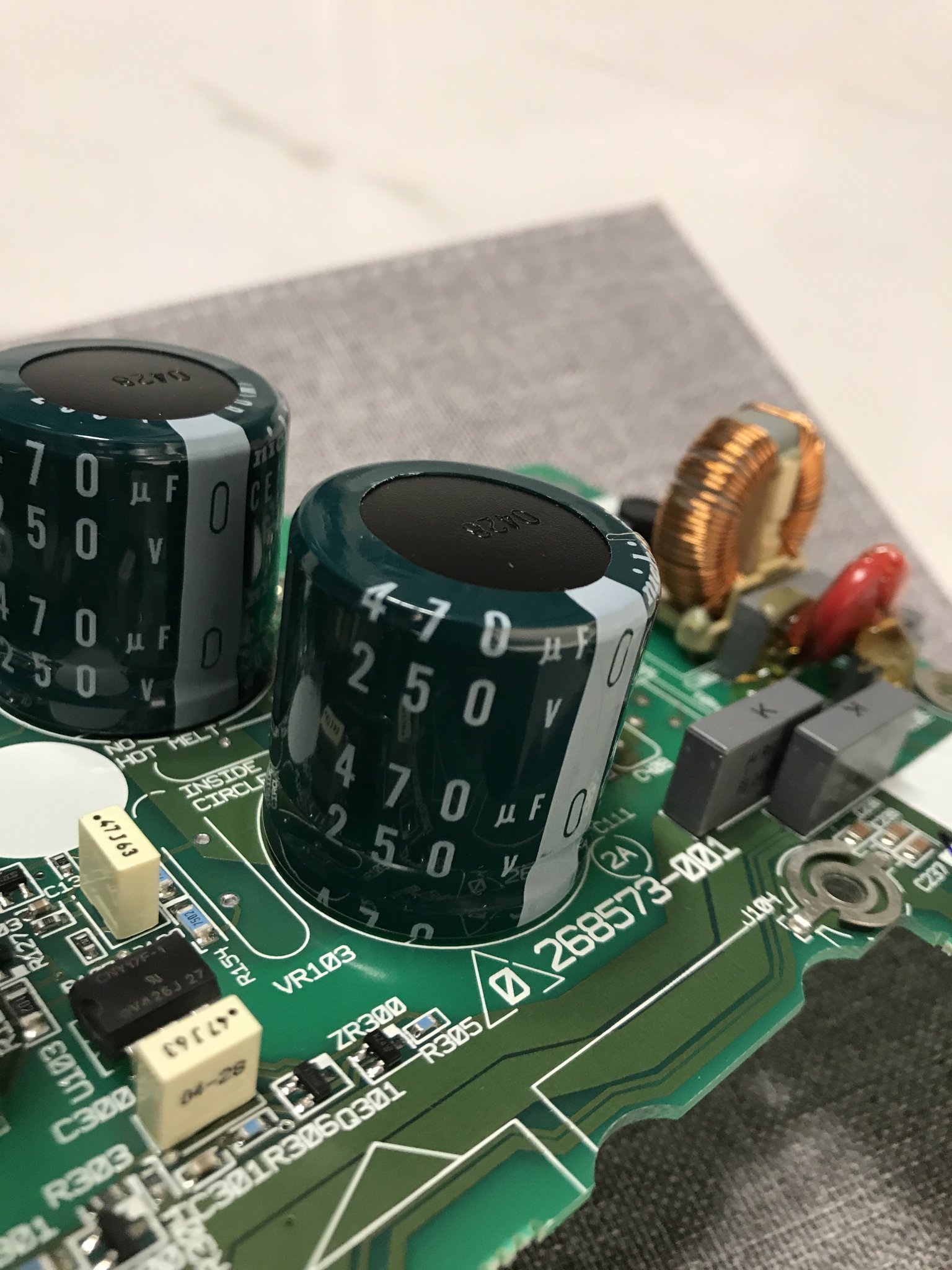

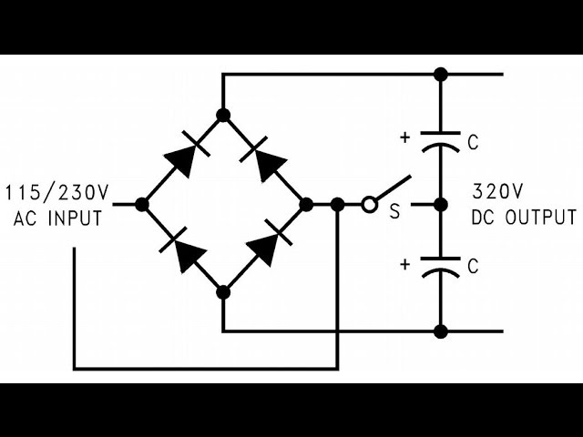

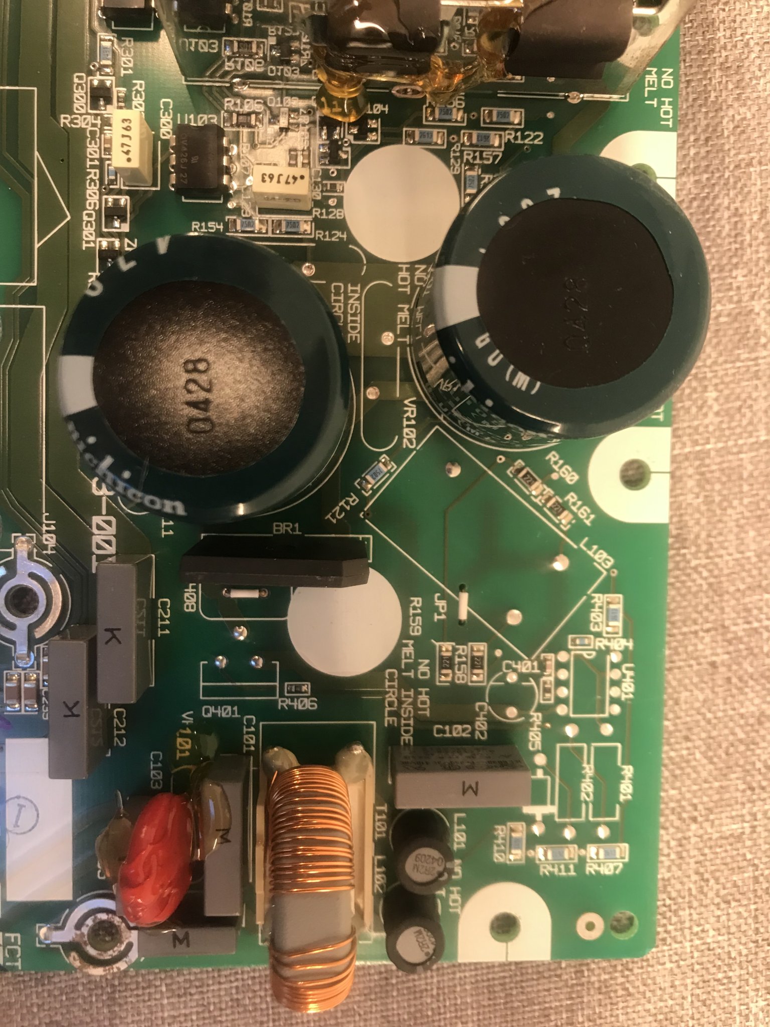

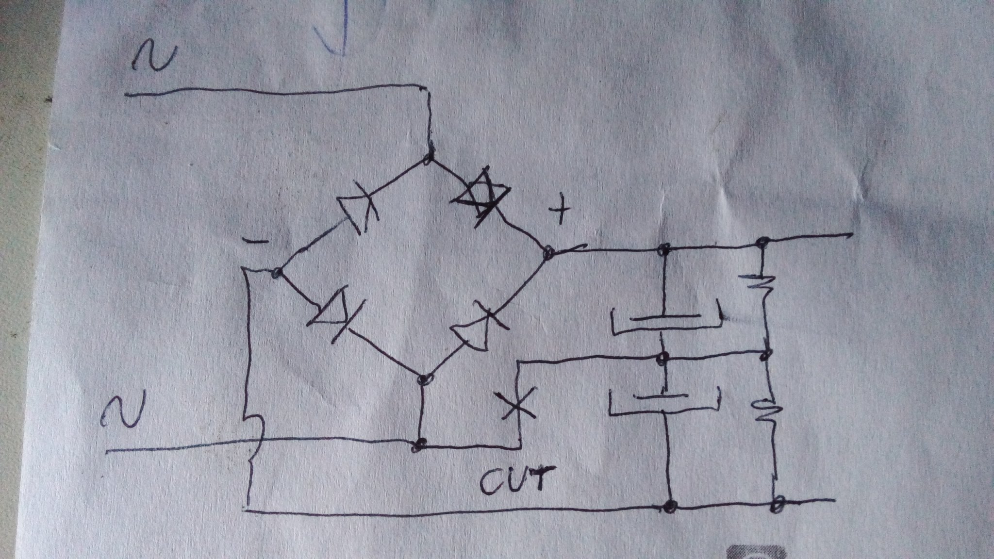

If both electrolytics are in parallel, no option.120V an no more. But if they are in series, it is too stupid for the manufacturer to put 2 each 250V lytics for 160DCV. I am amost sure that they are using voltage doubler with half diode bridge and the two caps. Thus, cuting out the element that connect the midle point of the caps to line, it no longuer act as s doubler enabling normal bridge diode rectifier and the dual caps in series across 320DCV rectifier.

In any case, a step down transformer, or another new supply, can be thought of.

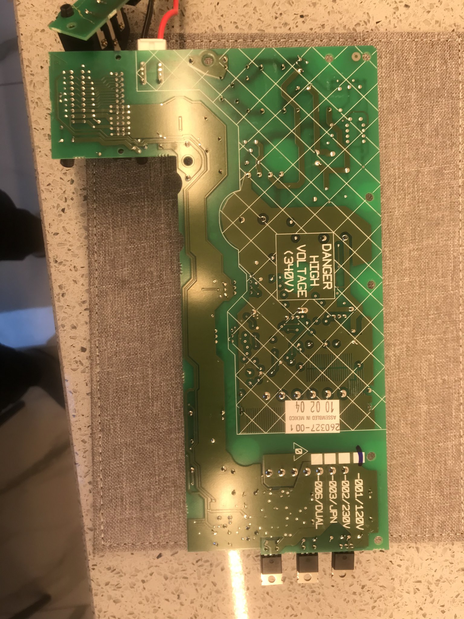

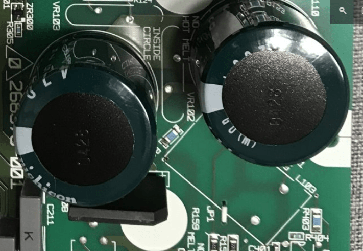

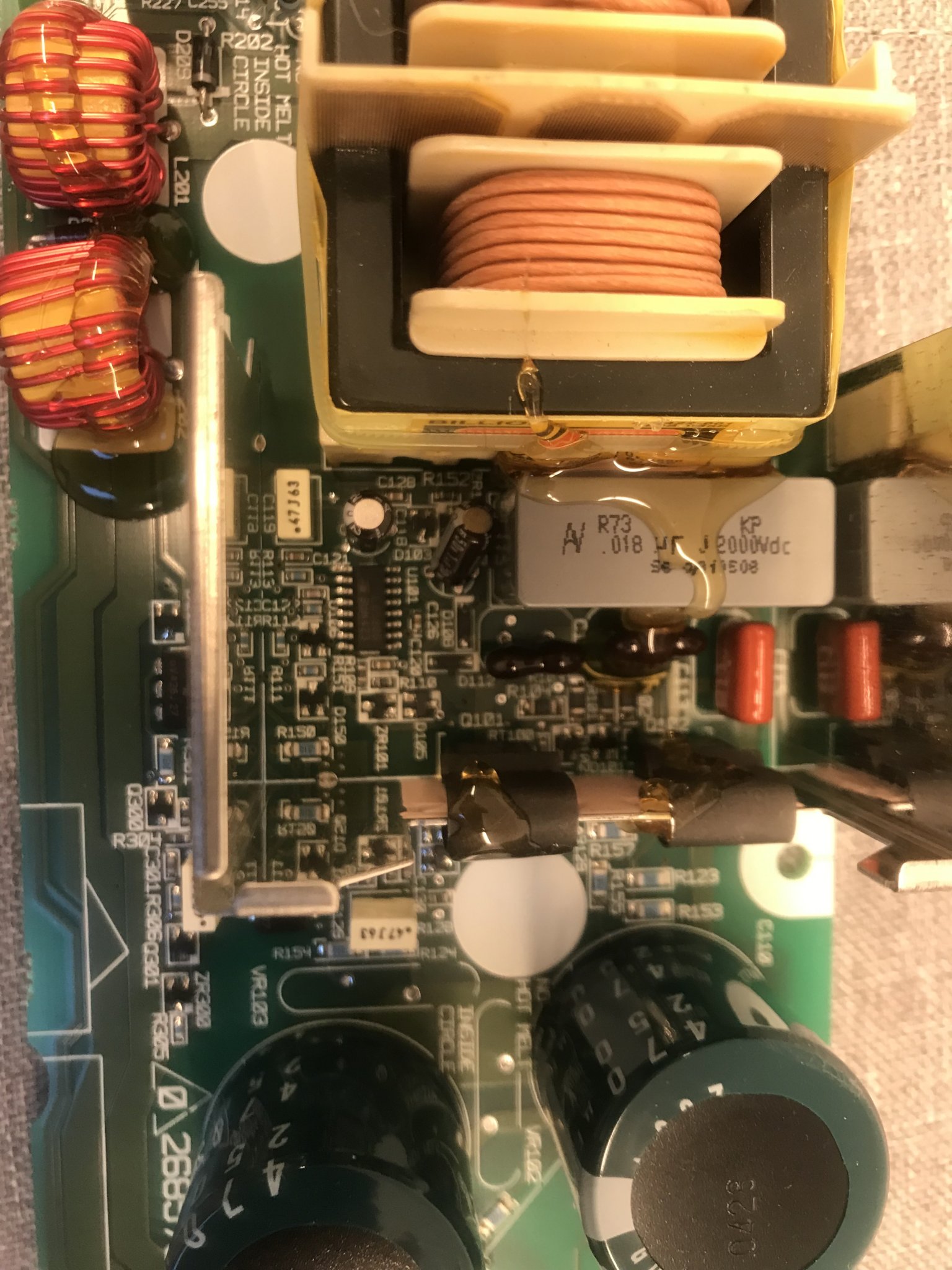

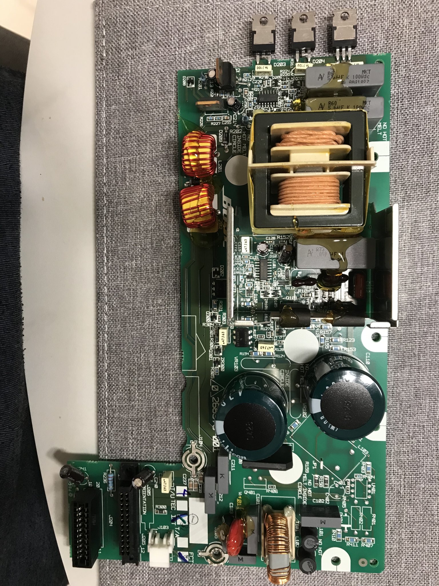

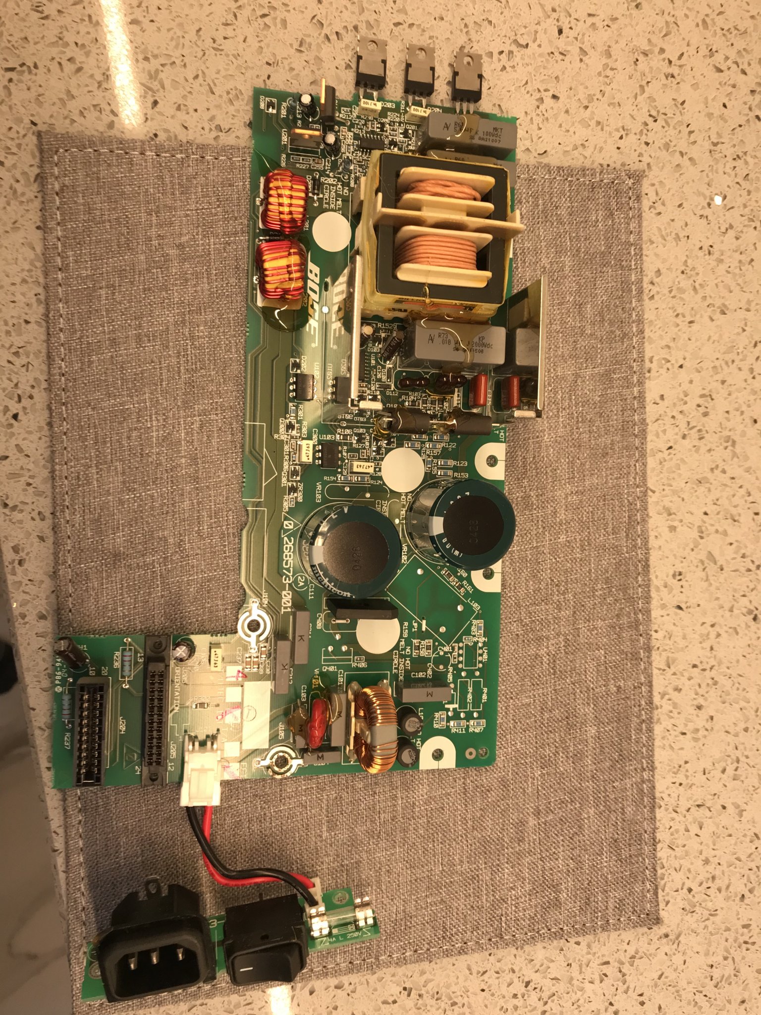

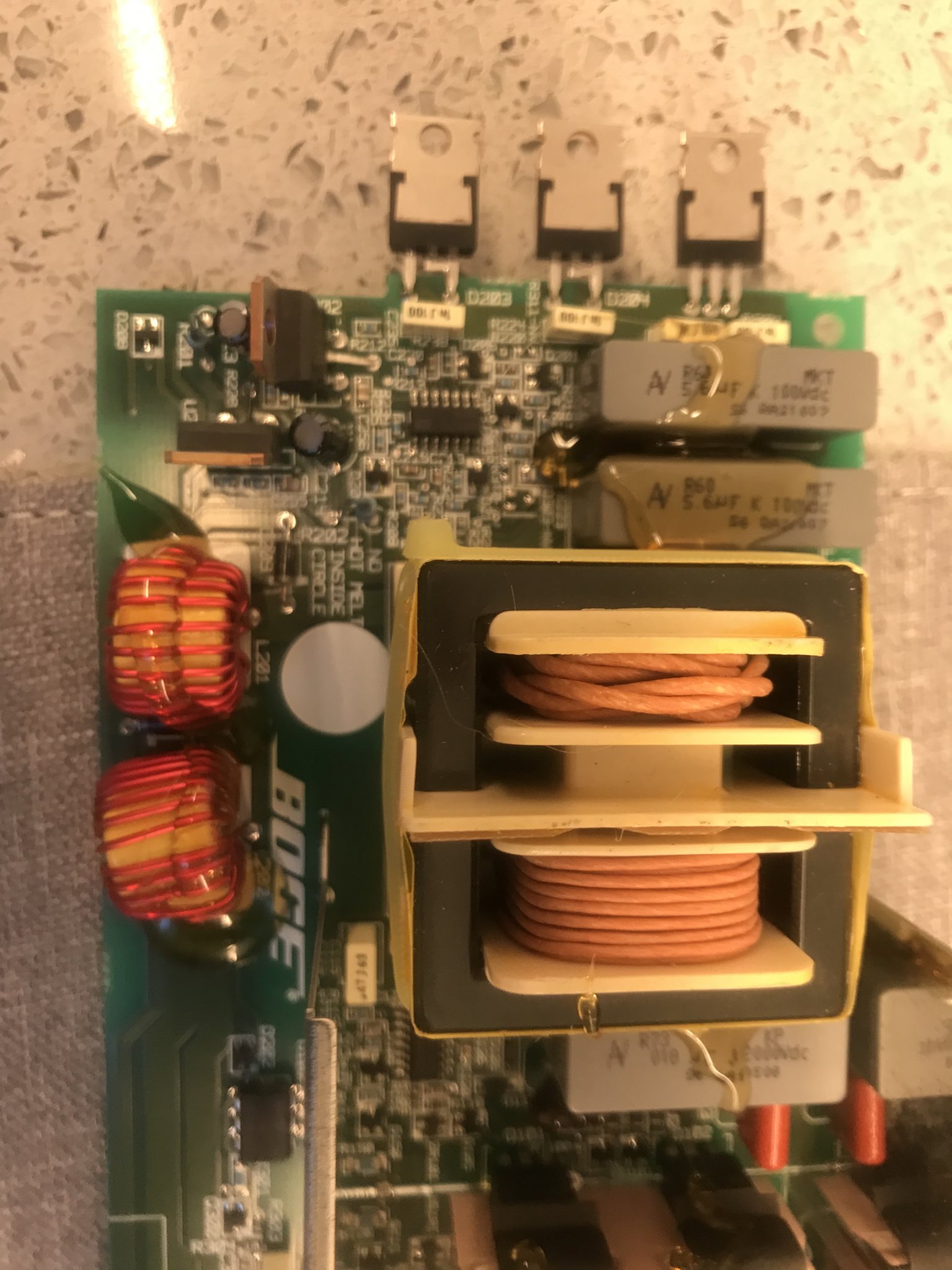

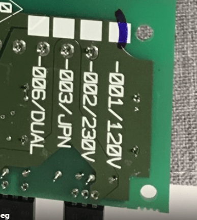

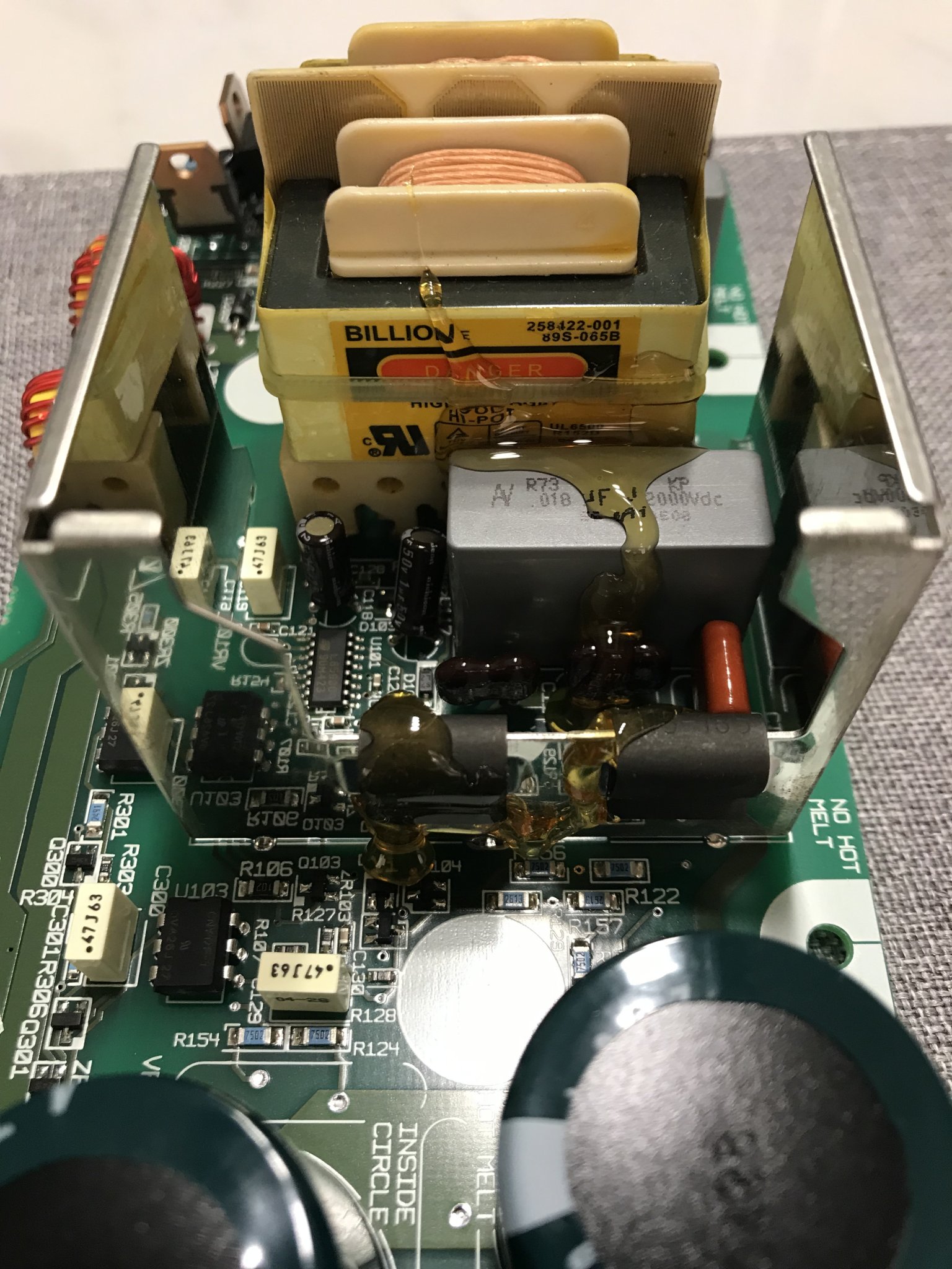

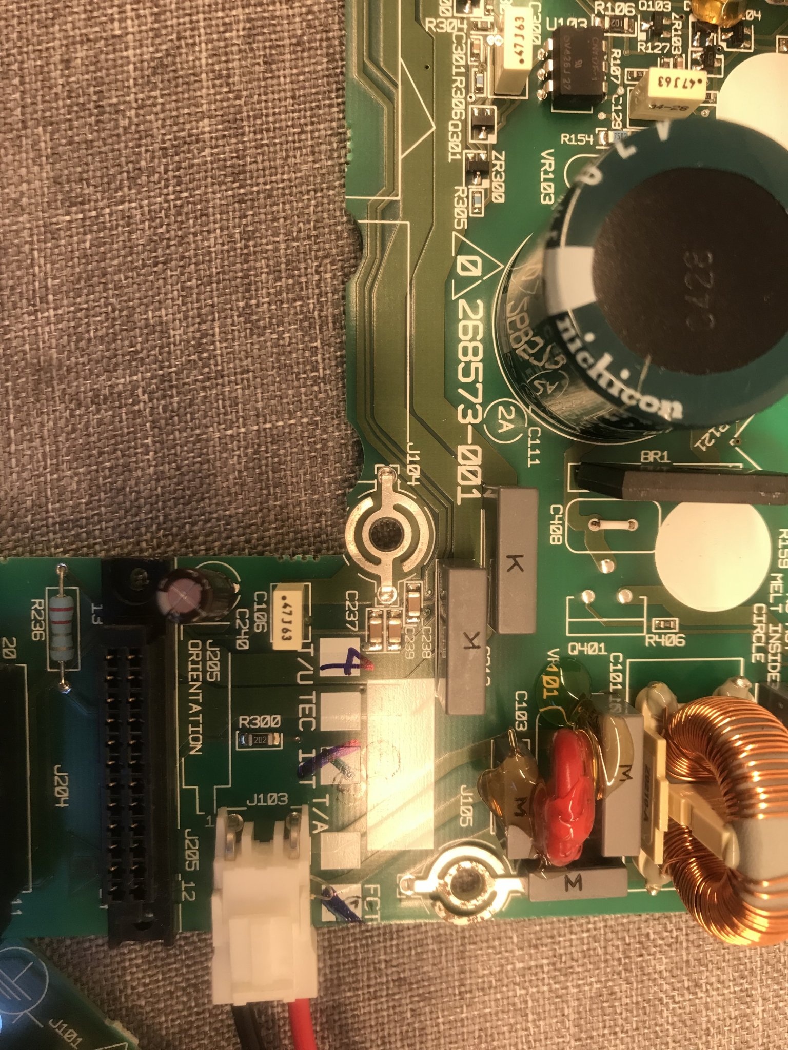

So I mange to order a second hand unit that from Uk and this is the board on the Uk all The same but with 3 extra bits and one different adding a photo so this would help any one
