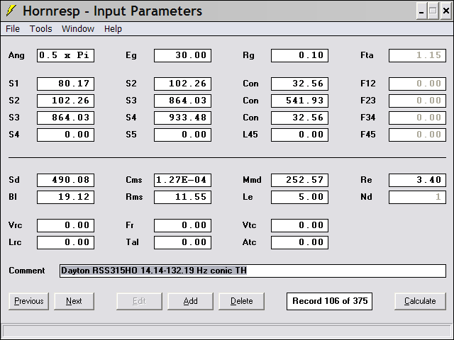

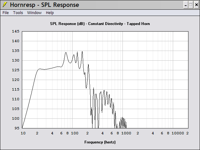

OK, since you can only have one BIG one, here's a ~260 L tapped horn using just one of your Daytons. 125 dB peak/20 Hz/225 W corner loaded, not too shabby for a dinky little 12" with a little added inductance and some digital EQ or skip the inductor and just use a bit more EQ if required 😉:
GM
GM
At >6:1 compression, would the cone hold up? Is that another TH bonus?
Well, it's not quite that high since the driver is down the pipe a bit where it's bigger, reducing the CR to <5:1, but even then it's not as well defined AFAIK compared to a typical end loaded horn, so may be even less. Regardless, I imagine a typical roll surround will deform first in a TH same as a compression horn, but with no personal experience with THs it's just my SWAG based on end loaded Vs offset loaded TLs.
Anyway, unless you overdrive it down below its LF corner frequency without enough boundary gain I doubt it would be a problem in a HIFI/HT app.
GM
