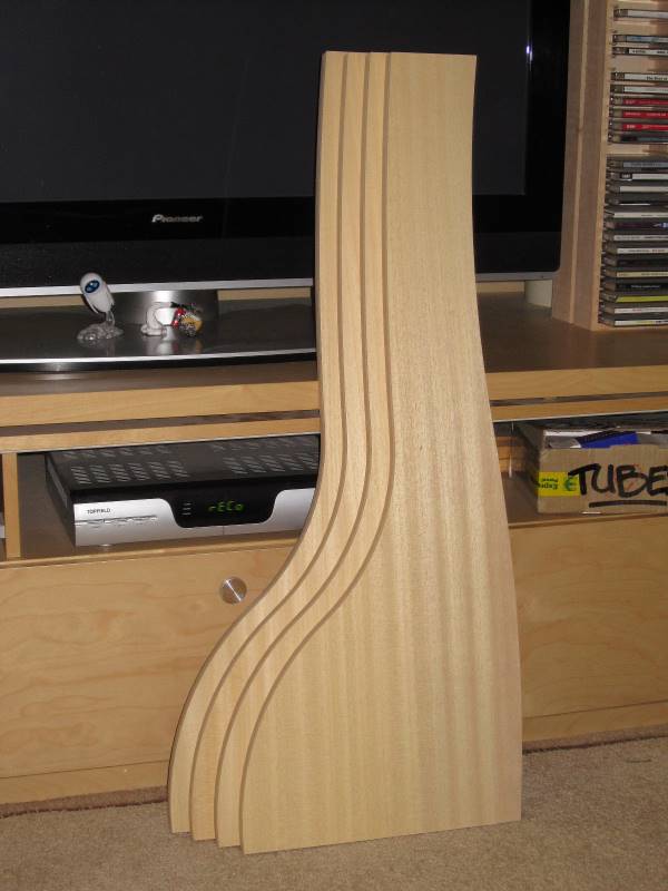

I started playing with curves myself, for a CSS FR125 MTM - the curve aligns the 3 drivers to a single point at the approx listening position of a paltry 2.2 metres. See pic for progress.

Curves inspired by a Steinway & Sons documentary.
Coffins inspired by the opportunity to fail

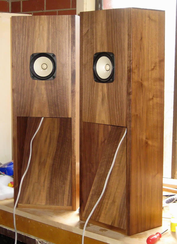

Ahhh yes. I've seen these cabinets (photo's). Very elegant execution however I wonder what happens with the acrylic sides fixed to the presumably 2-packed paint work - does it 'stick'?
I'd like to do something along these lines when I get more familiar with the software driving the CNC at work but what happens with all the waste?

On sticking, yes it does...so I am working on a couple of design enhancements. The first is to to use 5-cent sized 0.5mm clear plastic film, which is placed over the holes where the screws are used. This has proved successful.
For the ply internal version - there is no issue...as the wood doesn't 'shine' and appear to stick to the perspex.
The other option is simply to use MDF or Ply side panels. An all painted MDF version would looks smart, as would an all-ply version, using, say, Kauri or Hoop Pine on on the outsides.
The units weigh appox 90Kgs each...so there's plenty of bulk to ensure a good audio response.
I can scale the design back to 1200mm tall and 270mm wide to house the 6.5 inch driver.
