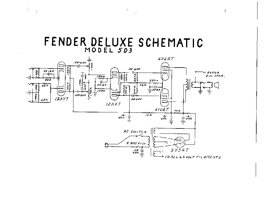

I'm still thinking about it. The 7868's and the 6c4 driver i have are junk, and would need to be replaced. I can put in new sockets and replace the 7868's with the cheaper equivalents, or build from the ground up. I figure if I'm going to do it i might as well build a proven design with new components. If i could save money and use the transformers i have that'd be even better. I'm using a 100db/1w JBL 15" so i really don't need (nor want) more than 4w or so.
What about the output transformer, is that usable? Since I would be using a single output tube do i connect the two existing wires that go to the 7868's together at the 6v6, or just use one lead?
It wouldn't take a whole lot to turn it into a "Deluxe" (see below).
6V6's cathode bias quite well, or you can rework the bias supply for fixed bias if you wish.
for a single output tube, use only one leg and CT of the output transformer. Put heat shrink over end of the other leg to make sure it doesn't come in contact with anything. You would still need to drop the plate supply to around 350 volts. I would use a 10 watt resistor.

That bogen would convert into a pretty nice PP amp, but the iron would not really work for an SE design.
If it were me, I would save the bogen stuff for something bigger using either 6L6's, 5881's, or possible a 7591A octal.
Not the perfect impedance match on the OT, but they make some really fine sounding Trainwreck style amps.

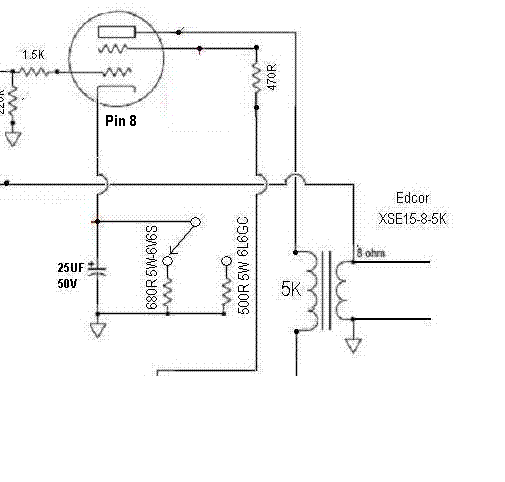

Actually Yes, there is a very simple way to make it an easy swap with the tubes.
Now Ideally with the Edcor XSE15-8-5K output transformer the primary impedance is 5K to an 8 ohm output. This is a great match up for a 6V6 amp. I have been using it with the 6L6 on a close enough sort of basis.
I put a bias selector switch to correct the bias at pin 8 of the 6L6/6V6. See attached picture.
Now, this is an effective way to make the amp more flexible, but there are a few things to remember.
Use a high quality switch!!
Never change setting while amp is on.
Be certain switch position matches the tube in use.
Due to my anode voltages being a little high, I ended up using corrected values for the cathode resistors. You will possible need to adjust that value on your particular amp/transformer set.
On mine, the 500R is for 6L6GC, the 680R is for 6V6GTA.
The cathode capacitor remained the same for either tube.
I was looking to do 2 things,
#1 not stressing the output tubes to improve life, and #2 using a set of values that will be survivable in the event that the switch is set incorrectly.
On my amp, there is a noticeable volume difference, but the bigger difference was the point at which the amp begins to break up at the volume knob. The 6L6GC breaks up at a higher volume setting and does so less abruptly.
Now, if your into small venues like coffee house or book store type jazz gigs, This amp sounds huge, it has a big full bodied range, no lack of bass, and a nice shimmer/ring to the highs.

Thanks, just the idea I was looking for. I have some good ceramic multi position switches. I'll just have to figure the resistor value for bias for the KT66 and add a third position.
I'll check on the OT you mentioned. Any personal experience with either the Hammond 1600SE series... Or using say a Mercury Magnetics Champ or SE Princeton OT ????
Thanks again. [ I've got 1 [one] NOS Genelx KT66 want to use it in "something" this sounded like a good Idea.
Mikecj

There are lots of really nice OT's around, Mercury, Heybour Hammond, But try to beat Edcor's price, not an easy task on a good champ sized SE transformer.
I would think the KT66 would run really close to if not the same as the 6L6GC. Best bet is to pop it in, get the voltages and see where it ends up.
I ran an EL34 and KT77 in the amp, but it was not a good matchup, perhaps had I tinkered more with mismatching the speaker to alter the reflected impedance it may have been better.
