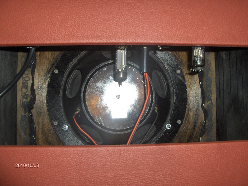

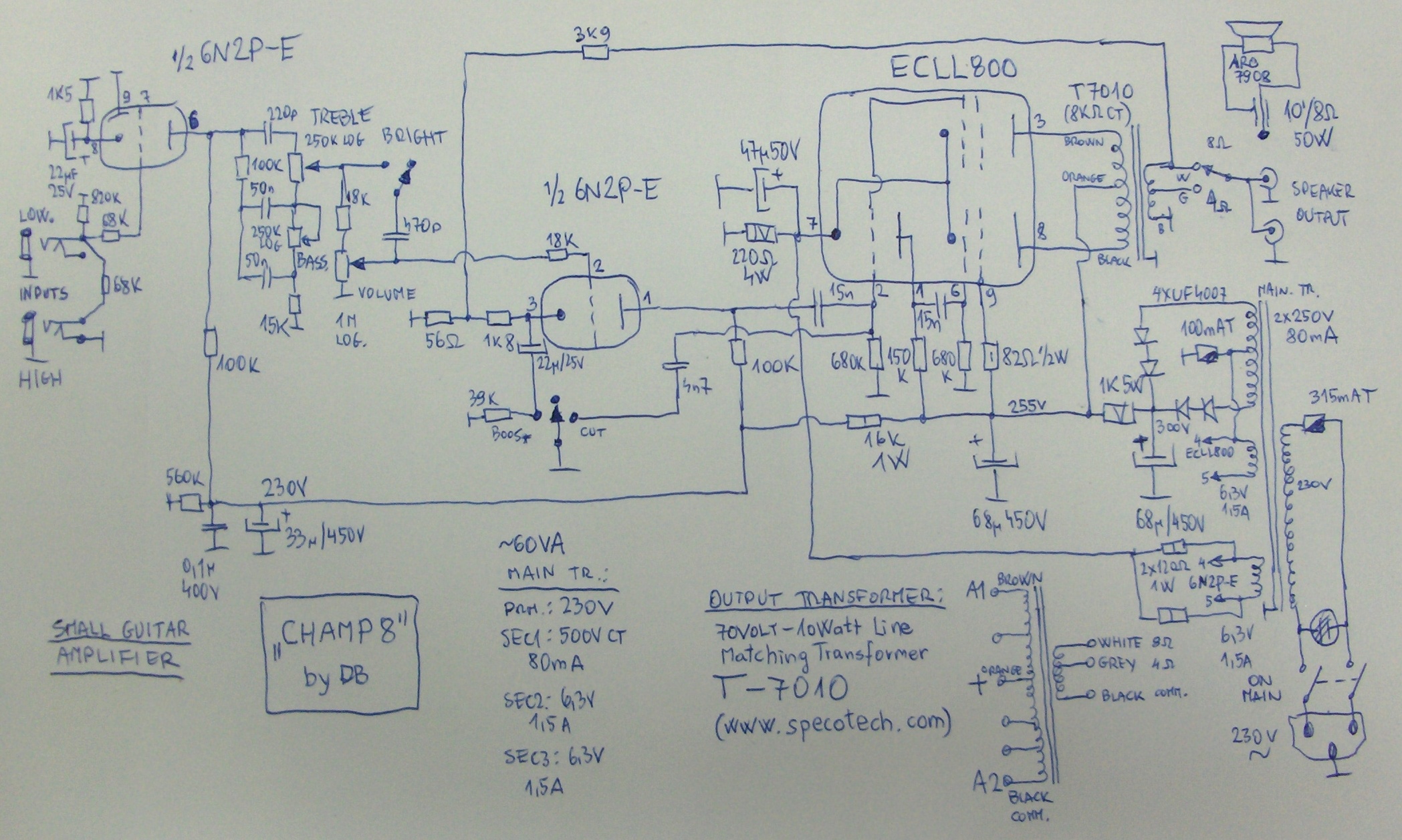

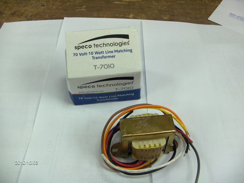

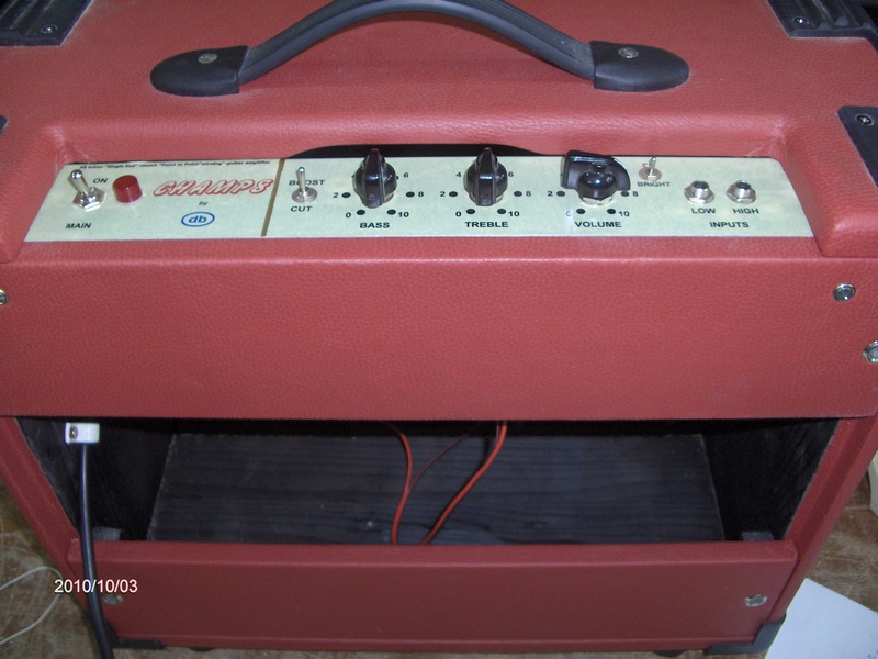

D davorin Member Joined 2005 2010-10-03 11:26 am #1 2010-10-03 11:26 am #1 Home guitar combo with ECLL800, 6N2P-E, main transformer from old tube radio, and speaker 100V/70V line match transformer as an output push-pull transformer. Attachments 014a.jpg 912.8 KB · Views: 196 017a.jpg 295.1 KB · Views: 176 010a.jpg 356.6 KB · Views: 153 D davorin Member Joined 2005 2010-10-03 12:23 pm #2 2010-10-03 12:23 pm #2 Front and back look... Attachments 008a.jpg 295.6 KB · Views: 97 007a.jpg 307.1 KB · Views: 103 Status Not open for further replies.
