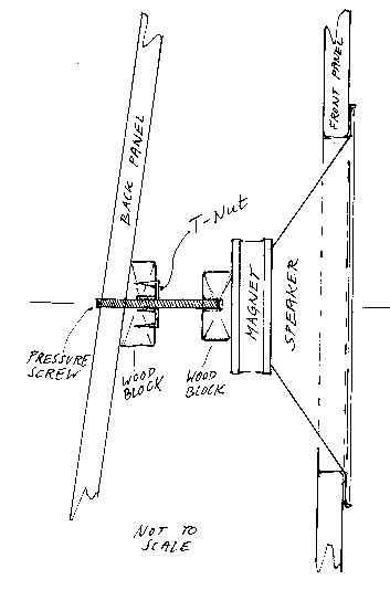

That looks similar to the old KEF reference 102s, with a threaded rod holding in the LF driver from the rear.
