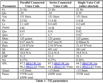

jag said:How do you model a dual voice coil driver (example: Shiva) in WinISD?
I think Adire -- in the Shiva white paper -- lays out the parameters of the driver wired in various configurations, so you can just pick a config and plug it in.

The shiva white paper does show T/S parameters for series/parallel connections. The only parameter that changes is the impedance, everything else remains same - which does make sense, but good to confirm that. The Qms is different for 'one shorted coil' config since the coil is now a brake. I am sorry, I do not want to take this thread in tangent to the original topic and will not make any more posts on this (DVC) topic.

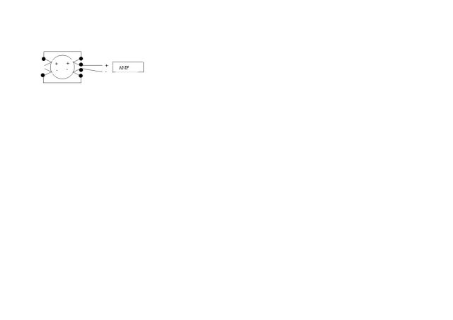

I connected the driver in parallel (refer attached)

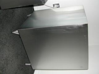

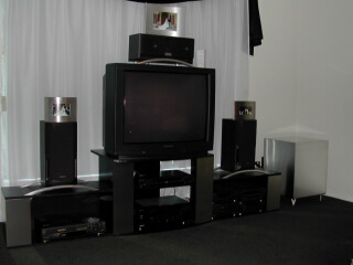

Some pics!!
Here are some pics of my Silver Shiva!
The end result:
Shiva 12 inch drvier wired in parallel
JayCar 150w (4ohm) amplifier
Box size: 60 Litres + stuffing (Q just under 0.7)
Cost: About AUD$615
Owner? Although over budget I am extremely happy with the result. You cannot beat this for value for money. A succesful DIY project!🙂
Thanks again guys for all your help.
See you again when I want to go bigger and louder!!😀

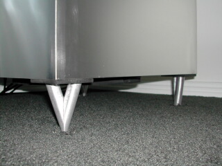

The sides are finished with Aluminium sheets (I wanted stainless steel but there was spare sheets at work so i got them instead)
The feet are actually the ends of two oven handles (again from work) which i cut at the right length, stuck them together with araldite, fixed 3mm wood at the end, screwed the wood to the legs, then screwed the wood to the sub. Turned out alright, i had to put some extra carpet underneath cause the legs are pretty sharp!!
