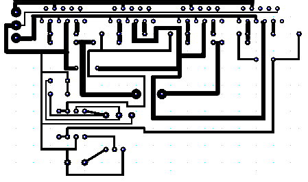

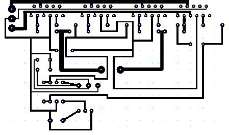

Hi, I just thought that you should probably know that your board may need some small alterartions, as if you do go for this design, you will be getting peak currents of over five amps flowing in the circuit, and at the momnet the power tracks are just way too thin to handle that. So, you may want to beef up the tracks you are using for the power lines, output and ground so that they can handle the current you want to put down them. (I would sujest about 0.1 to 0.15 inch for 1 ounce copper board).
As far as the resistors go, for all apart from the output ones, just use standard 1% metal films that you can pick up from radio shack or something seen as this is your first attempt, as you can always change them out at a later date. And as for the output resistors, you will need at least 5W or so rating on them, so I would just go for 5% wire wound ones of rnow too.
Heres the revised pcb. I did the original in a trial software program, so it wouldn't let me save and I had to use print screen and paint to save it. So, I had to edit it in paint. Not all the connections are done. Does the + input need a thick wire connecting to ground? I couldn't fit a larger one than I have now. Is the new thickness of the + - and speaker wires thick enough (gnd isn't done and nor is the connections to the otuput resistors)?
What you have done is a fair improvement, but it looks like you still have the output resistors as 1/4W sizes, and if you use these you will probably blow them up if you turn the volume up much, so they realy do need to be replaced with higher power ones.

Well, I would like to stick with what I have. I have finished the trace size increases. You did say something about driving lower than 8-ohm speakers and using 6 chips. My speaker is a 4-ohm, will it not work well? Also, I wouldn't use 1/4W resistors. I would use larger ones but just mount them sticking up off the board. I also don't like double sided. I tried one before, on a headphone amp, and yes it worked, but half the parts I had to mount like surface mount because the drilled hole went through two traces.

Thanks. Actually, I wasn't complaining about 300W, just from the way that post was worded, it sounded like it wouldn't run stable into 4-ohm. Basically, I just wanted to know how my board would work. I know I didin't connect the mute pin yet, but is the rest ok?
I guess so there is notthing glaringly obvious wrong, but it's a little hard to tell just from the drawing.
I do know that you have to conect the mute pin up in a certin way on the LM3668 (even if you aren't using the mute) or else it won't work properly.
Yes, I know I didn't have room to attach the mute pin. It won't have a mute switch, so all I do is tie the pins together and connect to ground through 1 resistor, right? Or do I need a resistor for each output?

You must connect mute pins to -V and draw 0,5mA from each mute pin to switch mute off.
Whoops, my mistake. I did mean to type vee not ground. Does each chip have to have it's own resistor for the connection, or can I connect the 4 pins together and use 1 resistor?
I think it would be best to use individual resistors for each chip, in case the voltage at the pin on each chip isn't quite the same.
