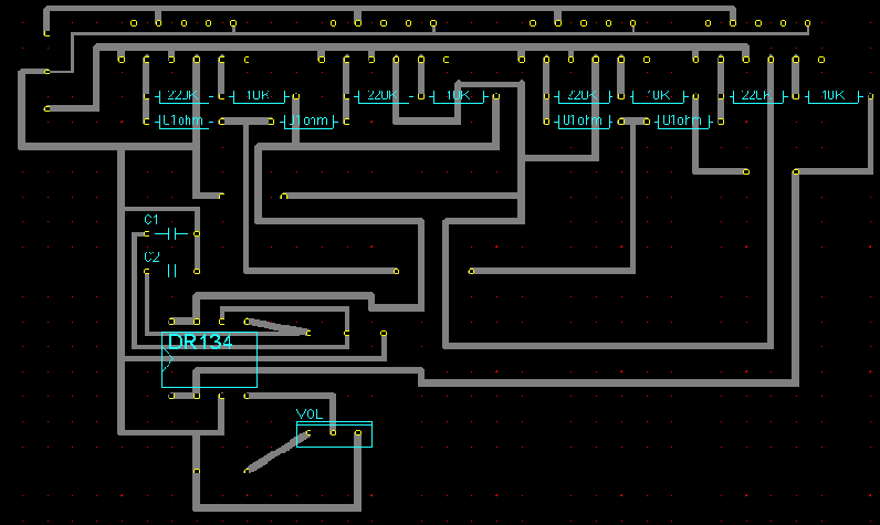

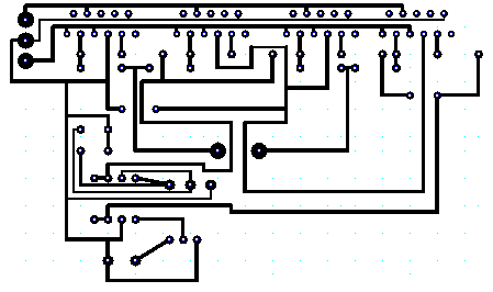

Also, I designed a PCB layout. It is on the other computer, so I will post it tonight. Hopefully it will work.
PCB for LM3886
