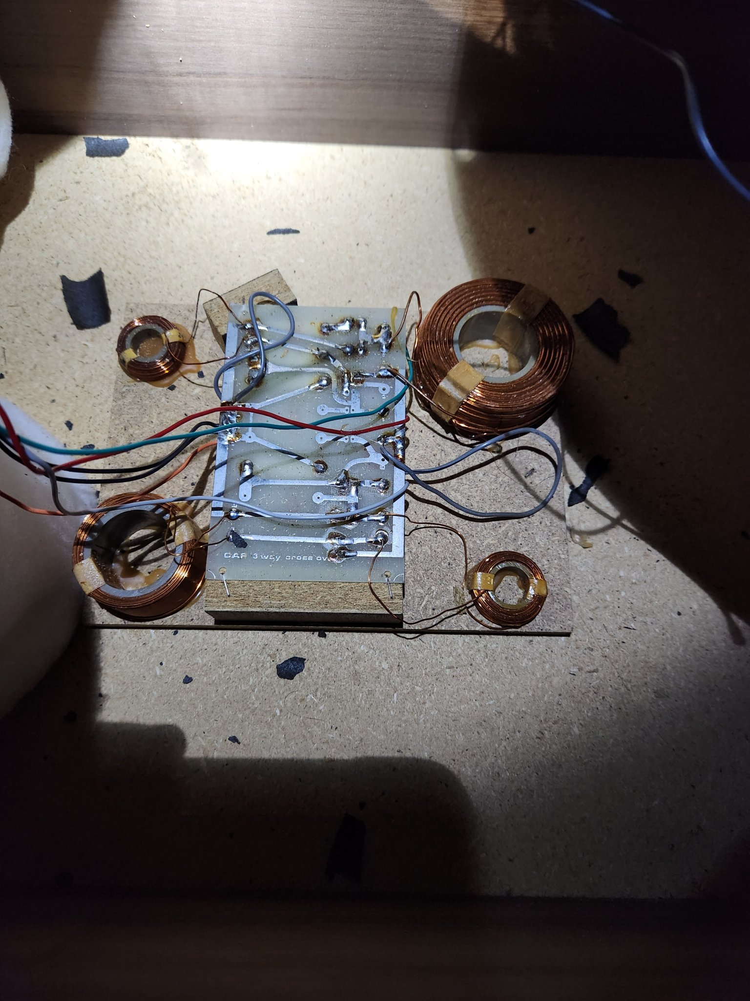

If as described you could turn the 4-way into a 2-way and only use the bass driver. The XO is usually the hardest part and a 4-way is far from trivial. Biamp and it would be breeze.

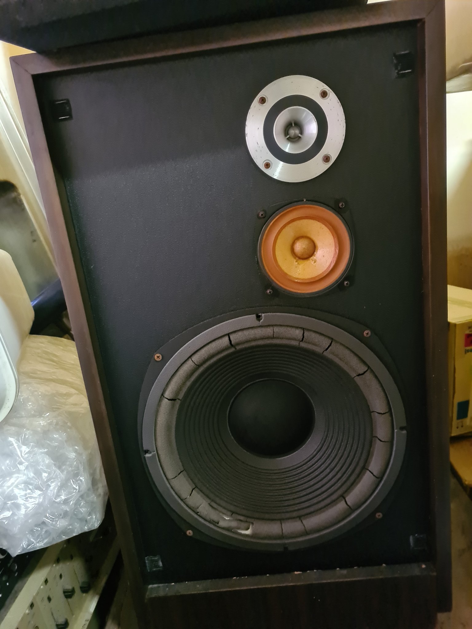

My Chadwick speakers are three way compact enclosures built from 16mm 5/8" particle board with vinyl wood grain wrap. The speaker cabinets were found to be in poor condition. The cabinets are badged and labelled Chadwick Home Furnishings, Chatswood NSW, The damaged mid range drivers were replaced with new to the original specification by a speaker workshop, much to the dismay of the technician. I mean, why would you? The 12" drivers are Eminence USA, the mid range sealed drivers are 4" paper cone and the tweeter is paper cone high end of UK make. When connected to a high current 120W RMS stereo integrated amplifier, the bass drivers are good, the tweeters are surprisingly exciting at times but the mid range is poor. The technician explained that the bass driver was absorbing all the power, the amplifier would be stressed at volume and that a 200W amplifier was really needed to give the other drivers a chance. The crossovers are unknown. It is not known whether the Eminence speakers are original or not. Perhaps my speakers are the Executive 12 and not the Executive Monitor 12.

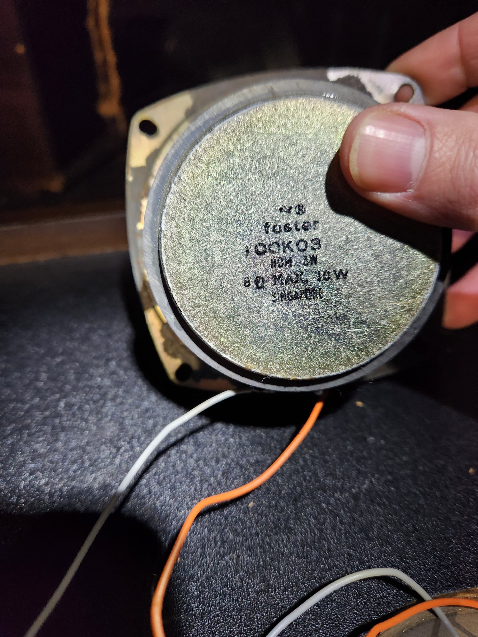

I've an old pair of the Executive 12s that i finally opened up after years in storage. The ETONE bass drivers need replacing (518 is all that is stamped), will also rebox I think as the chipboard is falling apart. Anyone have details on the mid range?
