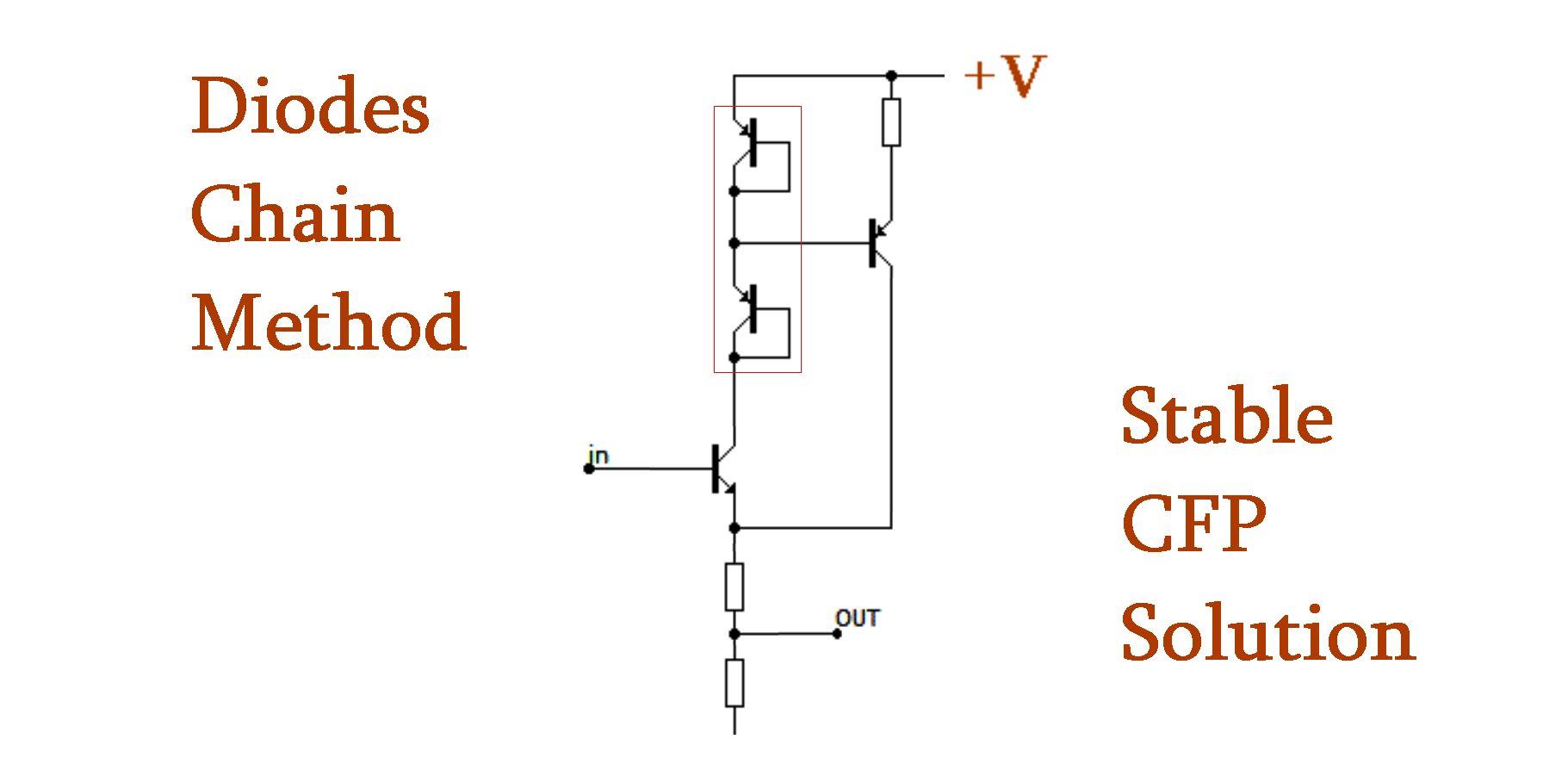

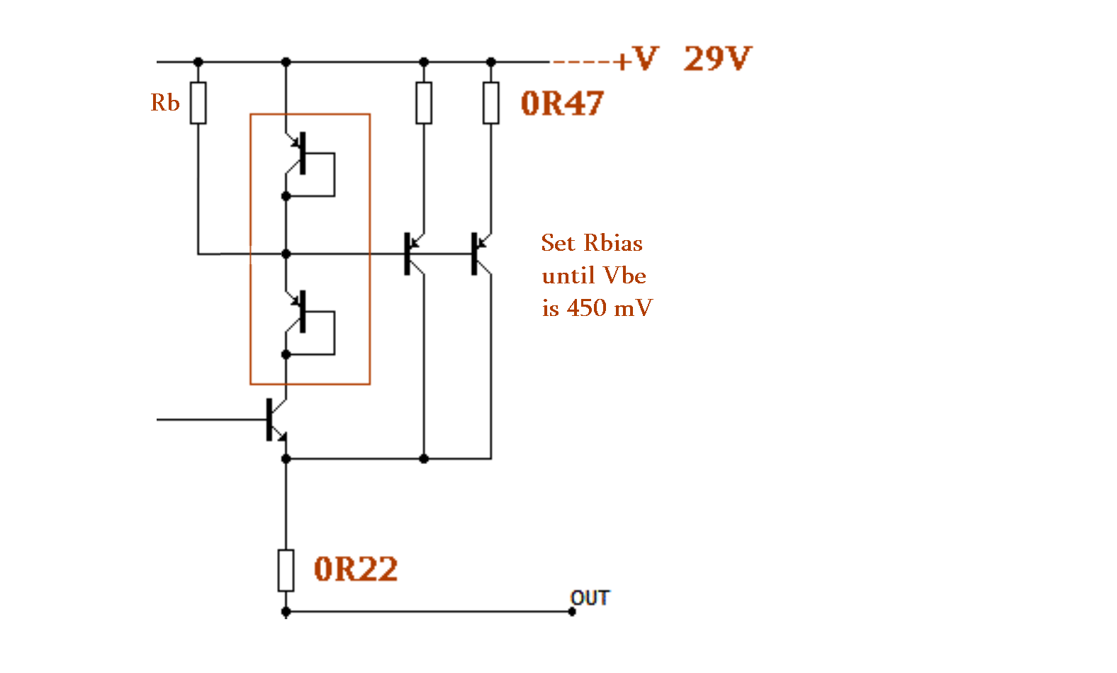

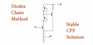

the diode chain is required in the presence of a voltage step
for example (see picture)
if the polarization is made with a resistor
it is NOT important to protect the base
but if it is polarized by a constant current source

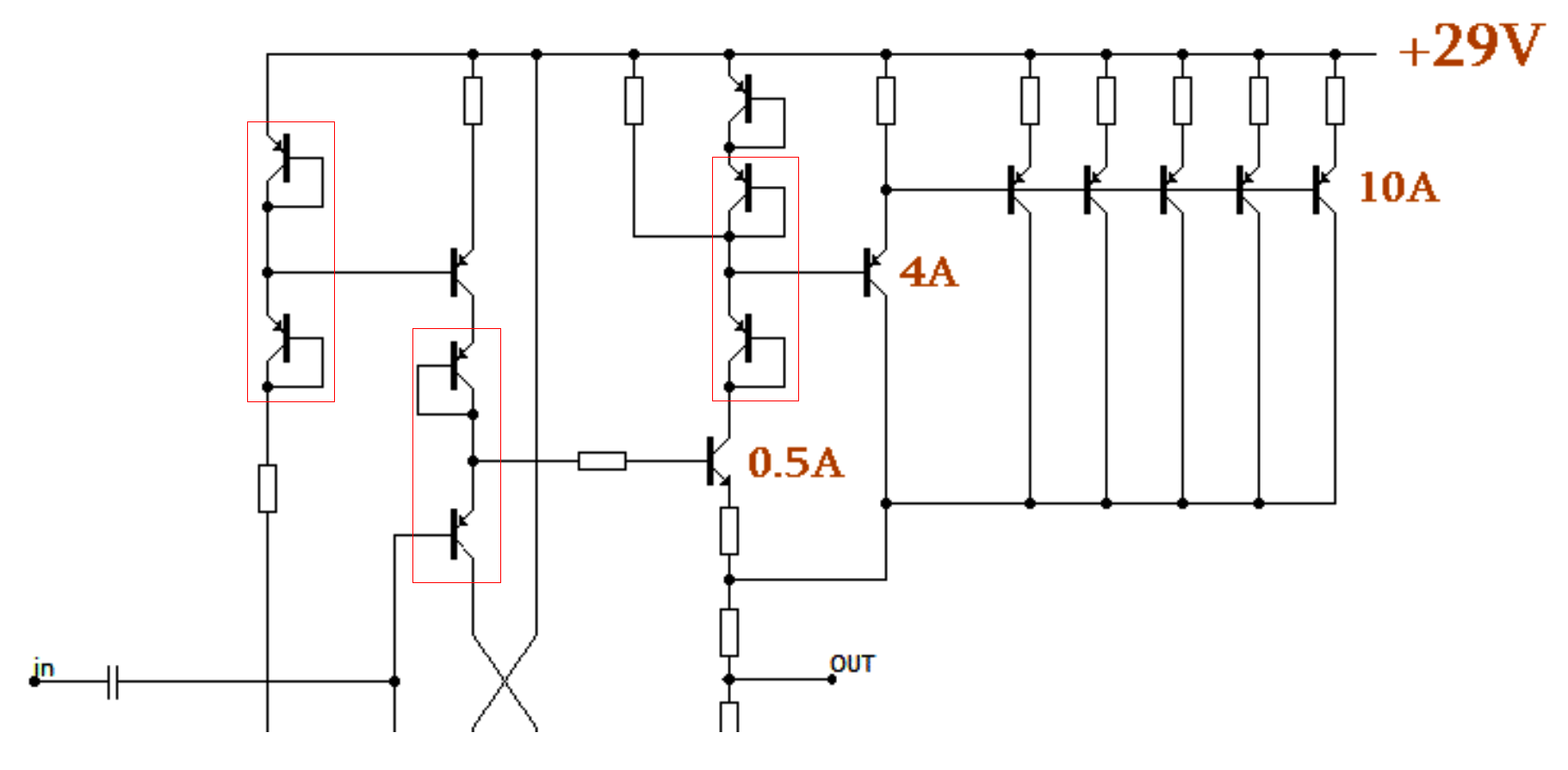

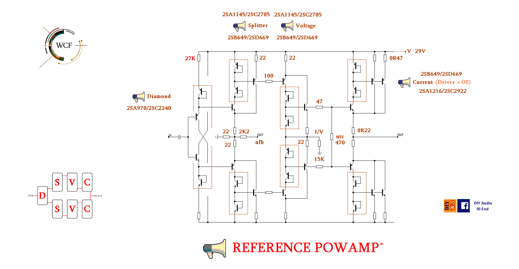

simmed the circuit from #15 with the only difference of replacing the output Transistors Q7/Q8 by the complementary 2SA1216/2SC2922 pair.
And compared it to the same circuit without the two diodes D2 and D3.
The only noteable and expectable difference was the roundabout 0.6V voltage drop over D2 and D3.
Amplitude response, THD level and spectrum and noise are virtually identical.
Rather the circuit without the diodes beeing ahead by a Yota.
Response to a rectangle signal is rather defined by the value of the compensation caps C1 and C2.
Removing the Caps C1 and C2 leads to damped ringing, but again both circuits behaving identical.
The absence of D2 and D3 doesn´t change anything.
So far none of he claims could be verified in simulation.
And so far no sensible technical explanation has been provided.
As long as not someone steps up with a sensible explanation, to me the "diode chain" looks like ´Money for nothing´.
