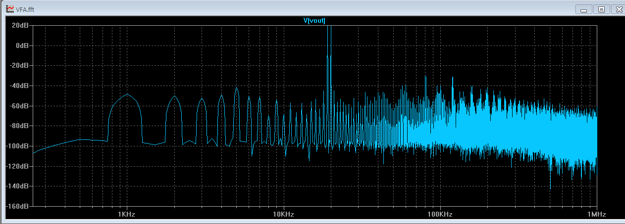

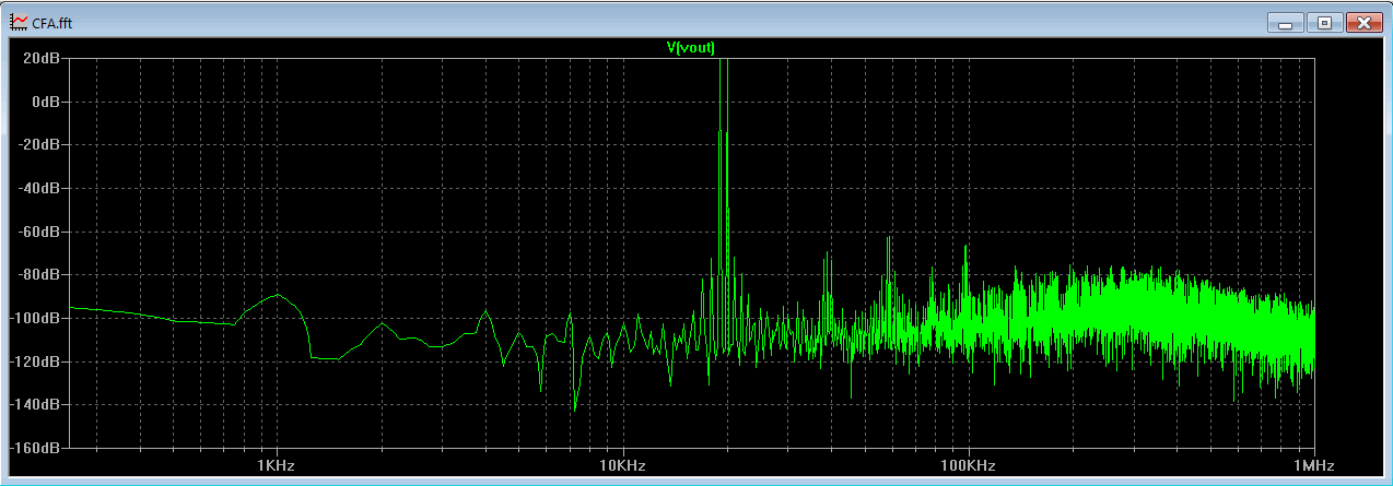

Please, can somebody good in LTSPICE verify this ? I did-it twice, but i don't believe in what i see.
It is .four 1k, FFT of 19+20Khz at 0.6V input each. Start time 1mS, stop time 5mS.
In green CFA, in blue VFA.

I'm not quite sure what drives these differences. I decided to try the same thing (10kHz + 11kHz large signal swing) with my SKA GB150 file and compared the VFA with CFA version - it appears in this case that the CFA version came out worse, but I wasn't unhappy with either of them. Maybe the details of the spice simulation settings are important, the number of cycles in the FFT or it depends on whether you do 10 +11 or 11 + 10 etc. - somebody more knowledgeable than me will be needed.
Bear in mind that I'm not trying to peel back the onion on this CFA vs VFA thing, the two versions I'm playing with are both designed to be practical solutions, so not everything is held identical. I've found that the idle current is more important than whether I use CFA or VFA 😉

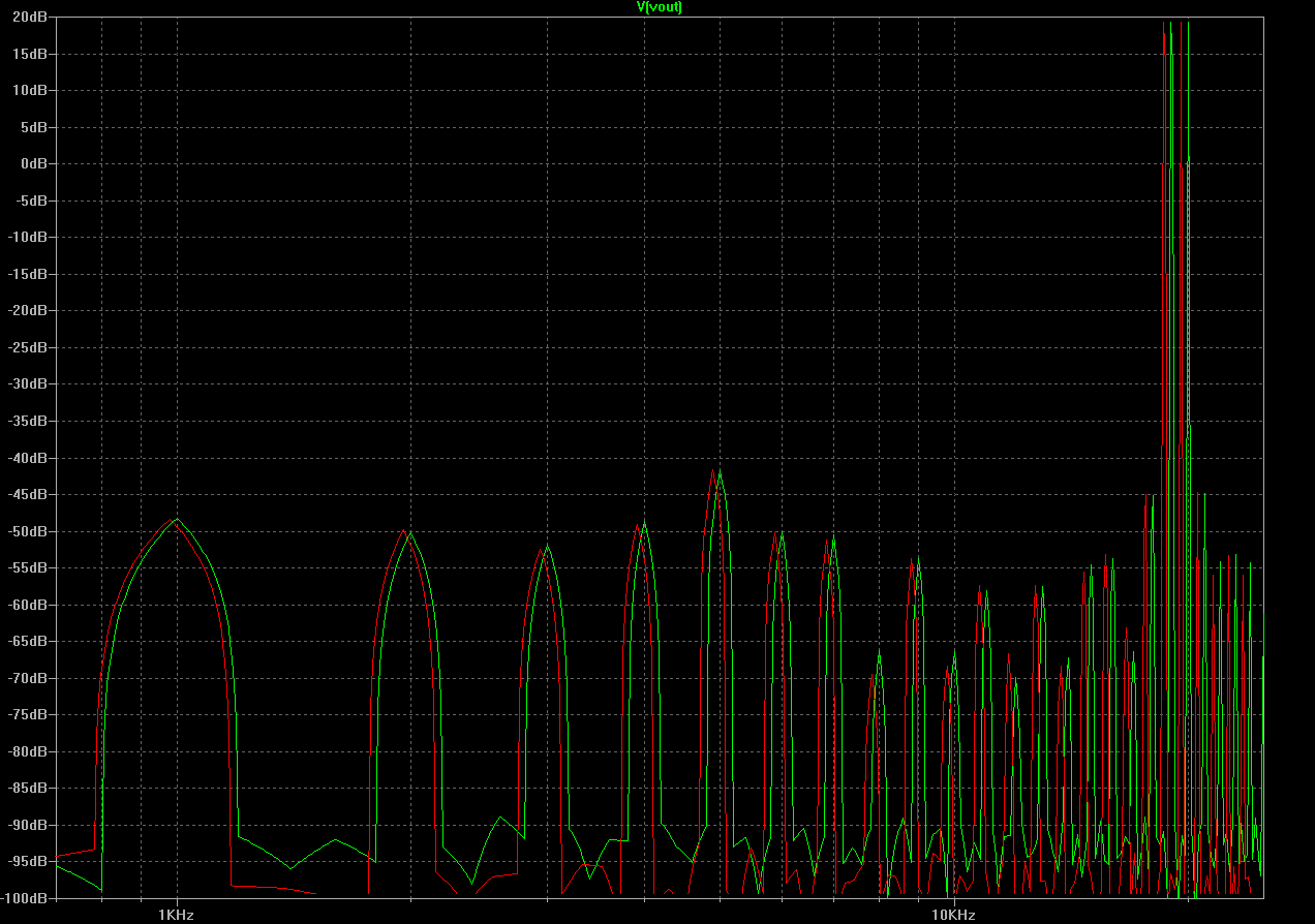

I did this IMD comparison again this morning...
It was an other bug in LTspice*... (less and less fear in fairy tails simulators)
Got more consistent results (see attached, juxtaposed images with a little horizontal offset to can read both)
Green is CFA, red is VFA.
Conclusion: Nothing really different between them...
* I had generators in PS rails to simulate ripples. They were both to 0V. One was at 100Hz, the other at 1MHz. Changed them both to 'none', shorting them, and it changes everything.

That matches my general results too from looking at the SKA amplifier.
I suspect that for resistive loads, providing the OLG / CLG profiles between CFA and VFA are matched there isn't going to be much to choose between them regarding distortion.
I don't think there is going to be much of a difference between CFA and VFA in any significant way that affects the performance of a well designed amplifier for audio applications.
However, when the feedback factors are low enough that the accuracy and I-V curve of the error amplifier become relevant there may be some important differences (dynamic performance, TIM etc.).
