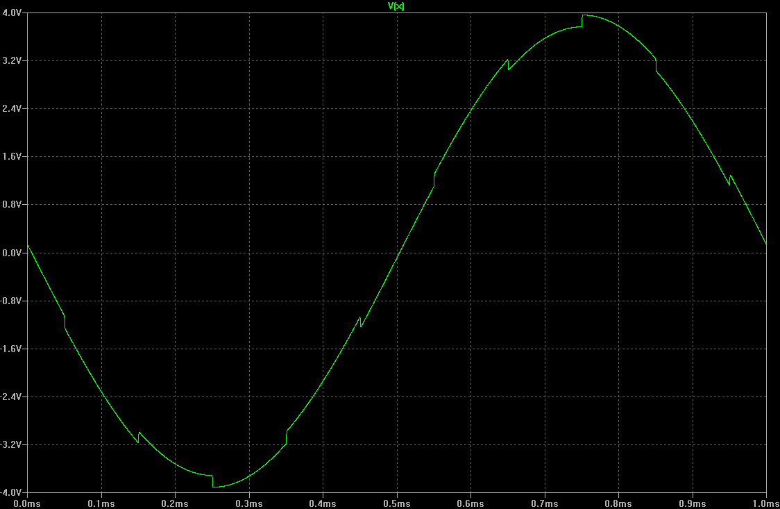

You mean something like this? The picture shows a 1KHz sine with a 5KHz square imposed. The sine equals about 1W into 8R, the square/sine ratio I set to get ~100mV squares as you say.
This is with a 12dB/Oct 730KHz input filter though. When omitting the input filter, it goes into slew with a slight overshoot of about one cycle of ringing (up peak, much smaller down peak, settled, ring period approx 2MHz).
Yeah, something like that. The additional sine wave also reveals changes in step response that occur at different levels.

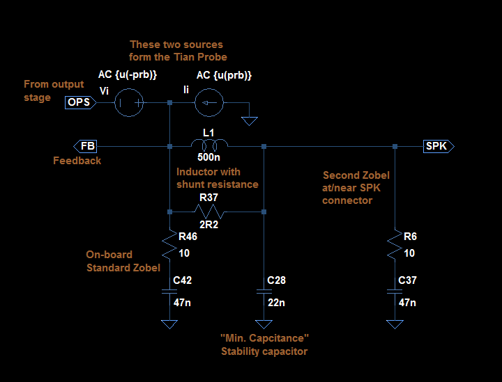

Are you referring to the series R-L network as a "Thiele" network. Not sure I've seen this before, and not sure it is appropriate. I am very familiar with Thiele's work that he did on the topic, but the series netwrok consisting of parallel R and L had been around long before that work. Thiel's was a specific approach to output networks that happened to include a series R-L netwrok.
Am I wrong about this?
Bob
Here is an example of a "complete" output network. I've also added the Tian Probe to show how it's connected.
Yes, excellent. One further point. I sometimes recommend a "distributed" on-board Zobel consisting of several smaller Zobels close to each output pair when multi-pair output stages are used. This enables the use of smaller Zobel components and non-inductive metal-oxide or metal-film resistors. Fast output transistors like to have the Zobels close-by. This approach does not necessarily take up much more PCB space.
Bob

My question is, how do you optimize the values of each of the components in that diagram? With such a complex output filter there are so many variables, how do we know if it's optimal?

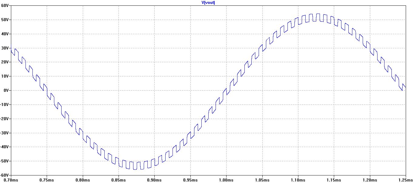

Here is 2kHz sin at almost full power and 20kHz square +-100mV from my lateral MOSFET 200W amp.
That's a sexy curve! Nice, clean and smooth. There was once a guy on this forum who tried to draw correlations between electrical attributes and sonic qualities. Anybody know how to get in touch with him?

Hi dadod 🙂 When I look at the graph, the squares seem to have peak-to-peak value of about 5V instead of .2? Also, is that without input filter?I think that 100Hz sin and 20kHz square is to extreme, it takes to long to run simulation.
